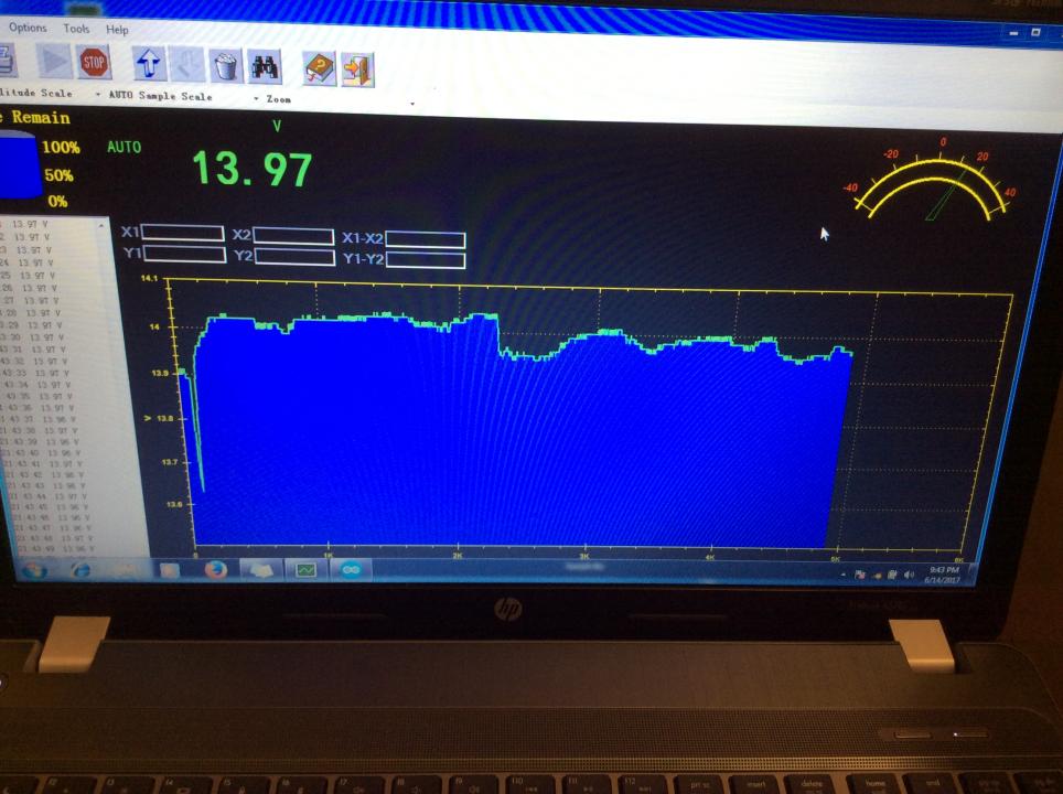

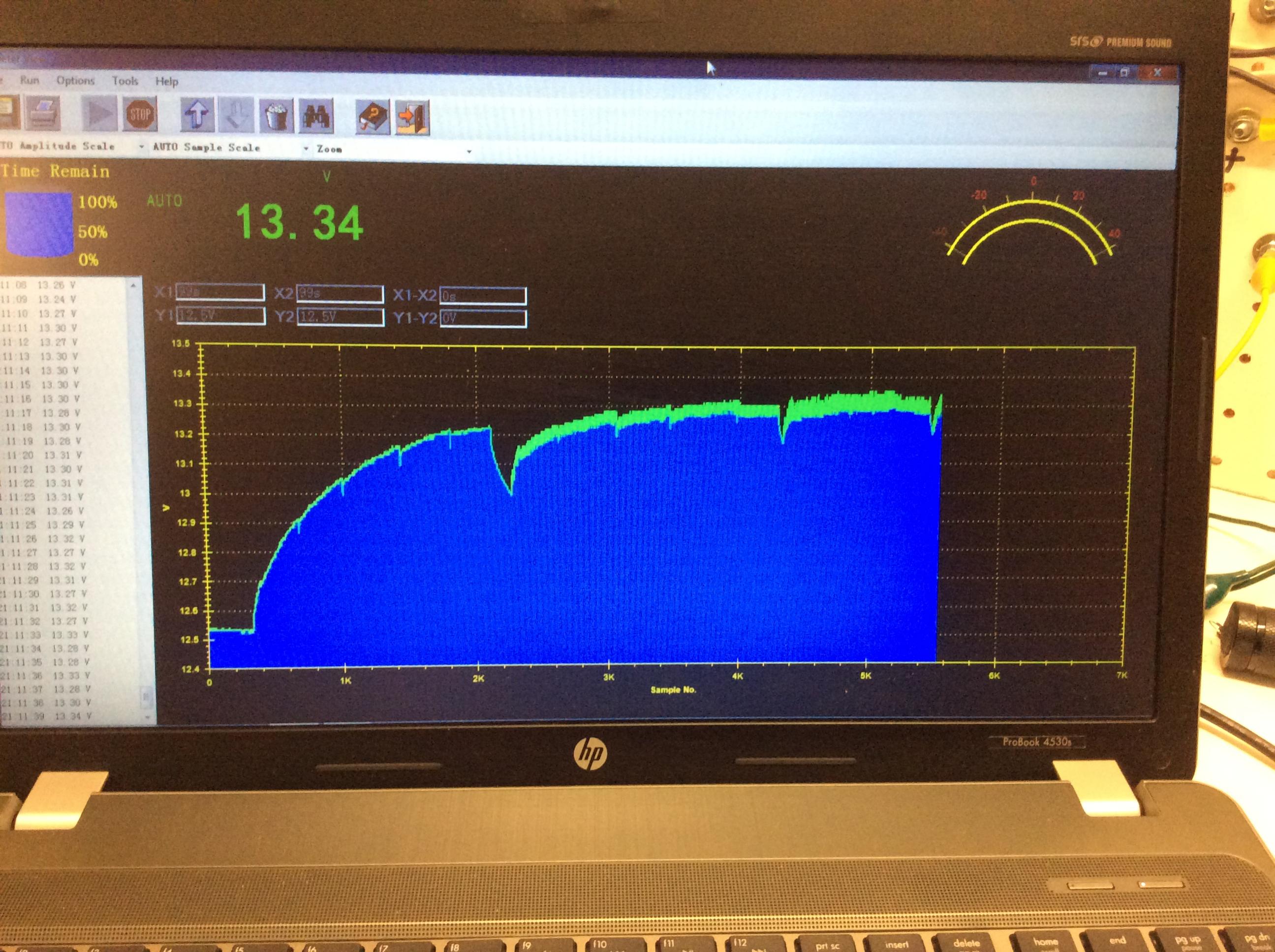

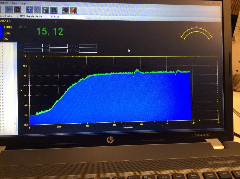

I got the cap dumper finished tonight, it consists of 2 470 uf and 4 4700 uf capacitors ( all 100 volt), 4 switches, a solid state relay, and an arduino. It is basically configured like the one Bob showed earlier in the thread. Thanks Bob.
The picture is of my test run, making sure it works.
The big drops are when i changed the off time, the smaller down spikes are when i would take a capacitor out of the mix.
Overall, I am very pleased, it needs some tuning but that just involves some time.
The battery started at 12.54 and stopped at 13.34 in about a 2 hour test run.
