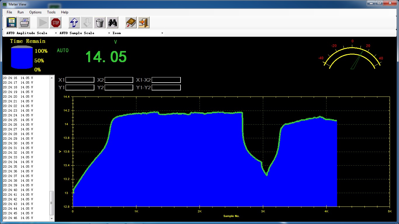

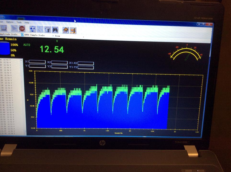

Had time for a quick check on the charging process, so I drained the battery down to 12.80 and put it on charge again at a slightly higher frequency 245.7hz for about an hour then I returned it to the lower frequency for the night. The coil hummed at the higher frequency but it didn't heat up. The chart below shows the charge and then the reducing the frequency and the start of another cycle. My meter keeps losing connection to the software. The battery doesn't seem to climb above 14.08 without the higher frequency. When I get time I want to try the cap pulser and the solid state charger to see if I can push it higher, it probably is still desulphating.
