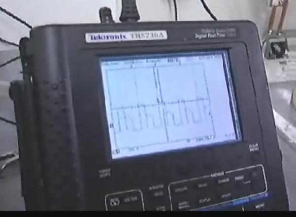

        Patrick

          I'll get back to you on the EFV reference once I watch 33 and 34 again, might watch them this weekend. Can you elaborate on the scope shot you posted, I'm not sure what I'm looking at (but looks like 2 H waves??)

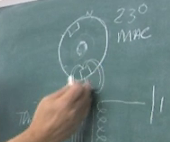

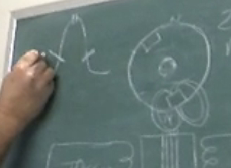

                at about 8:50 running in attraction master class DVD 24
                same dvd at about 14:40
                This is the spot, he never calls it a sweet spot so as I mentioned earlier I might be confusing the terminology. This is what we are tuning for which to me is sweet
