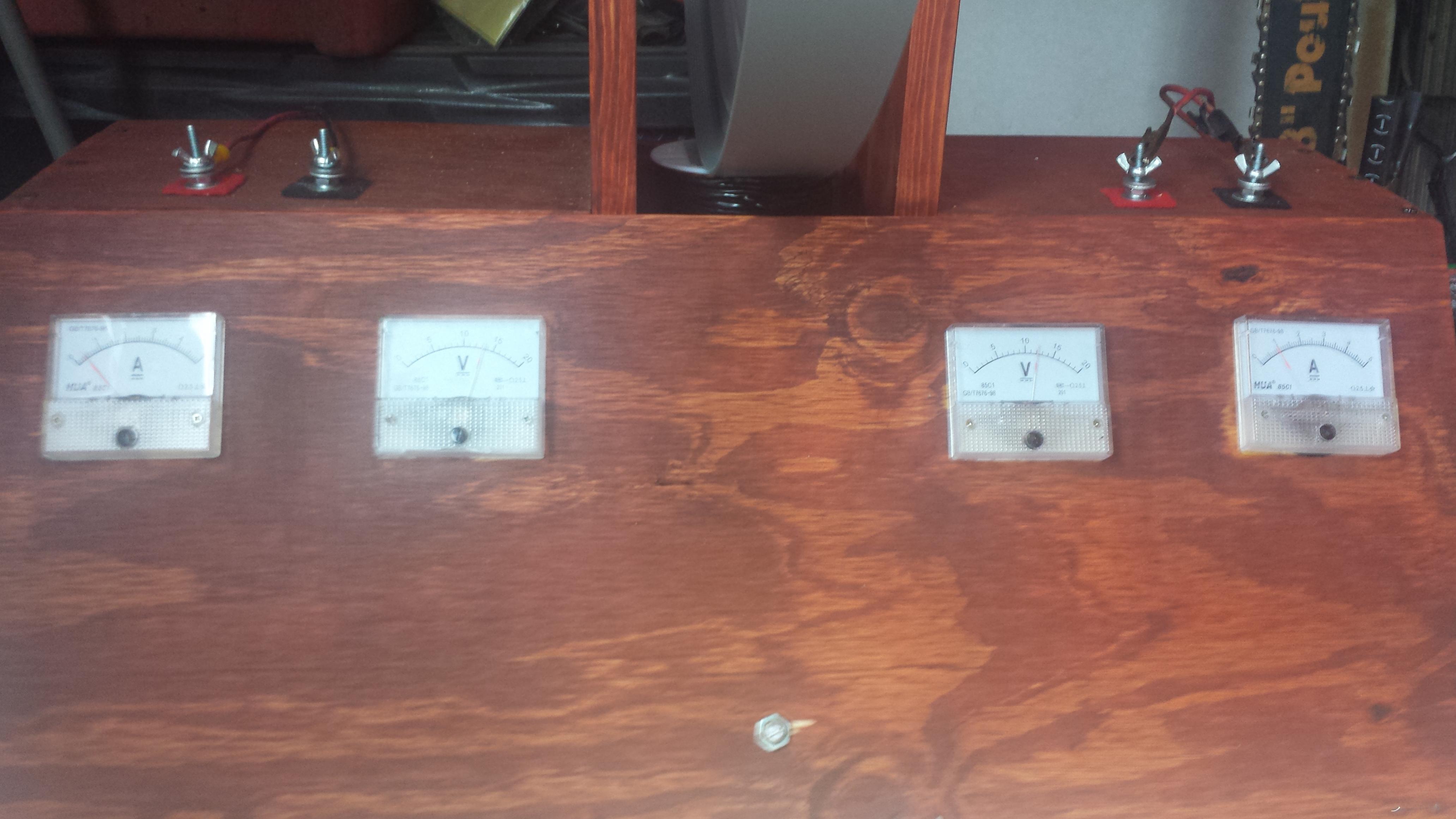

One thing Im noting right off the bat... When I have 12 volts input, the current draw is more than the output current draw. However, when I run it using 24 volts on the input side, I get at least half as much MORE current on the output than the current draw on the input side. Why is that?
when using 12 voltsinput, its drawing roughly 1 amp and output is drawing roughly half an amp.
when using 24 volts input, its drawing roughly 2 and a half amps, and output is drawing over 3 amps.
in either case, its charging a 12 volt battery...
I don't get it???
I don't get it???
On my machine the o-scope shows voltage spikes across the transistor between 30 and 40 volts above the battery voltage. This is what charges the battery. Voltage spikes, not current. You won't even see this on a digital volt meter - only on an o-scope. It's not a good idea to hook any volt meters or ammeters to the charge battery, as they absorb some of the spike and reduce the charging effect.
