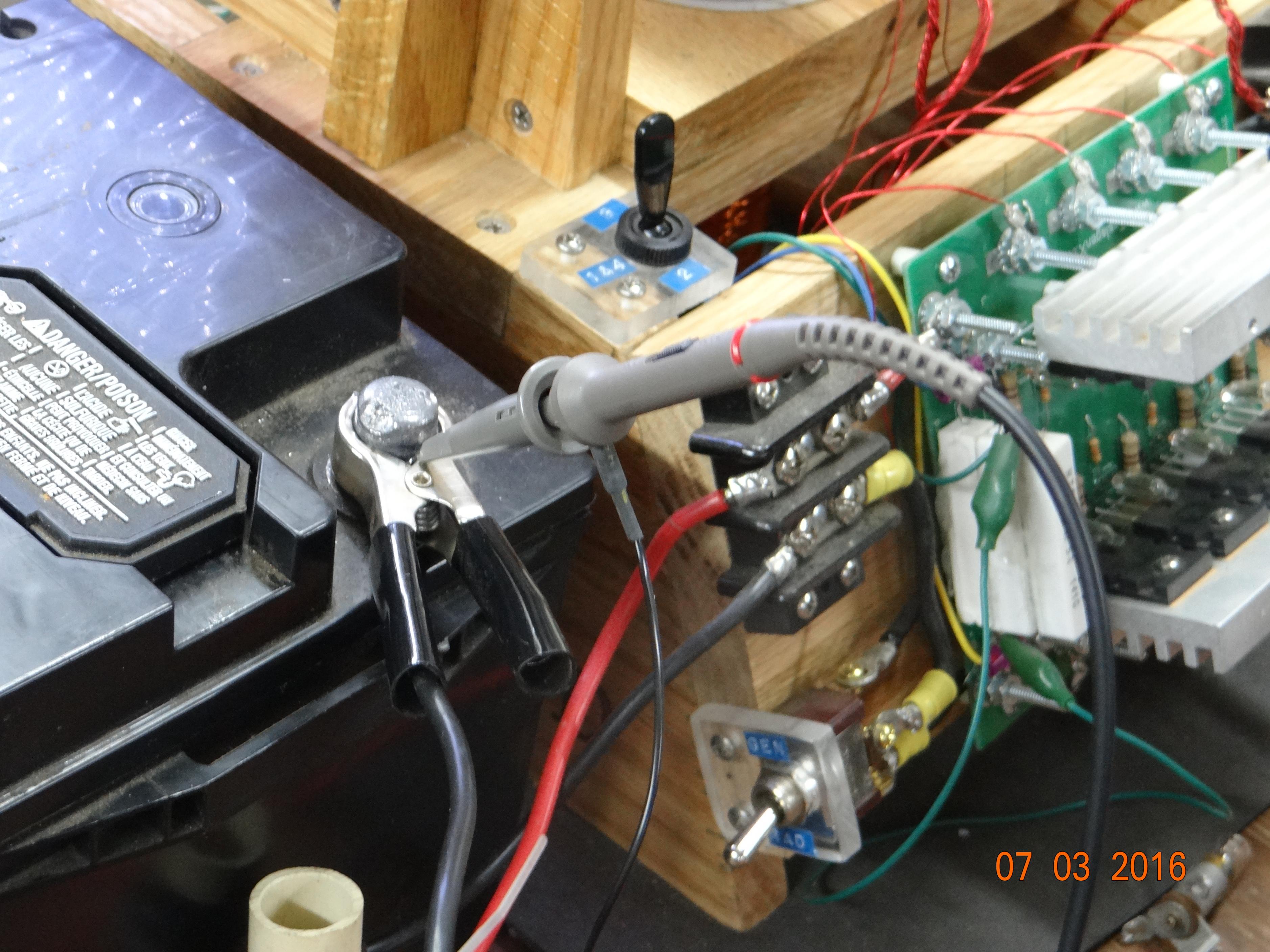

Hi Guys,

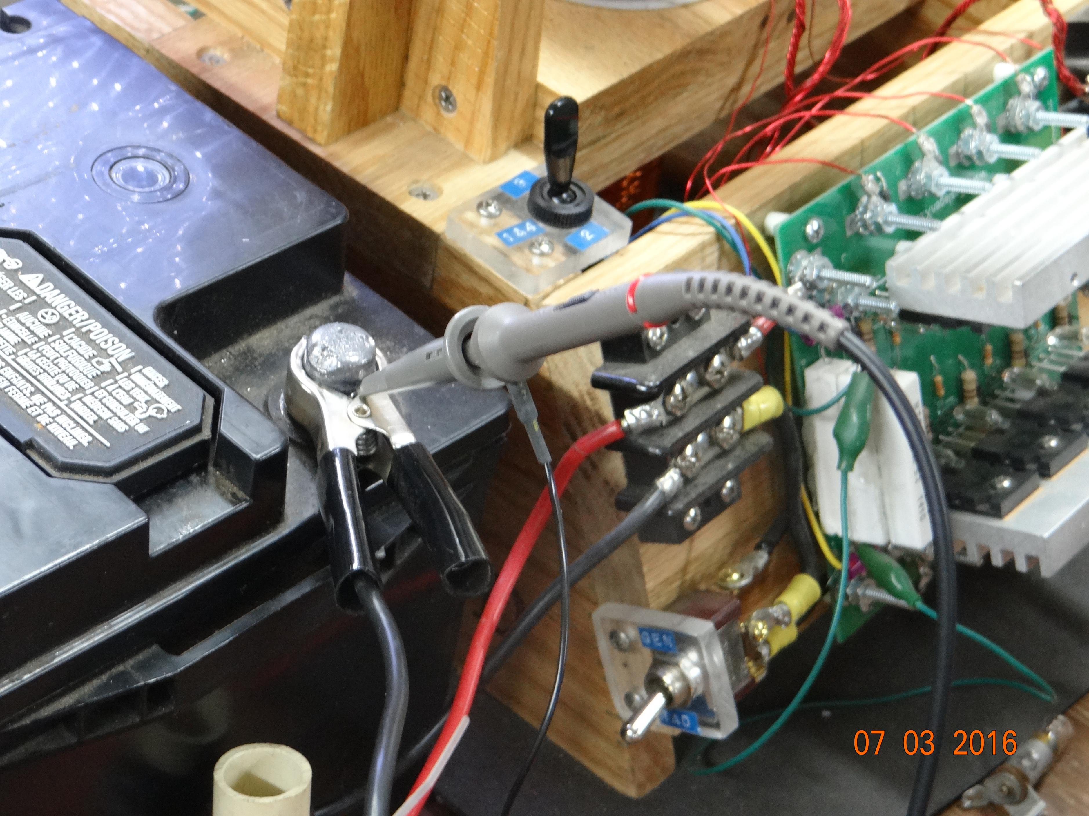

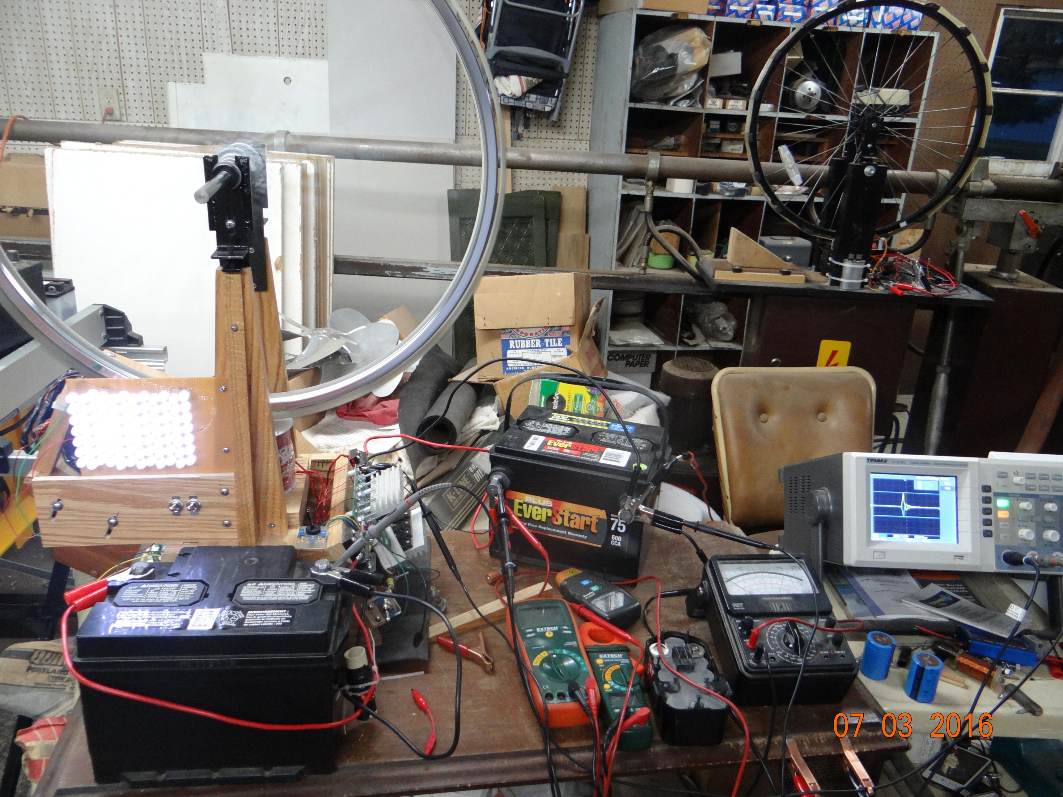

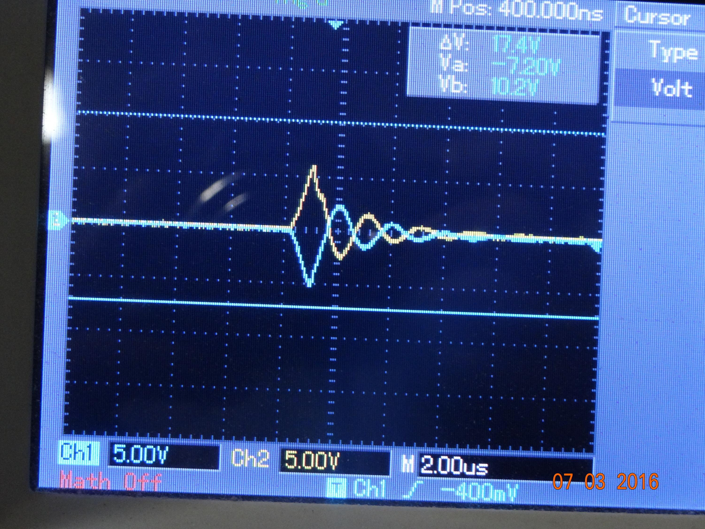

As I write this my SSG is running about 300RPM in radiant mode from one 35AH automotive battery and charging a 40AH battery while also lighting 84 LEDs from genny coils. Just out of curiosity, I hooked my o-scope up with the channel 1 probe hooked to the positive post of the run battery, and the channel 2 probe hooked to the negative post of the charge battery. The ground lead of the o-scope is hooked to the 3-way junction of the 7 power coil leads, the run battery positive cable, and the charge battery negative cable. This allows me to see the instantaneous voltage drop across each cable as its running. I also checked the "steady state" voltage drop across the same places with a digital VOM. All the leads are #10 stranded wire.

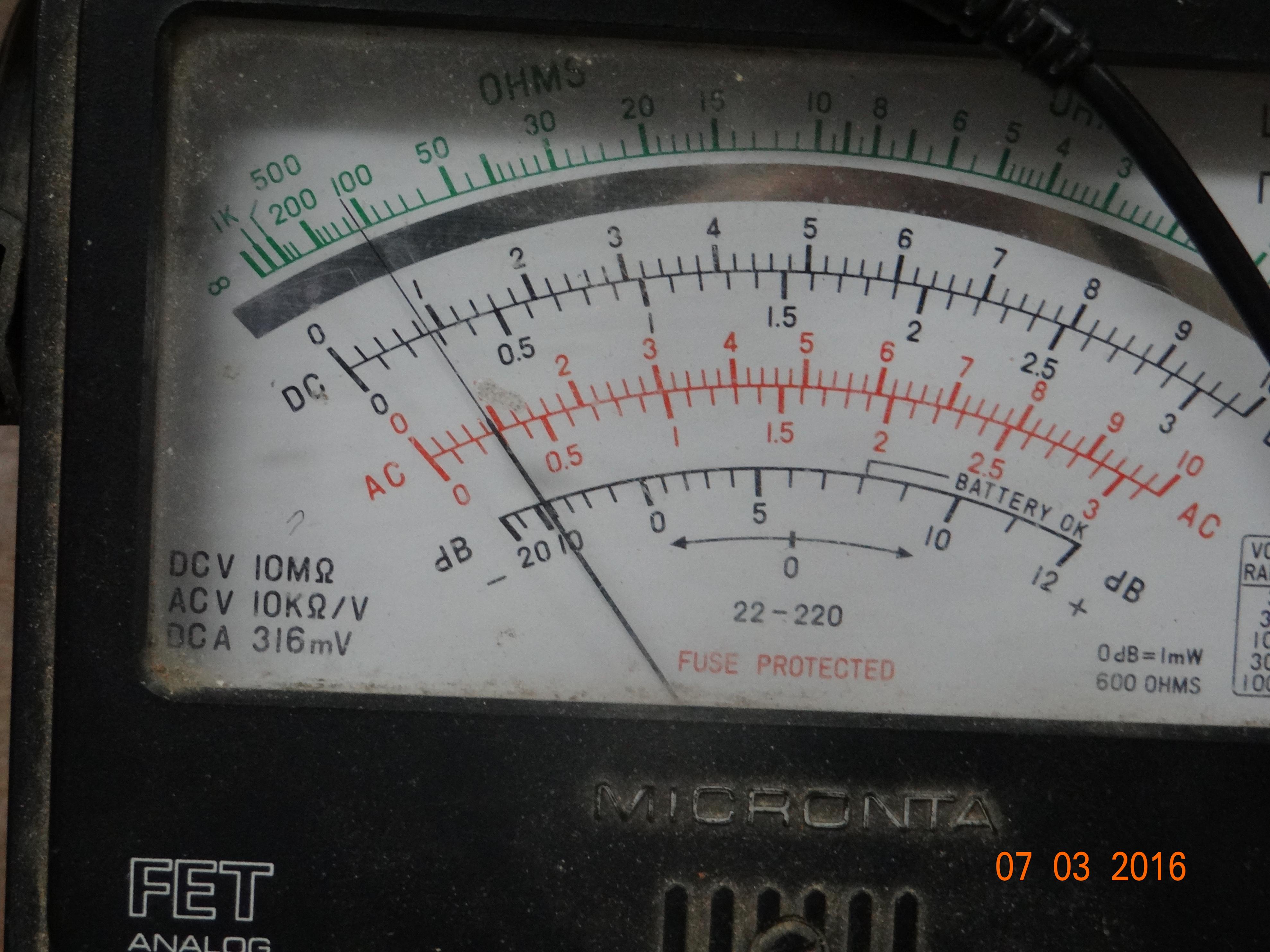

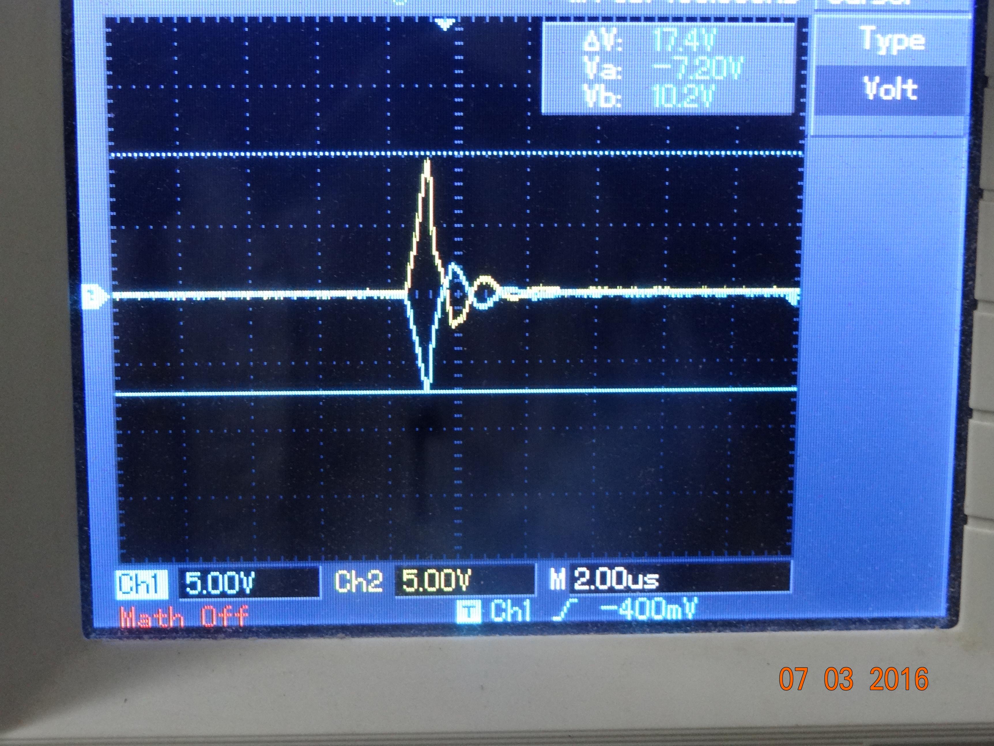

What I found was very interesting! The o-scope shows a positive voltage spike across the negative charge battery lead of +10.2 volts and -7.2 volts across the positive run battery lead. The VOM shows a +4.5 mv drop across the negative charge battery lead and a +5.0 mv drop across the positive run battery lead. When the analog ammeter is momentarily switched into the negative run battery lead it reads about .9 amps, and causes the voltage spikes on the scope to drop to 6 volts on the charge battery negative lead and -6 volts on the positive run battery lead.
The voltage spikes must be the radiant pulse going both ways from the top of the coils attempting to charge the run battery as well as the charge battery. The spike shown on the run battery is in opposition to the measured current flow just like John always said. And the spike measures much higher voltage than what the VOM shows and is opposite polarity on the run battery! The radiant is also greatly diminished with the inclusion of the ammeter in the run battery lead. You can also detect a change in sound pitch of the machine when the ammeter is switched in.
My conclusion is that the circuit works best without any meters, the radiant goes everywhere in the circuit, and the lower you can keep the impedance the better it works. Again, this is what John has always told us.
