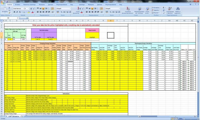

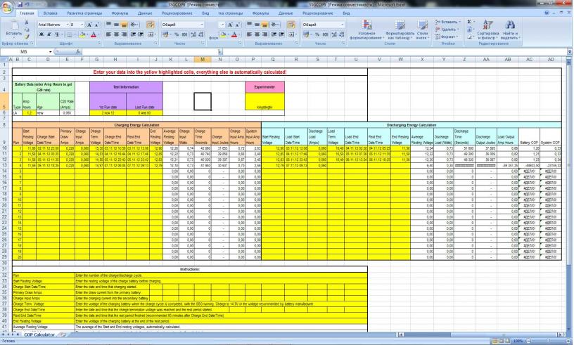

I continued to training the battery. Battery efficiency coefficient > 1, but its capacity is reduced. It must be so, or am I doing something wrong? I publish my spreadsheet for clarity. SSG COP #3_1.zip

I'm on the verge of disappointment.
I measured the current entering the rechargeable battery with an oscilloscope.
When the voltage of the power unit was 13.9 V.
Current on the oscilloscope was 0.133 A, and the multimeter indicates 0.060 A.
So all my calculations were wrong, and the efficiency was less than 1.
I had the same measurements at a voltage of 5V.
In this case, I was a complete coincidence measurements of current. Multimeter and oscilloscope showed almost the same values.
Now I powered device 10.3 V. Measurement error in this case is 20%.
I think that I have again set up wrong. But I do not know what to do.Konstantin.
Yes, this way charging works. But I do not have a large enough battery to do so. So I switched to the power supply from the power supply.Originally posted by John_Koorn View PostPlace a fully charged battery as the primary and a discharged battery as the secondary. Does the battery charge?
It is clear. But I measured the electric current flows into a second battery. And using the table from this site, get COP > 1. SSGCOP6.zipSSGCOP3.zipOriginally posted by John_Koorn View PostConventionally the machine is about 30% efficient.
In these calculations, I used a multimeter readings (0.060 A). But then, the oscilloscope measurements showed 0.133 A.
So, I charged my battery just an ordinary electric power. And the battery capacity decreases.
Now I powered device 10.3 V. The incoming electric current in the secondary battery is 0.038 A (on the oscilloscope).
And I hope that everything will be as it should.
If the voltage of the secondary battery can go up to 15.7 volts, whether to charge it to this value, or need to stop charging before?
Thanks.Konstantin.
10.3 is to low for primary voltage, you need to be above 12. 13.2 would be good.Originally posted by kingstingtin View PostYes, this way charging works. But I do not have a large enough battery to do so. So I switched to the power supply from the power supply.
It is clear. But I measured the electric current flows into a second battery. And using the table from this site, get COP > 1. [ATTACH]1095[/ATTACH][ATTACH]1096[/ATTACH][ATTACH=CONFIG]1097[/ATTACH][ATTACH=CONFIG]1098[/ATTACH]
Thanks.
