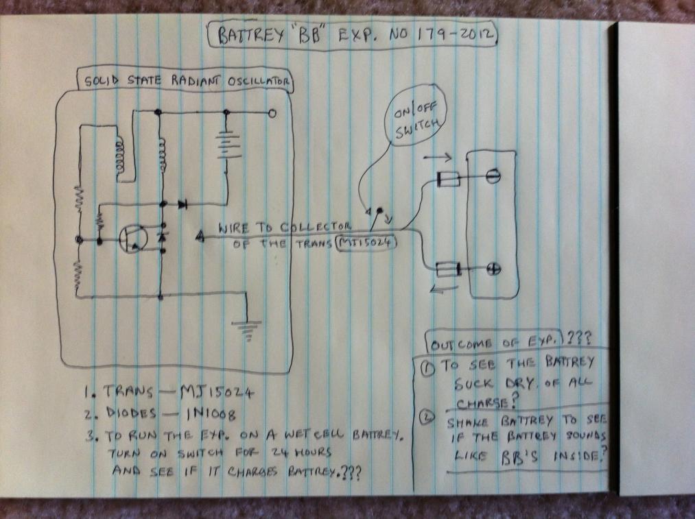

Geoffrey,
That is not how we hooked it up, No charging battery, Oscillator running on a 12 volt supply straight wire from collector, no bias resistors, Oscillator circuit is in the my posts.
History of the Radiant Oscillator. Outside of that your hookup is right.
Originally posted by geoffrey sr miller View PostHi Mr. Bedini
Here is a quick drawing of the The Wet Cell B.B. EXP. could you please take a look at it.
, and let me know what you think.
Thank You for the Video.
Have a great night.
Geoffrey
[ATTACH=CONFIG]533[/ATTACH]John Bedini
