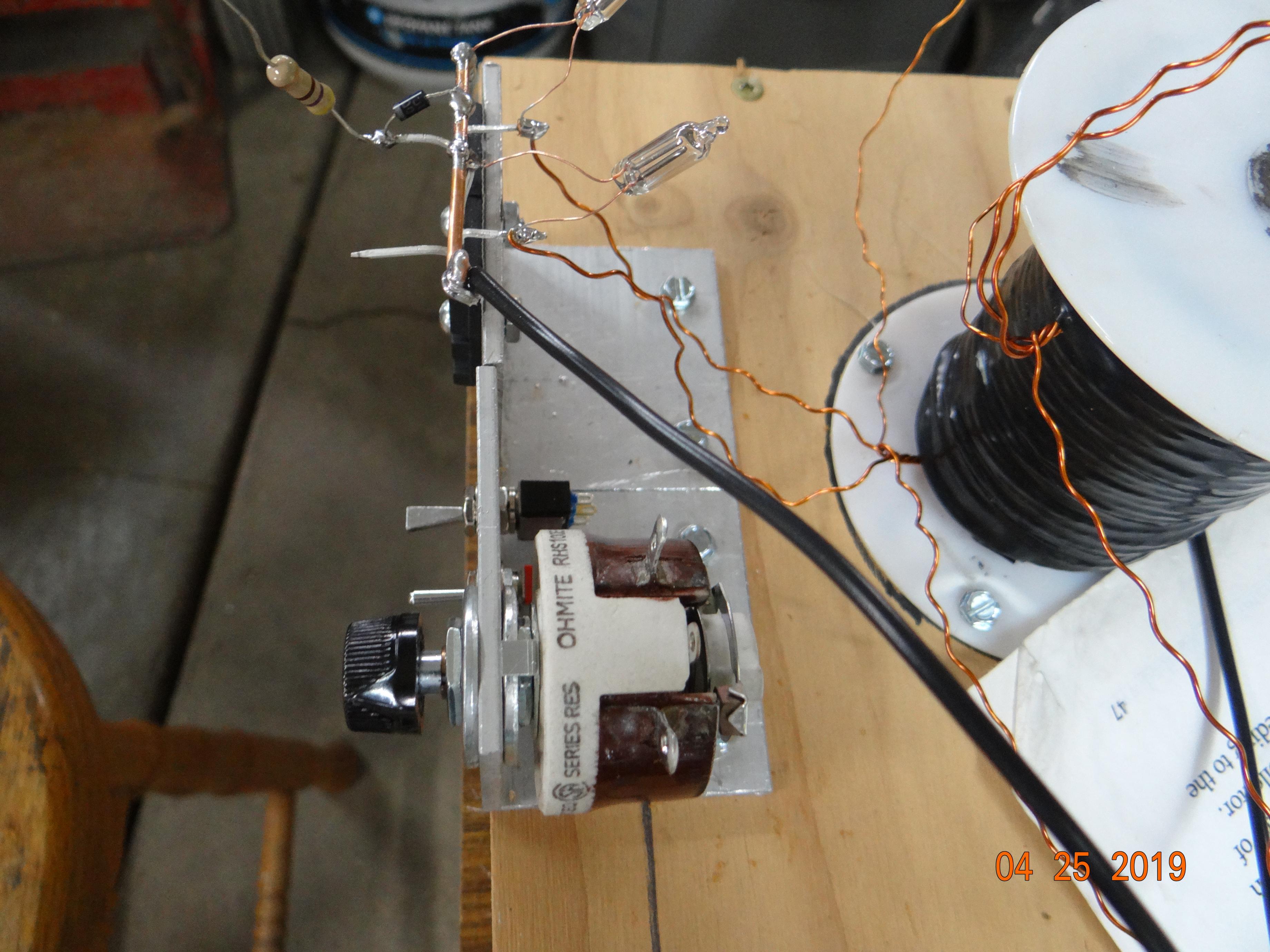

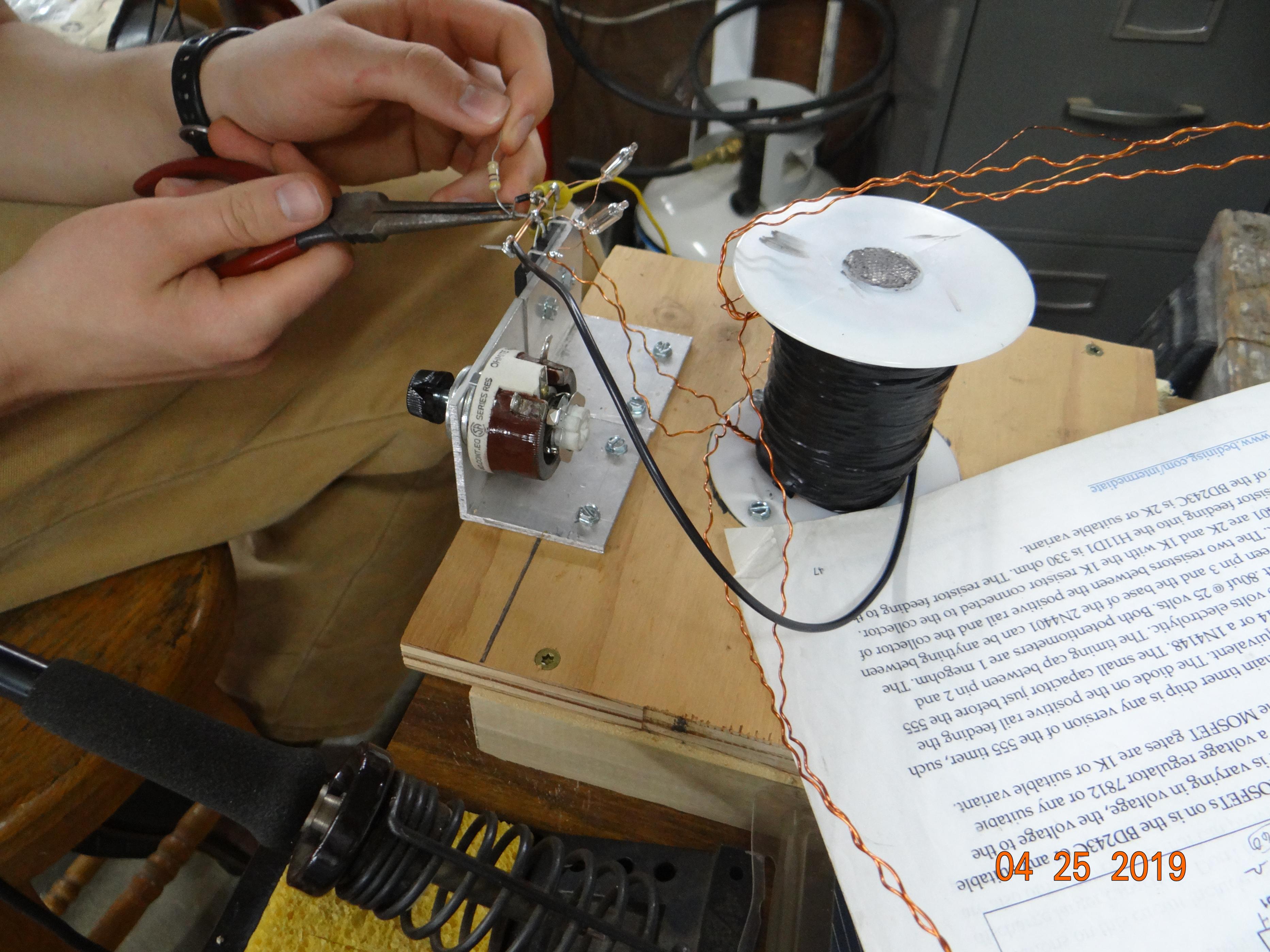

          My grandson got the drive circuit for the new coil about 2/3 done this afternoon. Here's a few pics of the afternoon in progress.

              Hi,

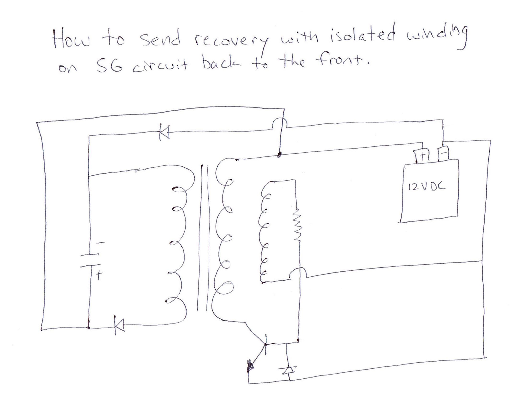

              Well, my grandson finished up the circuit this afternoon for the new coil we wound. We tried it out with double stacked magnets and it wouldn't keep running. So we went back to a single magnet and it still doesn't work like we had hoped for. It requires much stronger current pulses than the old coil, and doesn't trigger as well as the first circuit and coil did.
              The old coil had one #26 trigger winding and one #23 power winding each 275 feet long. The new coil has a #23 trigger winding, two #20 power windings, and another #20 recovery winding all 130 feet long. So the new coil has fewer total turns of the larger power wire which requires more current to get the same # of ampere turns of magnetic field strength to drive the pendulum. And with fewer turns of the trigger wire, the air gap between the coil and magnet has to be smaller and fails to trigger when the gap gets too large. The gap isn't always consistent as the work end goes up and down which causes it to stop triggering unless the base resistance is turned down to almost zero ohms.
              We were pleased, however, that the recovery coil system worked well at reducing the current draw from the battery. This whole device is very sensitive to every little change in either the mechanical side or the electrical side of the set up. So we are back to winding another new coil and maybe making some mechanical changes as well. This is all trial and error on our part and since it's my grandson's project nothing gets done on it unless he's here.
