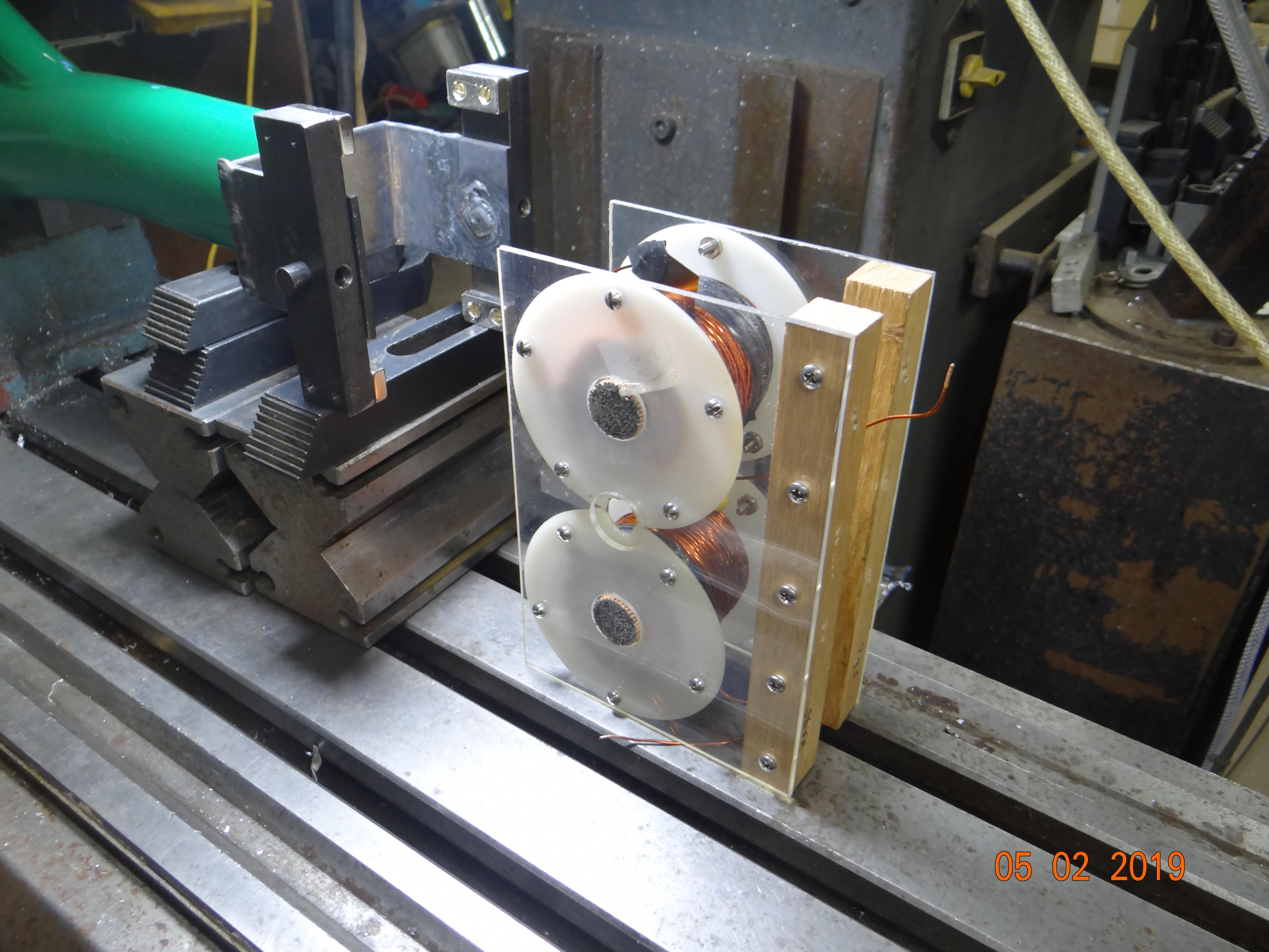

                        Next week we will weld the magnet assembly to the bicycle frame and mount the coils to the wooden A-frame. Here's a picture of what we got done today. The parts are sitting on my cnc mill waiting to be welded together. The coils are also there for the picture so you can see how it will work.

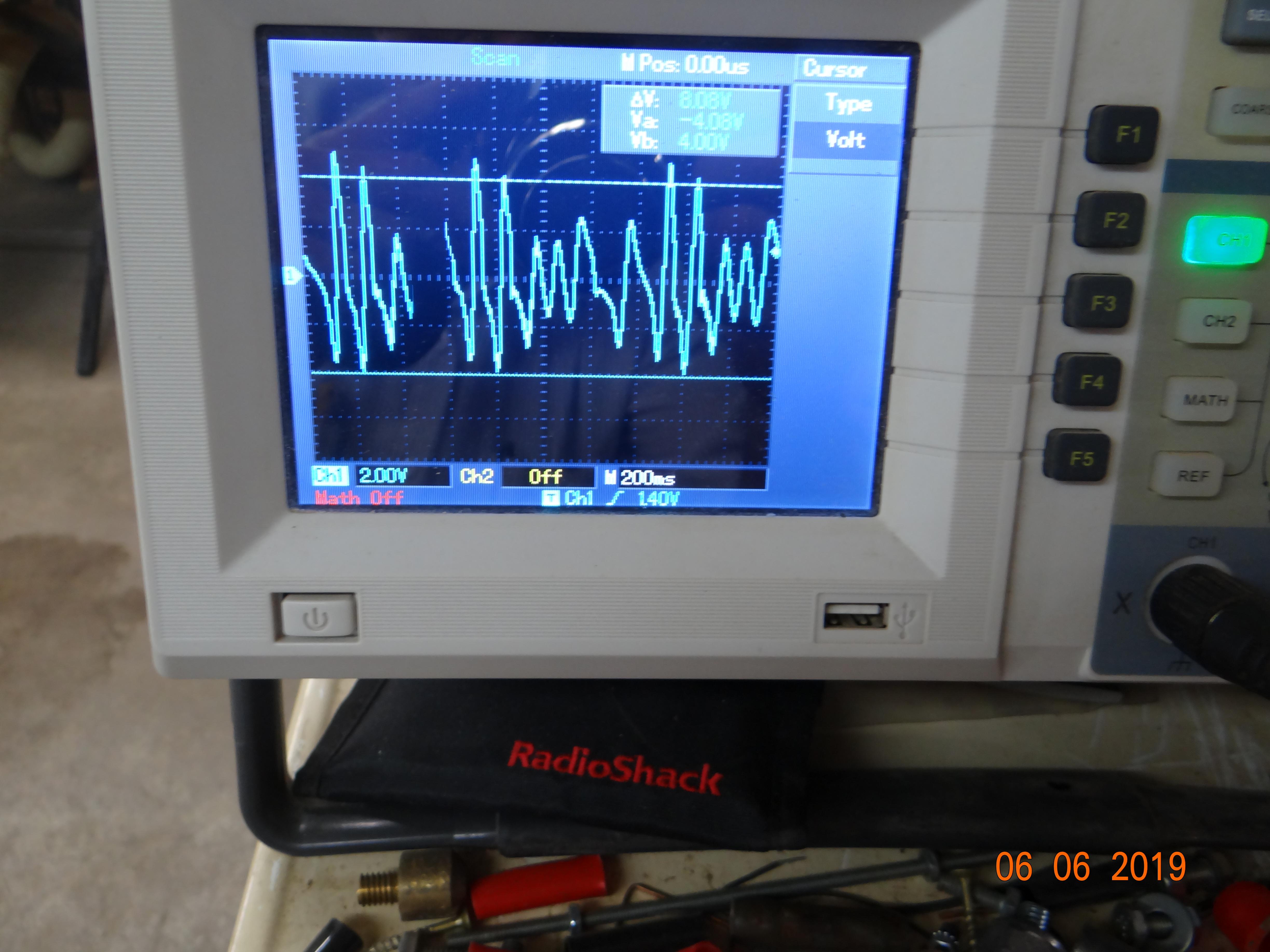

                            Here's an update to our two stage oscillator project. We got the genny coils mounted and checked the output which is pretty low. The wave form is shown in this photo.

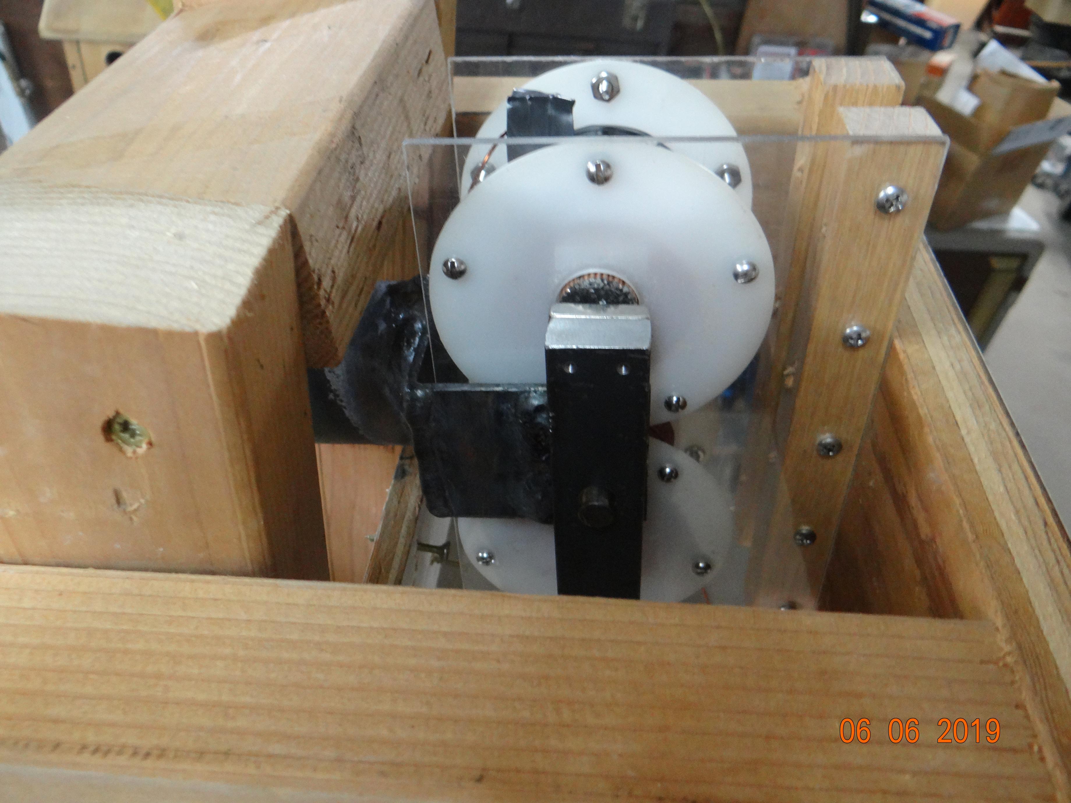

                            The genny coils are shown in this photo.
                            When the magnets were moved closer to the coils, the frame wasn't rigid enough to keep them from dragging. So we added some stiffeners to the frame and we still need to add a few more.
                            The voltage doubling setup gave us about 4 volts DC and would light a string of LED's. We need to get a lot more voltage than this to charge a battery. So we are going to replace the pendulum with a weighted bicycle wheel and try spinning it with an SSG circuit. If this works, we may power it with a split the negative battery rotation scheme.
