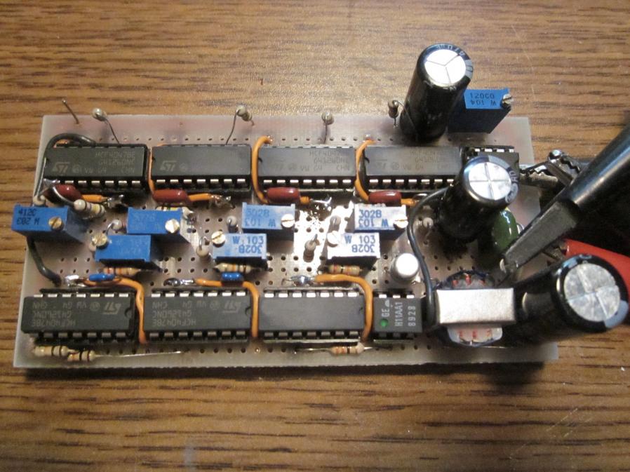

If you read a few pages back You'll find that I built this already while ago. I also hope that this device may solve many health problems. I don't have an access to medical lab and don't own good enough microscope to see what it does in vivo and how to do final tuning. All I know about is what have been handed out at the conference and YT clips posted by other member.
I wasn't there to ask questions therefore I cannot make any claims or provide more assistance beside what has been already posted. I'm busy with other projects a.t.m and will go back to 4WM once I can verify some details.

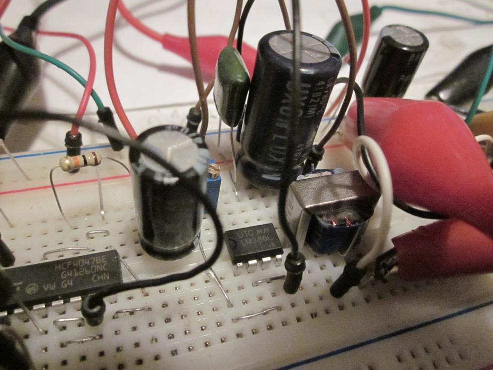

Today I went back to 4 Wave circuit and built another one from scratch. However, this time I used HCF4047 instead of LM555 for all seven oscillators. OpAmp is the same - 386 and H11AA1 opto as per original diagram. Since 4047 holds 50% duty cycle the only thing left is adjusting output pulse rate. I got first four oscillators tuned with same value - 10nF capacitor, the remaining two on 1nF and slow pulse timer on 1uF. First three frequencies are 50, 150, 350 - as were given by John. Next three are: 1,500, 7,000 and 10,000. Pulse timer set on 7.8Hz. Total current draw is about 10mA at 12VDC. I'm still testing the output part and different transistors. I don't see a reason for 3055 (which is a power transistor) being used here but will try couple different ones. I checked all output waves from oscillators, OpAmp output and everything seems to work fine. I'll post more details later.
Vtech

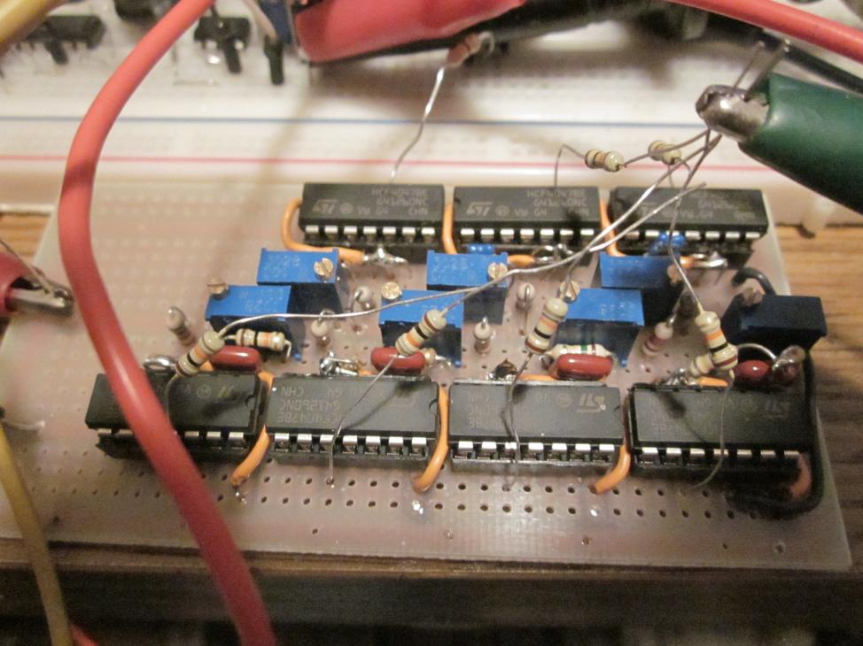

Ok, an update. Below is a list of component values for all seven oscillators from the top down:
IC1 50Hz, 470k but due to the tolerance it may get you at 49Hz. It is better to use 180k&270k in series + 20k trimpot.10n cap.
IC2 150Hz, 150k & 10k trimpot and 10n cap
IC3 - 350Hz, 56k & 10k trimpot and 10n cap.
IC4 - 1.5kHz, 10k & 10k trimpot and 1n cap. Following original values from the schem. 680, 100k, 47n will result in 153Hz which I believe is wrong since we already have 150Hz. If this was a printing error and it should read 4.7n the frequency will be about 1.526kHz @ 50%dc. I took this value as valid and set IC4 at 1.5kHz.
IC5 - 7kHz, 27k & 10k trimpot and 1n cap. This is the same value as calculated from the original diagram.
IC 6 - 10kHz, 18k & 10k trimpot and 1n cap. I listened again to YT where John mentioned "going all the way up to 10kHz". I don't know if this was a comment regarding the last oscillator but it seems in place. Unfortunately, I wasn't there.
IC7 - 7Hz, 20k & 10k trimpot and 1u tantalum cap.
Outputs from pin 10 (Q) of each six oscillators are connected via 10k resistors together - same mixing line as per original.
Output from IC7 - low pulse timer connects via 330 Ohms to pin 2 of H11AA1 optocoupler, as per original.
Everything else from the original circuit remains the same. Transformer primary (high impedance) is marked with "P". This side connects to the output of OpAmp via 1000uF capacitor and second terminal to the ground connection (Negative).
If you accidentally swap the primary with secondary and connect the electrodes to your temples it will knock your socks off and you may experience some colorful flashes for the next 30 min
so please pay attention to this little detail.

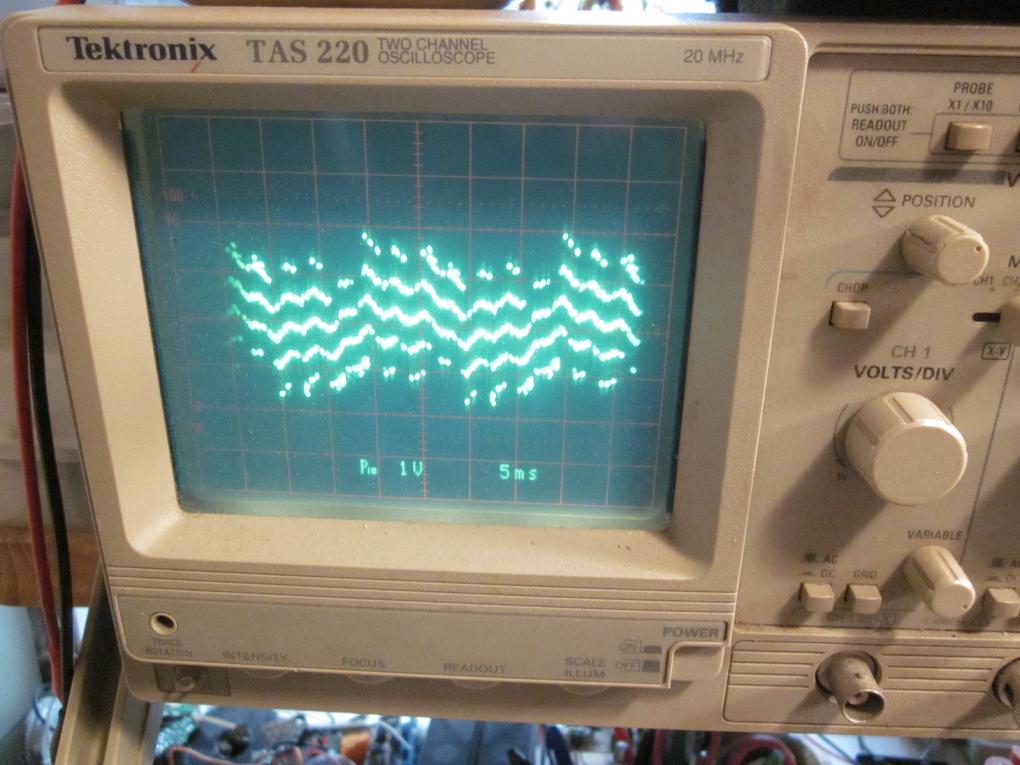

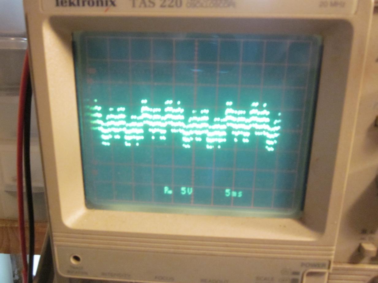

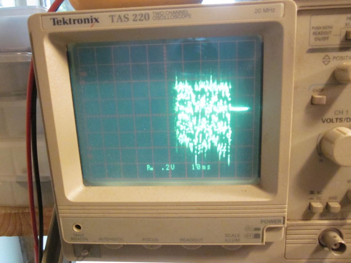

The file names for the above pics should be swapped between output and mixing line.
Update: I tested few transistors and 2N2222 seems to be a good candidate. I have an identical output to the one from 2N3055.Last edited by blackchisel97; 05-12-2013, 01:30 PM.
