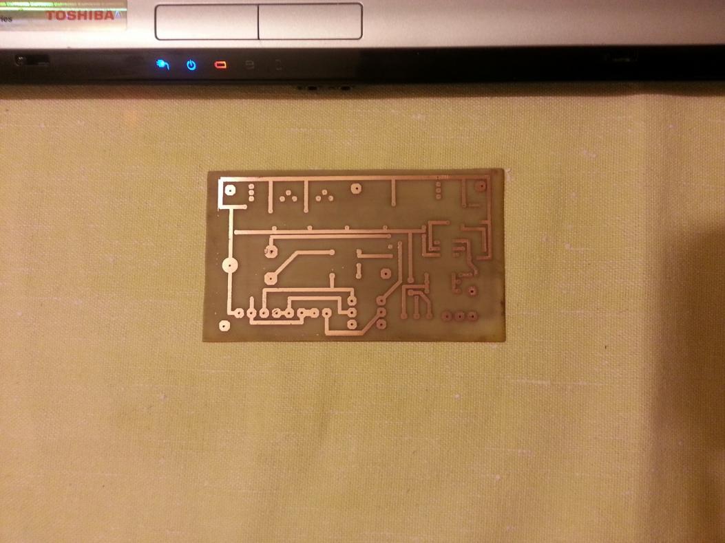

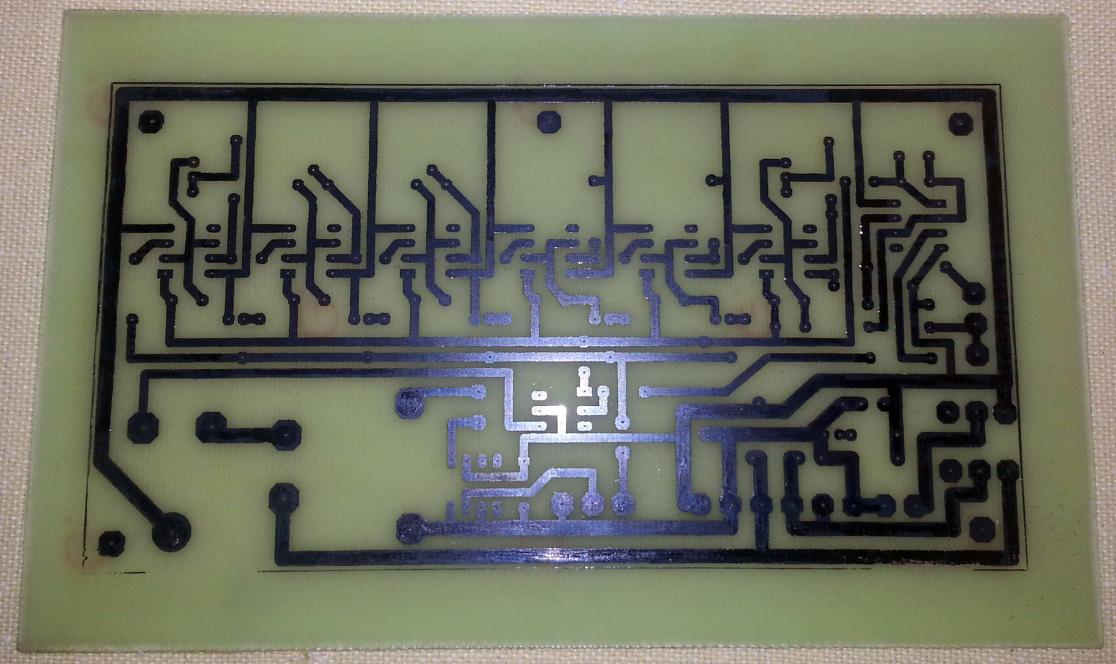

Outline is gone (already cut the surplus). It's there only as a marker to know where to cut.

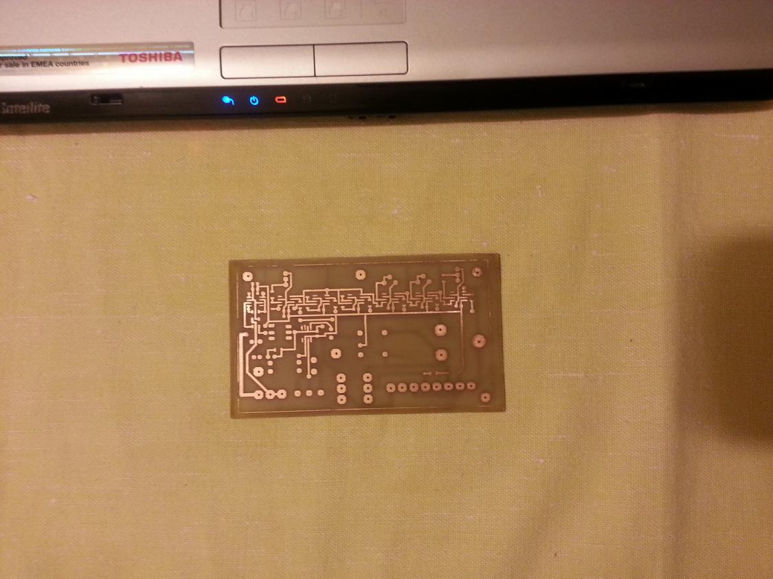

I had to print & reprint the PCB a couple of times until I got it right.
Because I noticed something weird about the press-and-peel paper.
Mine is about 10 years old and I still have a couple of papers left. Man, these are way old!
I didn't know that they degrade in time and won't cook right under the iron. It must turn pink when it's done and cooked right. And it didn't.
So I ended up doing my PCB with Chartpak drafting film.
Same age, but way much better!
Tomorrow I will try a couple of PCB's on photo paper & glossy and let you guys know how it goes and what gives best results.
Using this:
Peace!

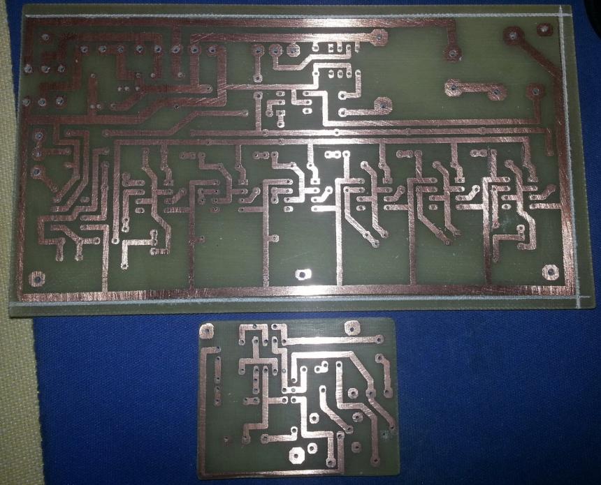

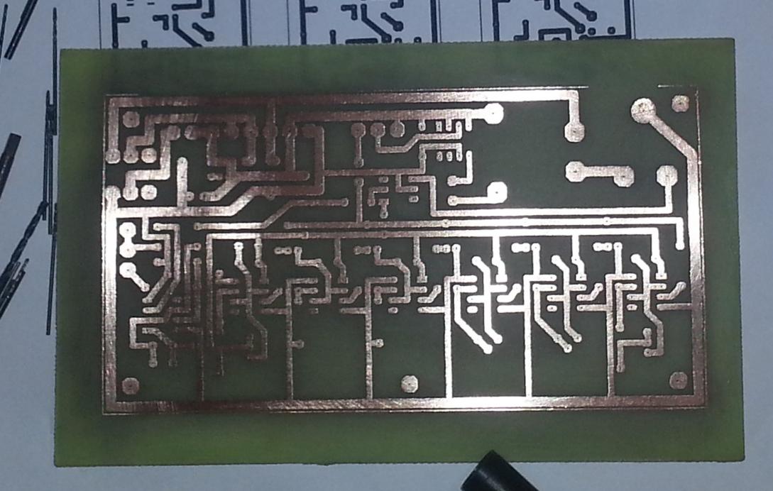

Done experimenting with PCB making.
I found out that even as it is degraded by age, press-and-peel paper offers by far the best results (so I'm going to order some more - blue type this time).
Followed by film ,glossy or photo paper.
Also, you get great results by using vinyl sticker or print screen vinyl but I have none to experiment with right now. Outdoor cricut vinyl or Oracal 651.

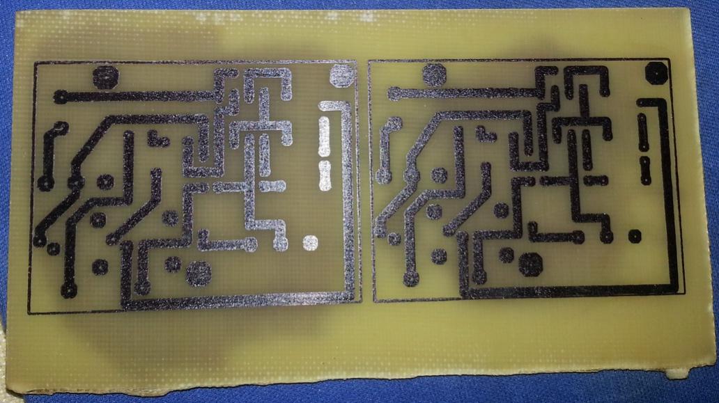

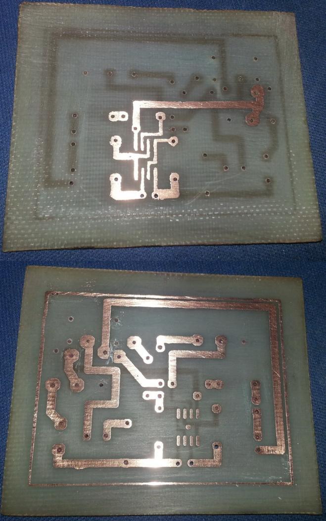

Here are the end results in their respective order:
- press-and peel paper (Mactac) (mine is 10 years old)
- Drafting film (Chartpak)
- Glossy paper
Sorry for the glare
Iron temperature must be set to polyester (~150 Celsius). Don't use steam!
Time of ironing can vary depending on your PCB size between 2-10 minutes.
For paper, after you're done ironing, put some soapy water on it and wait for the pcb traces to appear.
Then put the board under cold water and peel the paper.

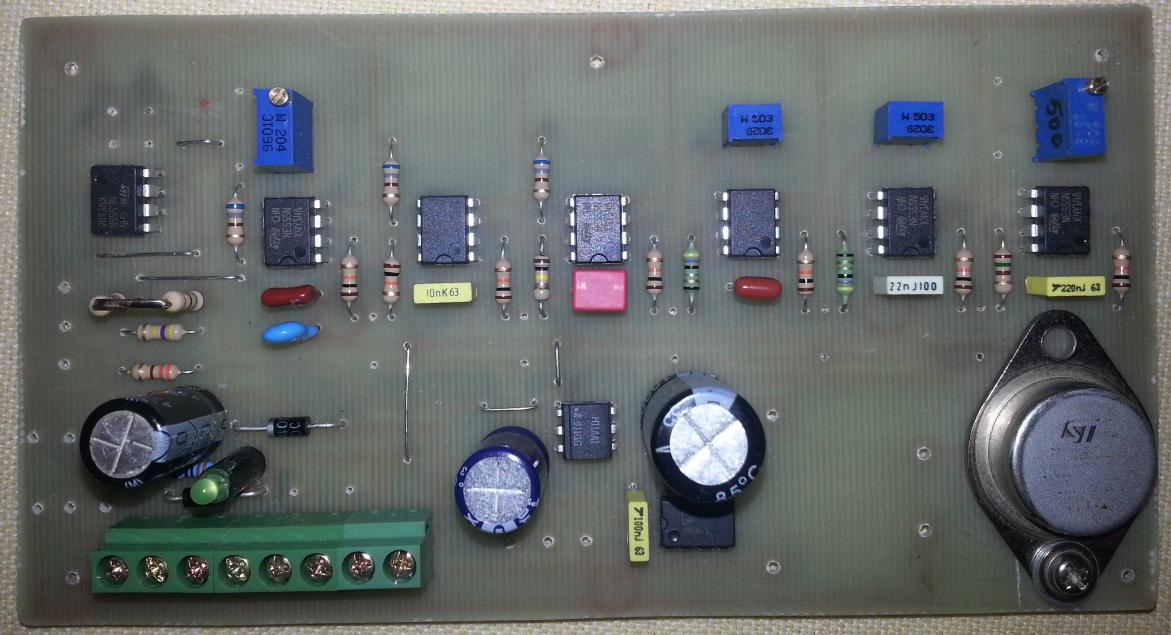

Hello. The right transformers arrived today for John's device. The one for Brain Synchronizer I already replaced on Friday. Wave form is very similar which means the audio trafo I had before was not much different. I see the flashes of light when connected near temporal mandibular joint (TMJ). Would love to know the pulse rate of the oscillators 4 and 5. I can calculate them from the values but they all have some tolerance.
That's all I can do tonight. Have to get up at 4am.

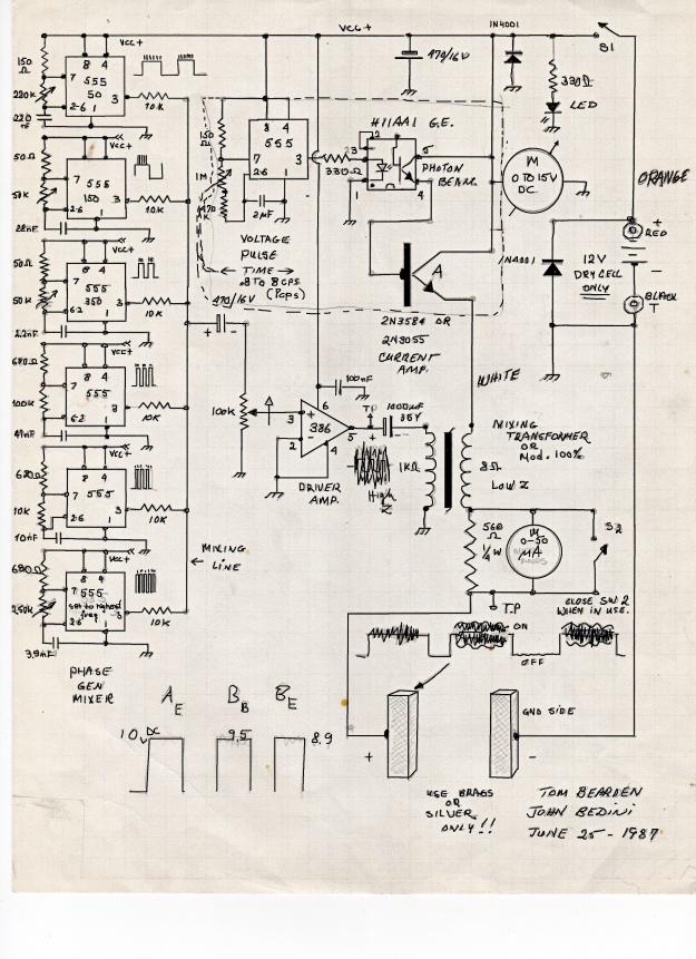

I redraw John's circuit for better clarity. Hope you don't mind John. If you have a chance and could chime in about those values it would be great. I couldn't attend the conference and ask in person so I can only rely on YT clips and schematics.

Valentin, I used 47n for IC4 and I'm getting 153Hz (or repetitions per second) at d.c approx. 50%. Not sure if this is right since there is already one oscillator running the same - IC2.
IC5 with those values from the schematics runs at 7kHz d.c 50%. IC6 will run from about 730Hz up to about 420kHz. John indicated to run as high as possible.
As I mentioned before, my IC2 and IC3 refused to work at R1 value=50 Ohms but there was no problem at 120 Ohms and frequency can be adjusted to 50 and 150Hz anyway. Duty cycle remains the same - about 50%.

My bet is on 4.7nF. 1.5kHz
And by watching the yt clips, I am sure now that a tiny bit of the left part of the schematic is missing.
Letter/A4 conversion gone bad.
So it could be 150 Ohms, not 50. Thanks for your input on this.
Also, correct me if I'm wrong: the 470K series with 1Meg pot. (IC7) seems to be 47K for 8Hz. Not 470 (0.7Hz).

Yes Valentin, you're correct. Just checked my circuit and I have 0.22uF there. It will allow to tune to 7 pps. With 2uF will not go that high, only 0.2 -0.7 pps. Also, reducing R2 to 47k will work.Originally posted by vallentin View PostThanks man!
I will see on Friday when I plan to tune the frequencies and add the 10k resistors. I also ordered 150 ohm resistors to replace the 50 ohms. Just in case...

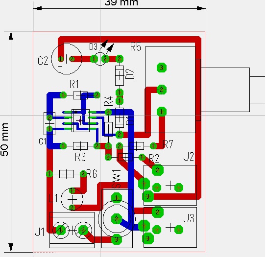

I'm gonna try the SMD version because the parts are 40-50% cheaper and readily available. This version is meant for my personal use...
Etch resistant pen? You don't need it.
Any glossy paper will do. Even those already printed. Leaflets, magazines etc.
After you iron the pcb on your board, 99,99 percent of your toner will adhere to the board. Along with minute traces of cooked clay (from the glossy substrate).
These will form a strong and thick bond to your PCB.
No pen correction needed. 3 minutes of work+etching time. Cheap of the cheap.
