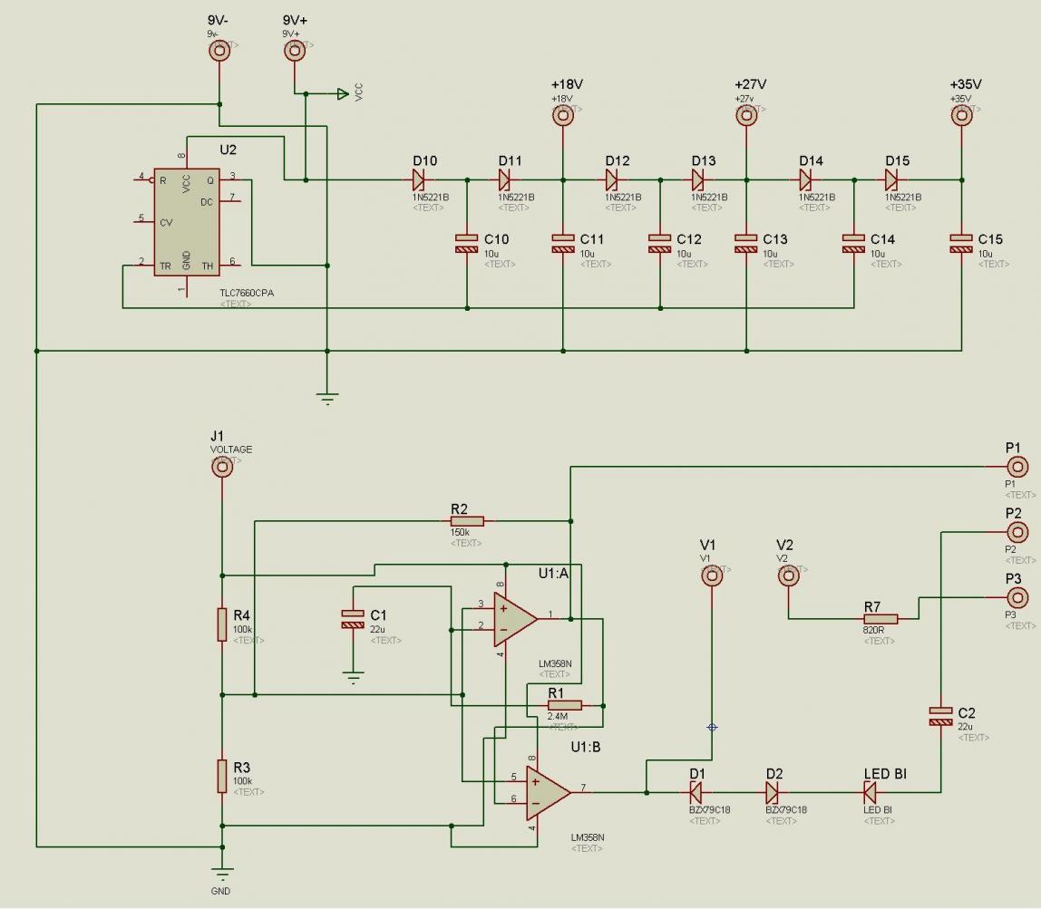

I am ready to build the beck blood electrifier with the Colloidal Silver generator. Would you be willing to tutor me until I get it working? While I have the schematics, do you have a PCB layout of the device?
sincerely,
teej_seeker

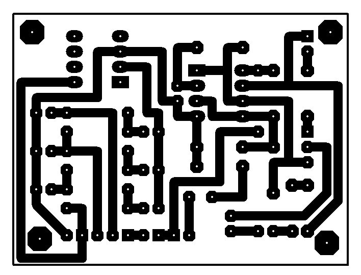

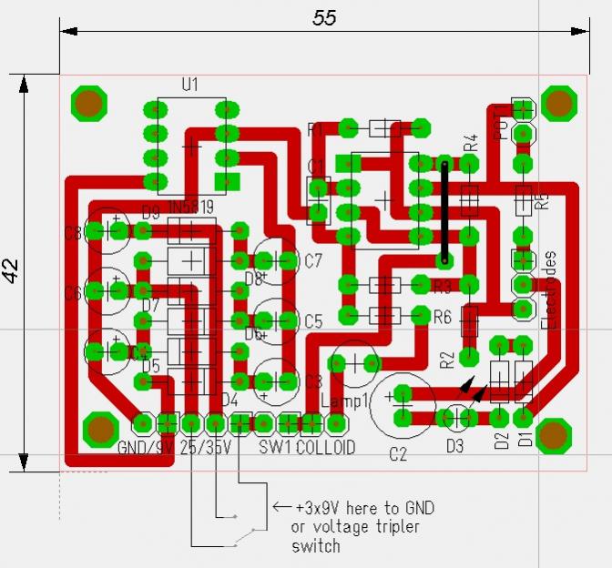

@Teej, you have it right here:
in post2065, thanks to Theunis.

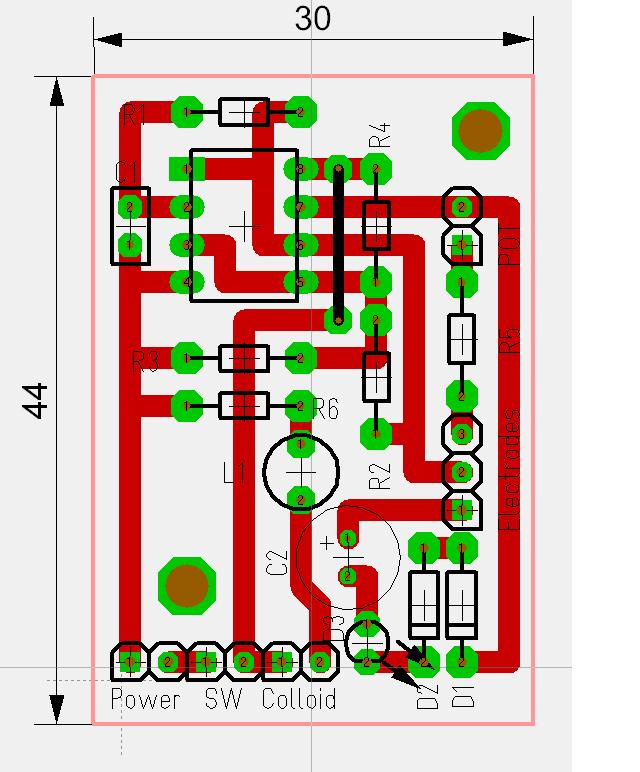

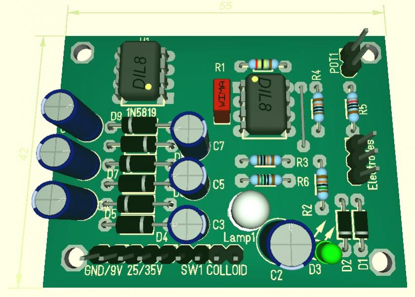

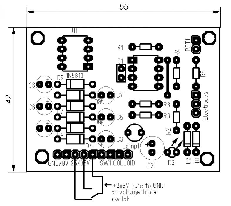

Here's my version of his circuit:
My component numbers are not the same as in his schematic, but you'll get the idea. If you need it, I'll post that too (reached the max img limit for now...) or i'll give you the Target 3001 project download link.
If you do the PCB by hand, mirror the image. If you use the laser printer method, don't mirror the image.
You can also use MAX1044 for the voltage tripler as in here: 9V to 33 but you'll have to modify the PCB a little.

Hi Valentin,Originally posted by vallentin View Post@Teej, you have it right here:
[ATTACH=CONFIG]1307[/ATTACH]
[ATTACH=CONFIG]1303[/ATTACH][ATTACH=CONFIG]1304[/ATTACH][ATTACH=CONFIG]1305[/ATTACH][ATTACH=CONFIG]1306[/ATTACH]
Thanks!
Valentin
