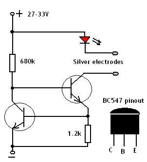

You can use this simple circuit below as constant current supply. 1.2k resistor can be adjusted for uA output range. I tried and it works fine. 2N2222, BC547 or similar.

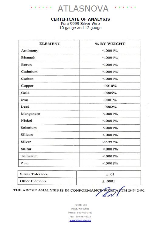

. This is 99.997, which means that 0.003 are max. allowable impurities. I've seen 4 nines - 99.99 but the next digit was 2 (99.992) which was still advertised as 9999 but the amount of impurities was 0.008p. Quite a difference. You can get 99.999 (five nines) but the price is prohibitive. Canadian Maple Leaf coin is the only one (known to me) having 99.99 purity.
