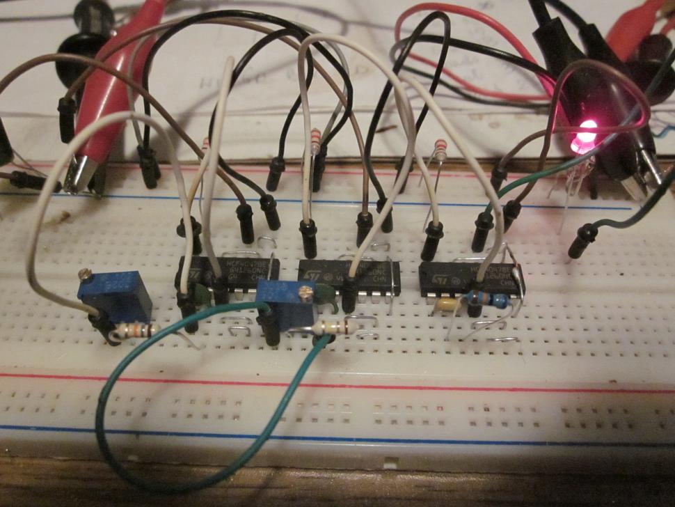

Mr Sunshiner, hold your horses. I'm still trying this new idea and not even started to think about making another pcb yet. Yes, timer would be good addition and eventually may be incorporated. However, adding another circuit will increase power draw and shorten battery life. Also, if you want to turn power off after preset amount of time you'll need a latching or double coil relay. Normal relay will stay ON as long as is powered by the circuit. Once power gets disconnected relay will return to OFF state and turn the power back. If you look earlier in this thread you'll find the schematic diagram of 4047 circuit and timer. I used an active buzzer (the one which doesn't need feeding signal, only power). Same circuit can also have an additional LED signalling end of session, instead of buzzer which draws more current. Both are simple to make. Also, there is nothing wrong with BT made on 556/555. I just assembled and tuned another pcb today and everything works fine. I'm always looking to improve things or find other way to make them work. That's my nature.
