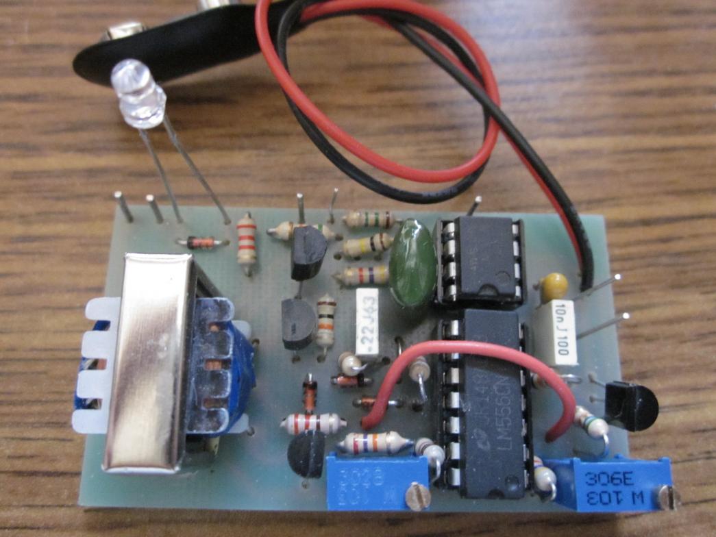

Assembled BT as per original 556/555 circuit -

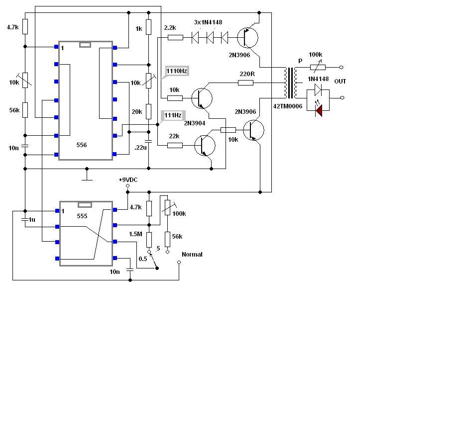

Sir, please kindly post the BT v2's components and their values list because in the PCB layout I found values of some components was not mentioned.I compared your PCB layout with schematic of Mr.algorythm where he has pointed all the modifications suggested by you in red color posted in page 26 in order find the missing values but didn't matched.Saturday I will have my new multimeter ,so I was hoping if you post the component's values list I can start building BT v2 from where I left it.So please kindly post the component's value list.

Here you go, values of components as I have in four assembled and tuned units -
Parts List:
Transformer - 42TM006-RC (Mouser)
IC - LM556N, LM555N
Trimpots: (vertical) 100k,10k x2
Transistors: 2N3904 x2, 2N3906 x2
Potentiometer - 100kA w/switch
Miniature switches: On-Off-On, On-Off or one switch SP 3 position
Capacitors: 1u tantalum, 0.22u, 0.01u x2
Resistors 0.125W: 1.5M, 56k x2, 22k, 20k, 10k x2, 4.7k x2, 2.2k, 1k, 220R
Diodes: 1N4148 x4, LED 3mm red
Battery connector
