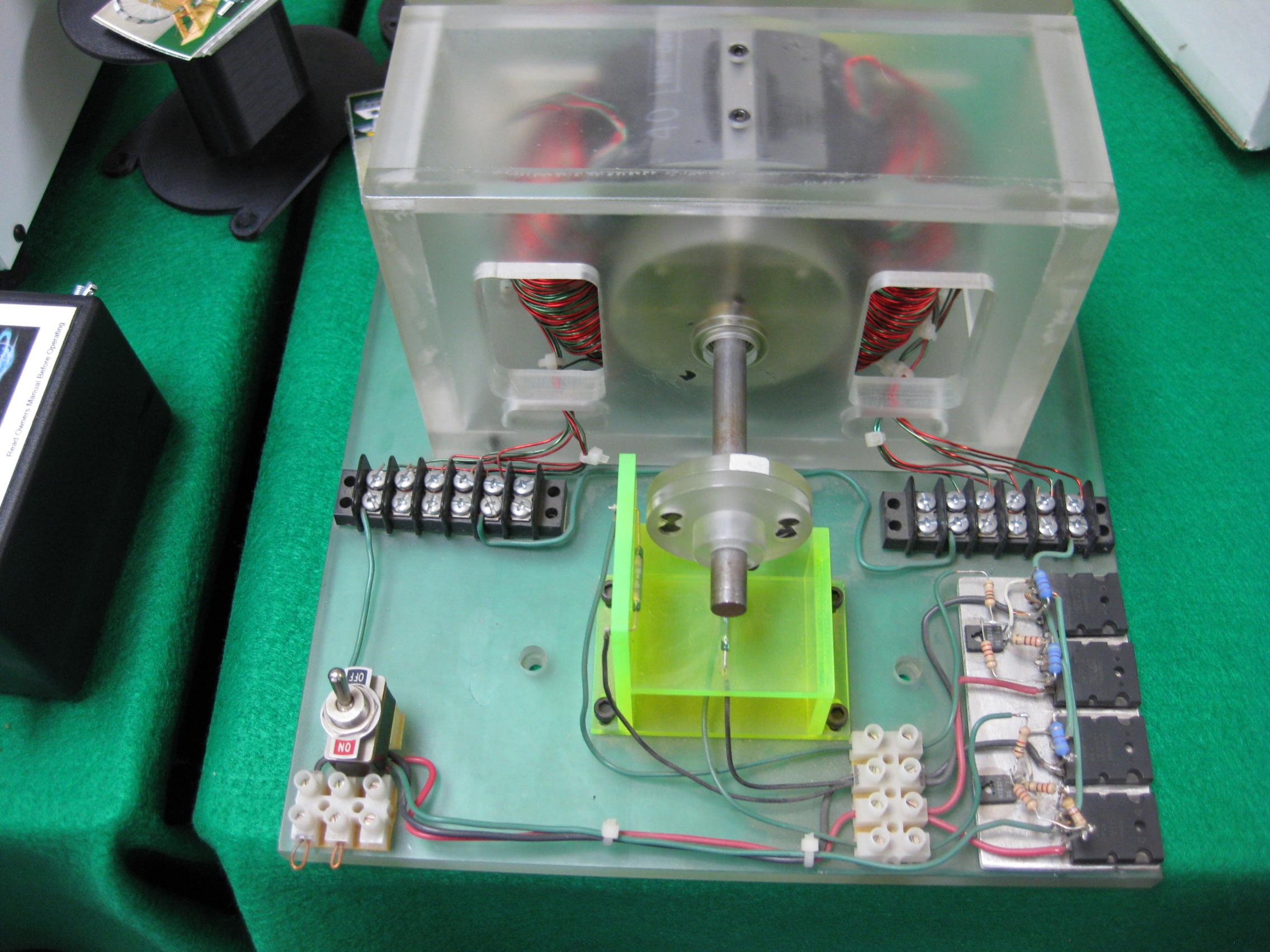

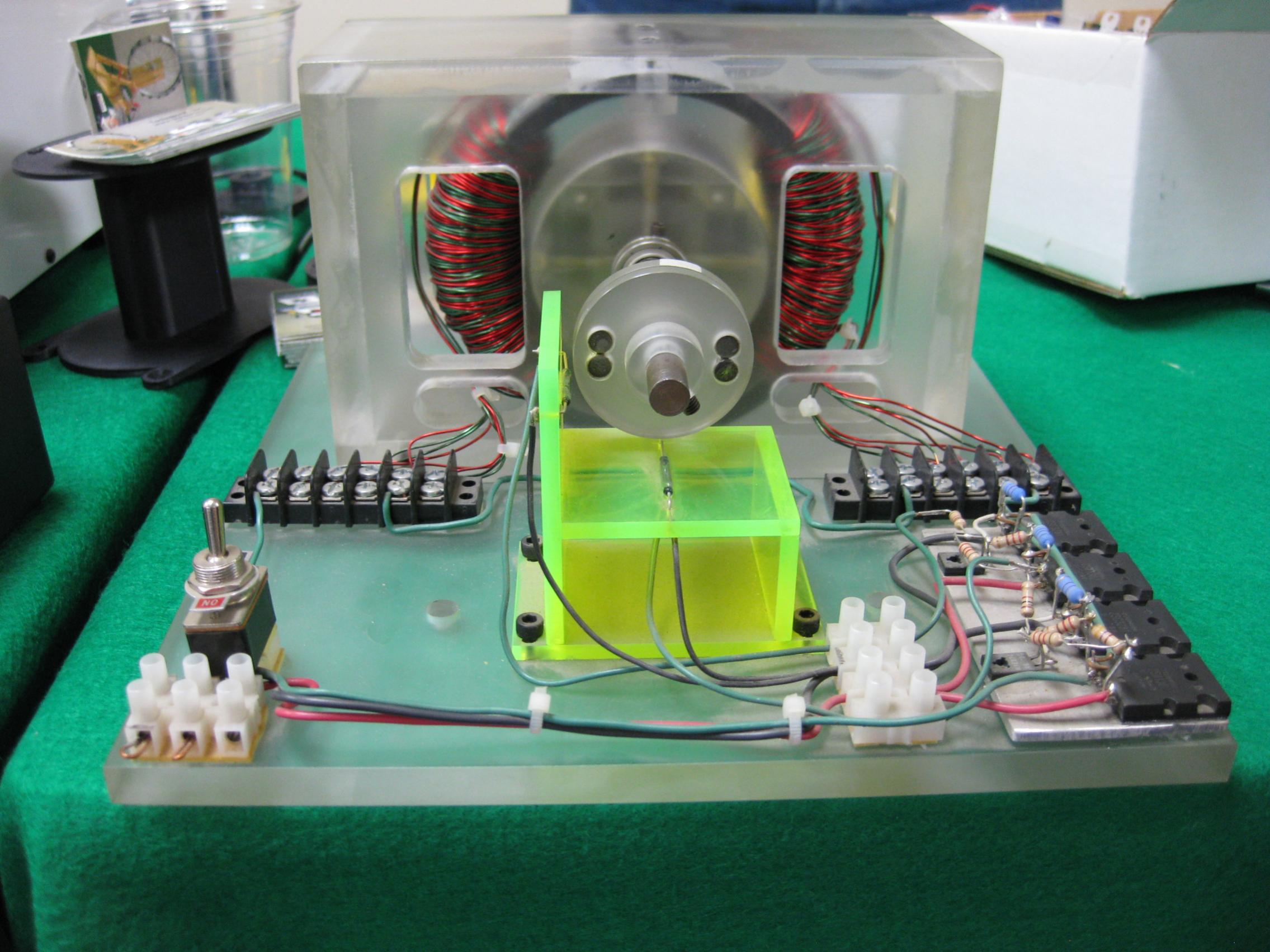

                    The first step here is to view JB's video https://www.google.com/url?sa=t&rct=...XoKuGOX0dWzBgA This should give a good representation of the ZFM in operation - more importantly inspect the magnetic field diagram that is in two places. This shows JB's basic concept and layout of how the device works - very helpful.

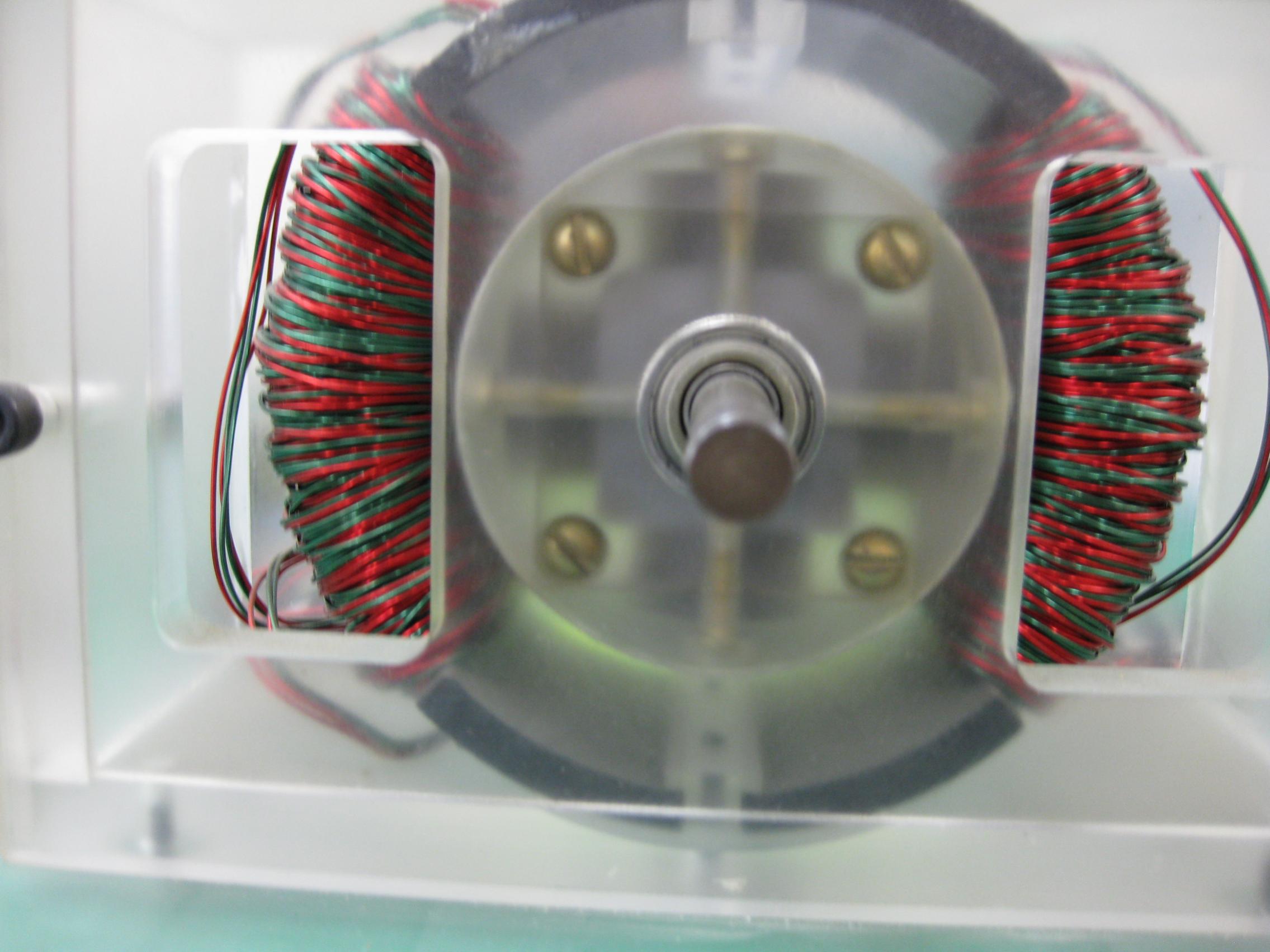

                    Detail wise RS and I measured the the significant details using a piece of graph paper as a ruler - Ha! The drive shaft appears to be a nominal 0.375 inch. The toroid is 4 inch plastic pipe sched 40 with an ID of 4.00 inch and 1.25 inch in length. It is notched with two 90 degree cut outs for the coil windings - not able to determine at this time the depth of the notches. The OD of the neo holder is about 2.6 inch. The running gap to the windings appears to be about 0.25 inch with the neo's at about 0.325.
                    These dimensions should be very close to actual, but bear in mind that they are scaled off the pics (attached).
                    RS and I measured the wire resistance of each series strand (four wires) at 0.8 ohms, however the overall measurement of the series strand turned out to be 2.5 ohms - scratching my head on this one since it significantly alters the total length of #20 awg mag wire. Each coil had a separate termination block. Somehow we fouled up?

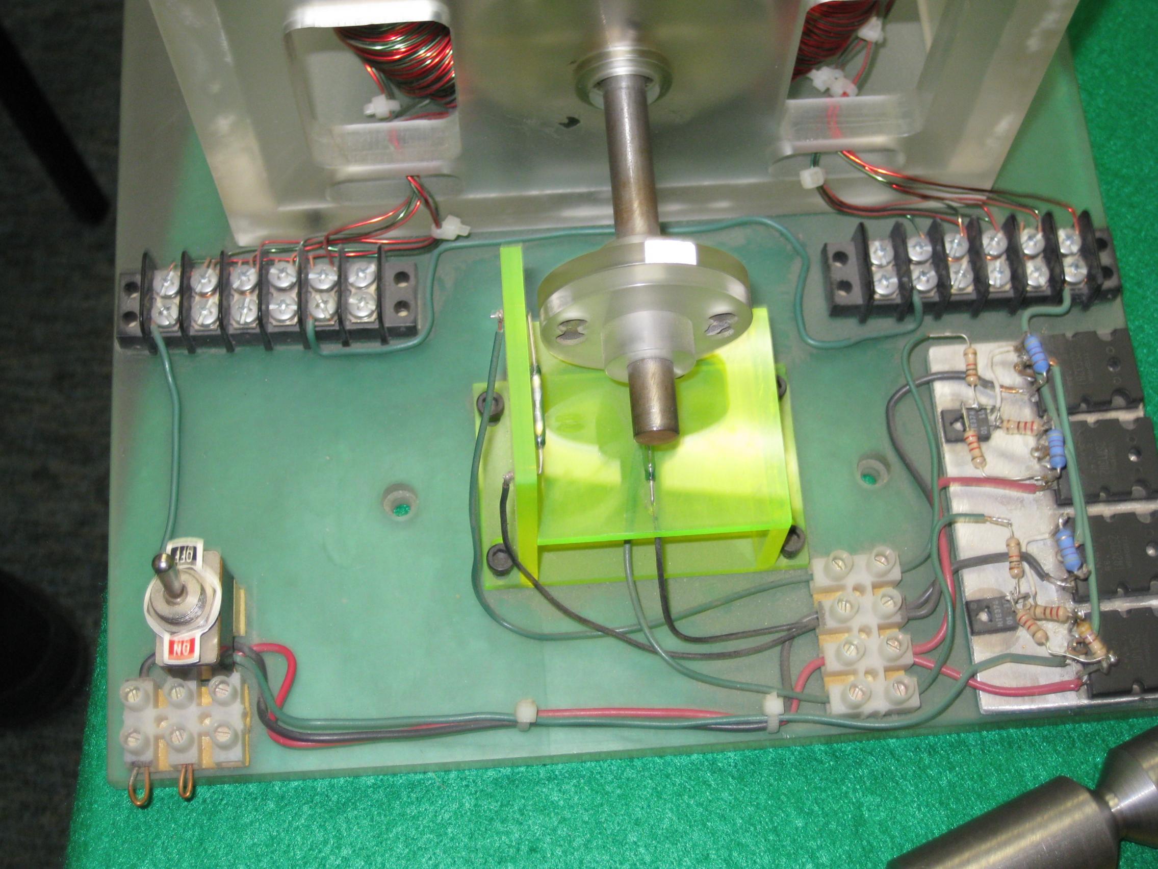

                    The firing circuit is activated by a timing rotor with two magnet 180 degrees apart triggering 2 reed switches to the circuit. It appears that these magnets are aligned with the rotor neo's. There may be some minor adjustability here for getting the timing right.
                    Being a gear head the circuit with 4 transistors is pretty much Greek to me. I leave this detail to the experts. See pic. I do have a closeup of the board itself but need to retrieve it from my cell - will post it later in the day.
                    The physical enclosure is a detail that is not overly important - the guts are the thing.
                    Yaro

                      Other details: the rotor magnets are 3/4" neo's 90 degrees apart and that on the working model there are four strands of #20 wire in series wrapped in a figure eight pattern on the toroid - a bit clueless on my part as to the specifics of this detail.

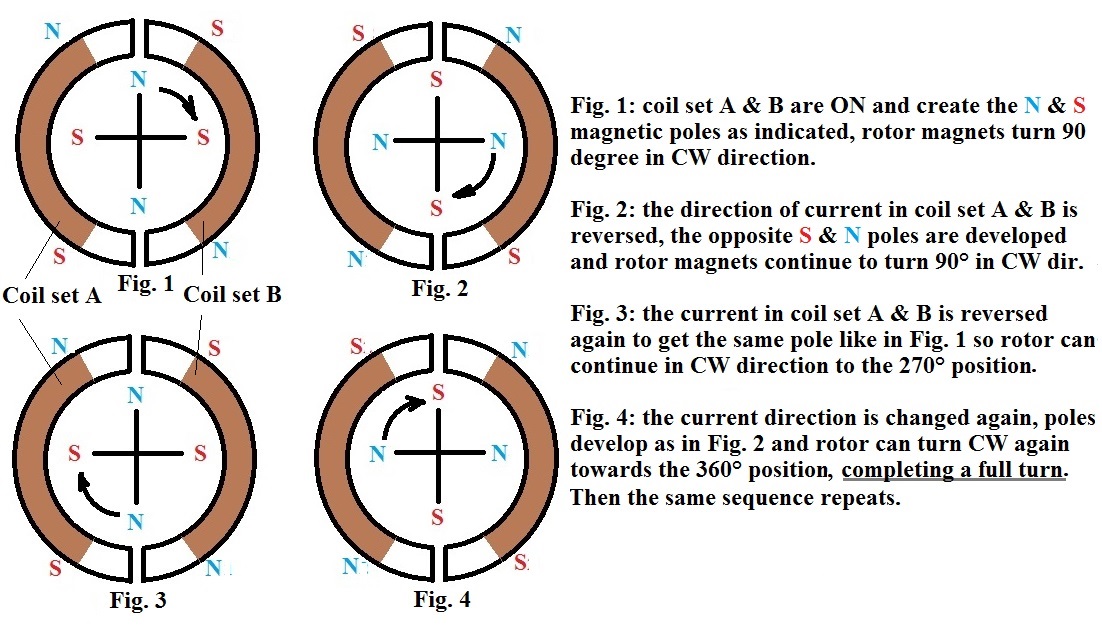

                      I thought to make a drawing on the switching sequencies. I assume that coil set A on the left hand side bobbin would have 4 coils in series, made from the 4 strands of wire and coil set B on the right hand side is similarly built, also from 4 strands of wire, connected in series. Then coil set A and B are also connected in series to have the same current in both.
                      Of course I may be mistaken in the assumed operation, this could be confirmed from the pictures. Regarding the poles of the rotor magnets, they are NSNS as indicated in the drawing.

                        Thank you very much for showing the pictures. Will study them and make correction to my above switching sequence if needed.
                          Well, do you mean each wire out of the four strands had 0.8 Ohm? (regardless of whether it was either the green wire or the other one?)
                          From the pictures it seems to me that there might be a small difference in diameter between the green and the other wire, the green one may have size #21 ? Of course if you used a caliper for both wires, then they are equal in diameter for sure and my eyes are deceived by sensing a small difference.

                            All the wires looked to be #20 to RS and I - there was a SSG coil next to us and the wire size appeared to be identical. All the strands for each coil are serial connections - apparently JB used what was on hand. We had absolutely no measuring instruments on hand; no micrometer, caliper or tape. Nada!
                            Tom C had a DVM on hand and we measured the resistance of each of the four strands separately on the black terminal strip - then we took an overall series resistance measurement.

                              Dear Yaro,
                              If you mean John's 14 minute long video demo on the zero force motor ( https://www.youtube.com/watch?v=XQzcYZk9MWA ), then you are correct.
                              That setup is a 3D printed version and the simple form: it has a single reed and single transistor to switch the two vertical coils that are connected in series. Each coil developes a N and S pole at their ends and John explains the push and pull operation (pulling on one side and pushing on the other whenever the reed triggers the transistor switch).
                              However, if you read this post below from John, it turns out that the rotor magnets are NSNS... See how John put it:
                              "The arrangement is much different on the rotor in peters model NN, SS across from each other. In the 3D demonstration model I have chosen to arrange the magnets NN, NN to keep it simple and from building a bi-polar switch."
                              This is the link to his post from 2015:
                              This NSNS rotor magnet arrangement means that my proposed drawing with the switching sequencies could be correct.
                              I did not mention in connection with the drawing that at the motor start-up the lower reed switch (at the 6 o'clock position) controls one of the inputs of the bipolar switching circuit (it is also known as the H bridge) and the rotor turns CW direction. When it covers 90 degree, the other reed switch (at the 9 o'clock position) controls the other input of the switching circuit and the latter reverses the direction of the coils current with respect to the starting direction. Hence the magnetic poles of the coils also reverses as shown in Fig. 2. Then the process continues and alternates the coil poles.
                              Okay on the wire size #20 for both wire types, I do accept it of course. I do not think the exact number of turns are critical, perhaps making similarly 'fat' windings will suffice.
                              If you or others have any issue with what I propose in the drawing, please ask.
