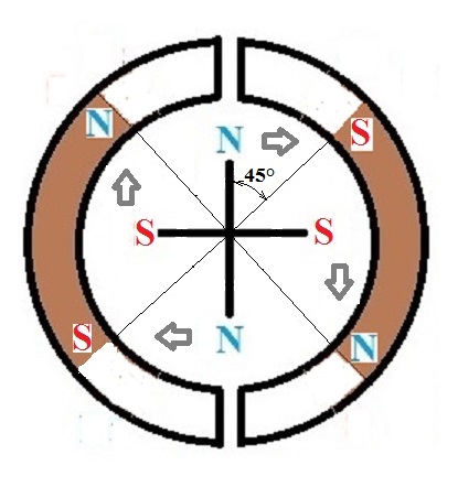

    Thank you for your very informative posts concerning some of the design details of the ZFM. Your magnet configuration diagram and explanation of the operation certainly make a lot of sense and clarify the basic operation of the ZFM. So this is one ZFM configuration that will work assuming the machine that was operated and inspected at the conference is unmodified.
    In JB's presentation of the ZFM he spent quite a bit of time explaining the magnetic fields that are within the ZFM and he stated that at 45 degrees between each set of the four N facing neo's was a Super Pole and that was one of the reasons that the triggering of the toroidal coils took place at the Bloch wall point of each coil as the magnet passed. This point reinforced the prior presentation's highlights of diamagnetic and paramagnetic fields as put forth by R. Haralick.
    Anyway two different views here and I will attempt to get additional information and details on the existing original ZFM that was demonstrated at the conference. Happy to try both configurations if need be, not a stumbling block at all. Perhaps I can also obtain a better image of the magnetic field arrangement for others' reference.

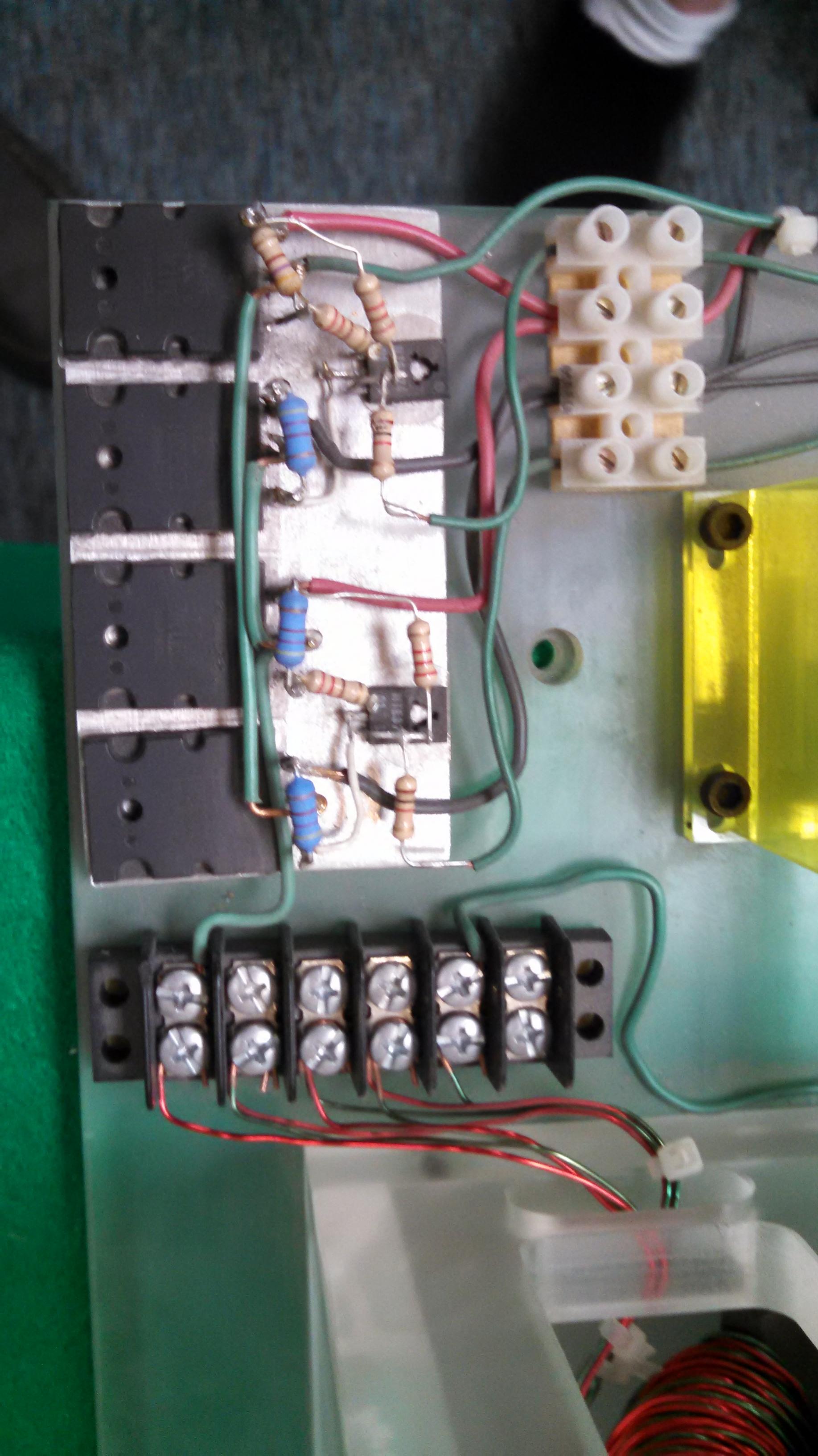

    In any case, I have attached a more detailed pic from my cell phone that depicts the ZFM's four transistor firing circuit. Perhaps your examination of the pic will confirm the NSNS rotor neo arrangement.
    Appreciate your analysis and input,
    Yaro

        Hi Yaro,
        I do think that the machine shown at the conference was unmodifed and sure was in the same condition as Peter built it years ago. I base this on John's normal habit of not disassemble any device but build another one if you want to experiment with it.
        Re on the super poles that develop between any two North poles, I accept this but remember that this explanation is valid for this 3D simple zero force motor where the rotor magnets are positioned with all North poles radially outside. And if you listen to John's talk again from video time 2:48 to 3:14 in his video https://www.youtube.com/watch?v=XQzcYZk9MWA you can hear "...but normally you'd have two South and 2 North poles" and I think the 'normally' can only mean the other setup shown at the conference. I think on superpoles John has always meant two identical magnetic poles (either NN or SS) placed near to or touching each other so that the two identical poles are able to reinforce each other by summing up the fields.
        In the setup shown at the conference, superpoles cannot develop due to the alternating NSNS rotor magnet poles but I believe this 'lack' is amply 'compensated' by the fact that each rotor pole is simultaneously pushed and pulled by the alternating poles of the coils as the 2 reeds control the H-bridge.
        As John mentioned the simple version (the 3D one in the above video) is easier to build, it has a single reed to control the single transistor to energize the two series coils.
        The setup shown at the conference has 6 transistors alltogether (4+2) and 2 reeds. The inductance hence the performance of the coils is increased by the 4 + 4 strands of wire. The use of the half curved bobbins insure the magnetic poles at the ends of the coils can be closer to the rotor poles, this way they are able to exert higher tossing and pulling forces (thus increasing shaft torque) with respect to the straight vertical coils used in the demo 3D setup.
        Thanks for the attached picture, it is surely the Bedini-Cole sequental bipolar switching circuit, (shown for instance in the youtube video I referred to in reply #12), the two Hall sensors indicated in that schematic is left out and the green wires coming from the reeds are soldered to the 1 kOhm resistors that then connect to the bases of the input transistors. (The other pins of the reeds ,black wires, are tied to the common battery negative of course.)
          Yaro
          [ATTACH=CONFIG]5449[/ATTACH]
          If you think about the full bipolar Bedini/Cole ckt in terms of the window motor and magnet NSNSNS arrangement in relation to the coil and the "180 degree" timing it should become very clear. All that is happening is the ckt allows you to switch the direction of current in the coil so what ever magnet arrangement you choose is up to your imagination.
          The big difference being the ZFM's coil and timing.
