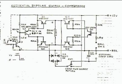

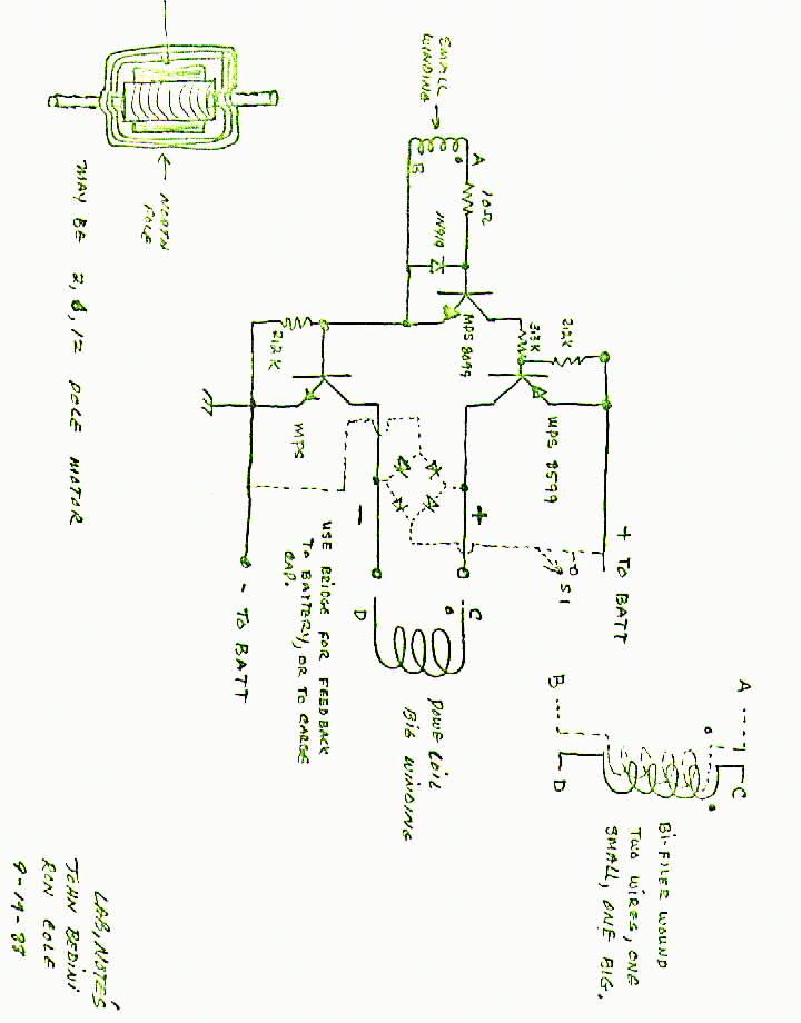

                                I just want to zero in on this, many have commented before regarding window motor that it is a very good idea to focus in on the half bipolar switch like the one JB demonstrated in the video I posted with the blue wheel. Tuning is tricky enough with the "half" let alone the "full" bipolar. Below was drawn up for the full bipolar hall configuration, just cut it in half:
Name:	Sequential Bipolar Circuit.jpg
                                I'll also attach the half using trigger coil:
                                One can easily replace hall with reed. I also recomend watching JB's 3D printed video on the Zero Force to see how he gets two switches per magnet pass. This was an interesting function...
