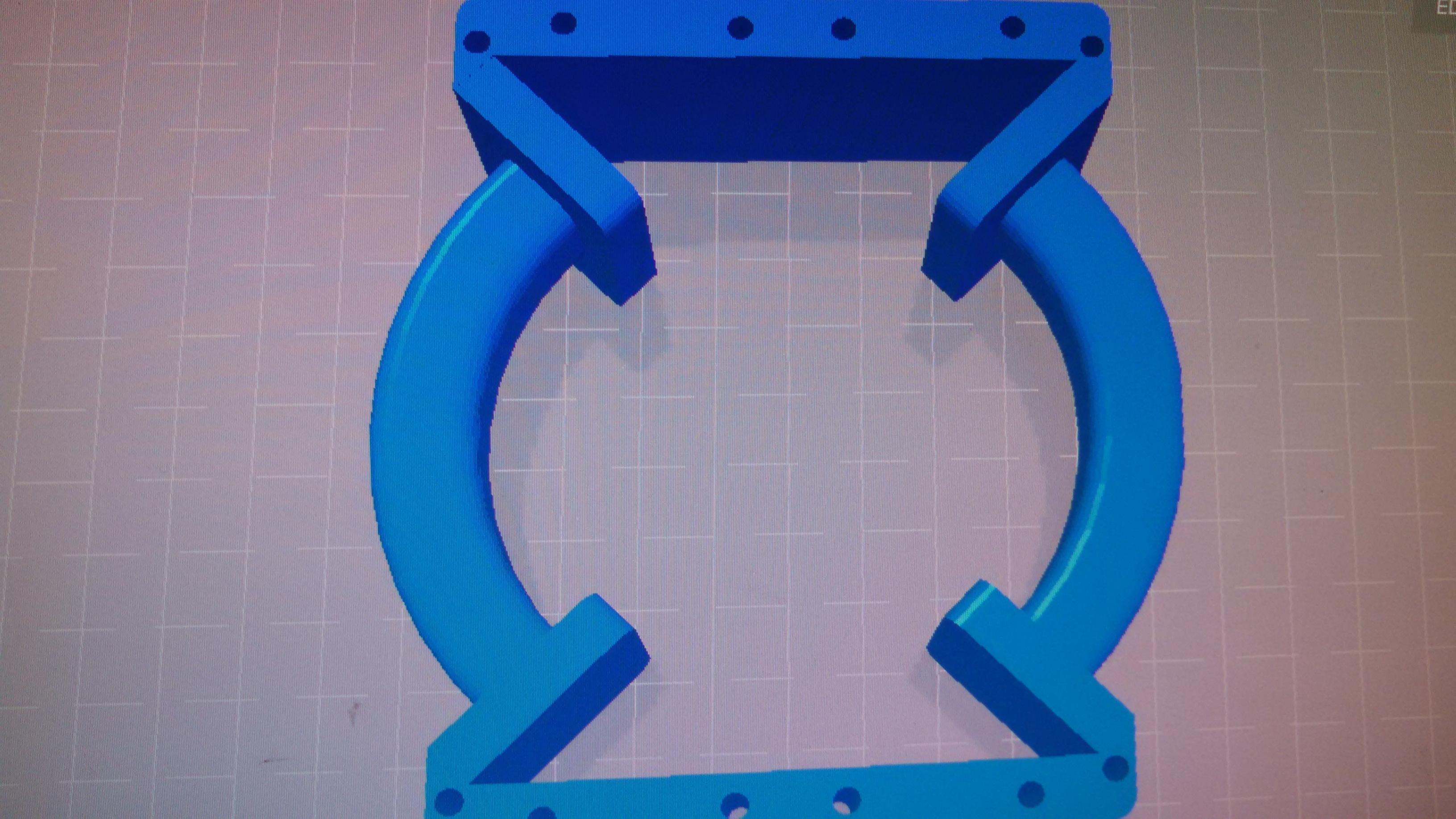

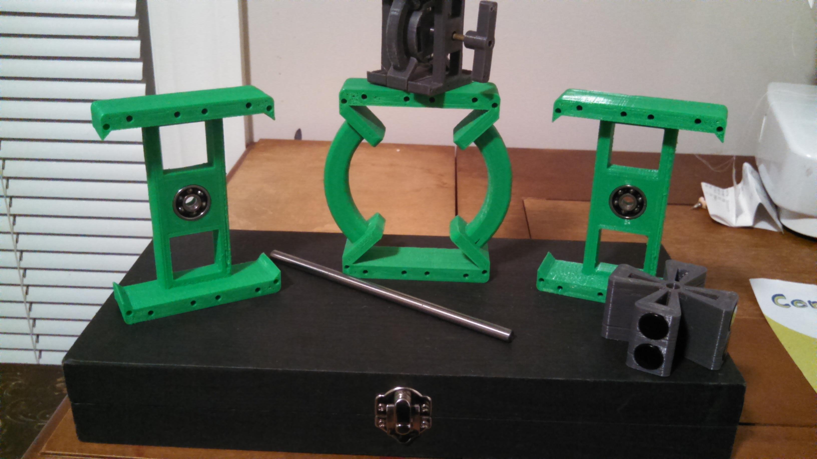

12/08/2016 With some encouragement I decided to add this version which seems to be closer to Peter's replication. The coils take up two 90 degree sections of 360 degrees. The rotor here is 2.25" inches radius. The magnet sizes, shaft, bearing, and bolts are the same as version one. This print will be more difficult. You will need to use support on the coil piece.

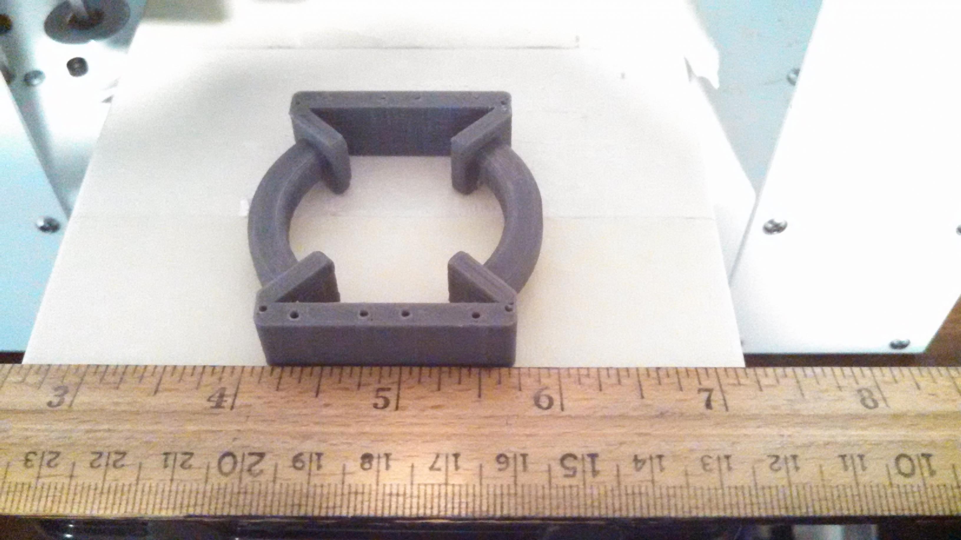

You can use my plastic rotor file supplied or you can fabricate your own metal rotor like Dave mentioned above. The maximum diameter of the rotor should be no more than 2.25" with this one. This design also offers horizontal stackability. I posted to the same Thingiverse page. There are five files with this V2. You will have to print two bearing holders (one for each side). If you need a source to print anything I would recommend contacting Teslagenex. The size of this motor is slightly larger than the first motor. It is roughly about 4.5" square.
If anyone sees any issues or has suggestions please comment.
