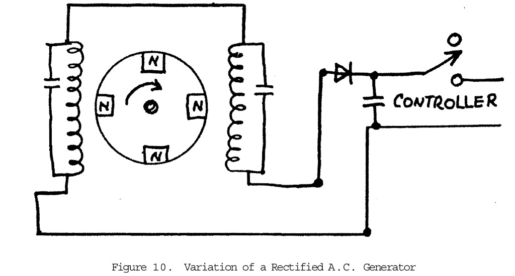

            • James nice video, when the machine turns off it produces high voltage spikes... It reminds me of a generator John Bedini said he experimented with in his 1984 book.
                Of course, those two tank circuits will want to be driven at a particular frequency - or octave.
                • Originally posted by wrtner View Post
                  Hi ,
                  This diagram pertains only about the Monopole Energiser for the Single Battery system, think again those Capacitors could only be representing the state of the coils in that configurations and not as actual lumped physical Capacitors!!

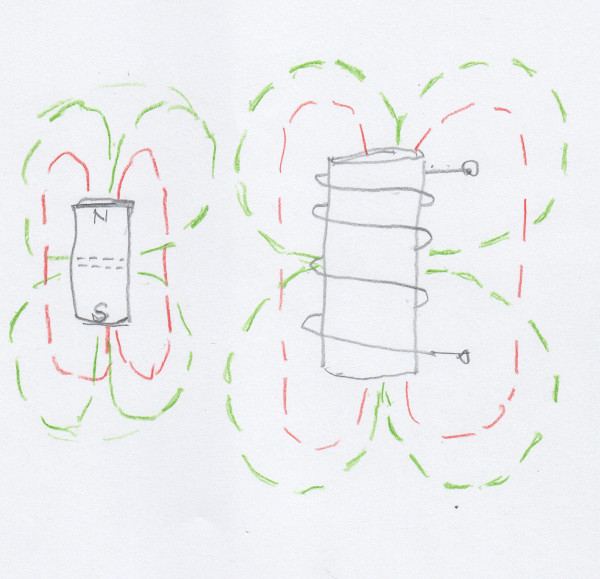

                            • Just a quick explanation of what I was attempting to explain in the video...
                              If you trigger on the RED line then you get one smooth motion from one end coil to the other
                              If you trigger on the GREEN line then it pulls in and stops at the block wall ... you then change polarity of the coil and it pushes out.

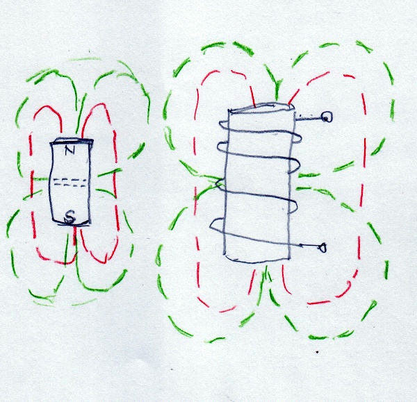

                              Supposing we put the coil and magnet in parallel?
                              Ron
                              • Hi everyone,
                                Well that experiment might have been politically correct but the bottom line is it is not very strong.
                                With a balanced arm and a kitchen digital scale I get 14 grams for the green line and 40 grams for the red line. So the red line wins hands down as that 40 grams is for just about the full width of the coil whereas the green line is just for two tiny windows at either end of the coil.
                                Edit: the secret seems to be the magnet should be as long as the coil... then I get 34 grams
