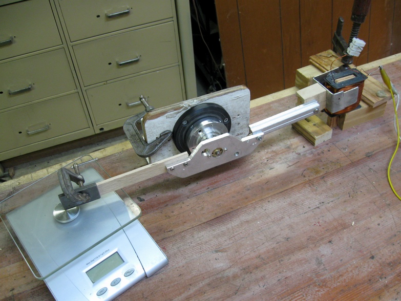

        I will bite the bullet and show my red neck test setup,
        With a single 1/8th by 1 inch neo face on (conventional) I get a pull force of 27 g
        With a small piece of steel behind the magnet I get 31 g
        However what if instead of only using one side of the coil I utilise both sides of the coil?
        (U bracket with two 1/8th x 1" magnets, S S)
        Good move as the force triples... I get 111 g's (grams)
        I had thought to put a coil on each side of a single rotor but discarded that as doubling the watts. Why not instead double the magnets? A double rotor setup, magnets are cheap, and come pre charged.

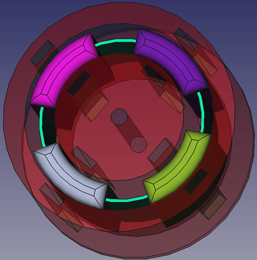

            • Here is a Zero Force Design that I showed JB the last time I saw him...
              • another transparent view
                • That's good RS, as I think two magnets in repulsion is the answer

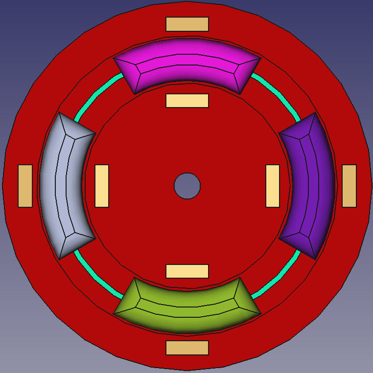

                      I had not thought about opposing magnets in this configuration, I had only thought, that if a N on the inside rotor, and a S on the outside rotor, so that the magnet field flowed through the coil, strengthening the field between the magnets..... opposing magnets would be interesting to test....
                      Yaro,
                      JB did comment, He found the design interesting, but because we had a wrong understanding of the rotor magnets at that point in time(all N out), what little he said is not relevant....
                      I've been wanting to 3D print a small version of this to test, but I have been too busy with the 6 coil and stuff to have the time for this project...
                      This model was designed in FreeCad, and if someone wants to play with it / resize it / 3Dprint it, let me know and I will email the files to you.

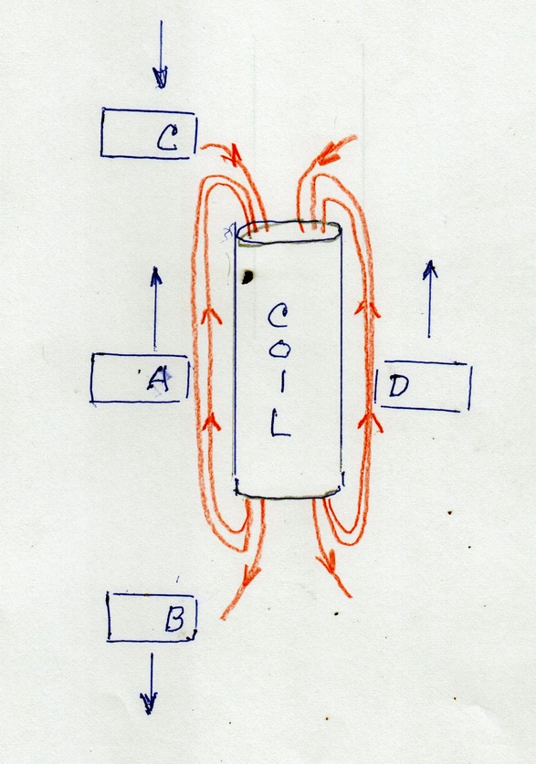

                        How it works:
                        Convention has the flux lines flowing out of the North pole into the South pole.
                        For the magnet (with the right polarity) at "A", it will lock into the flux lines and travel the length of the coil
                        For the magnet at "B", (of the same polarity) it will 'see' the out flow and will be repulsed.
                        For the magnet at "C", (of the same polarity) it will see the inflow and be attracted back to the coil.
                        For the magnet at "D", it must be of the same polarity as "A" in order to travel in the same direction.

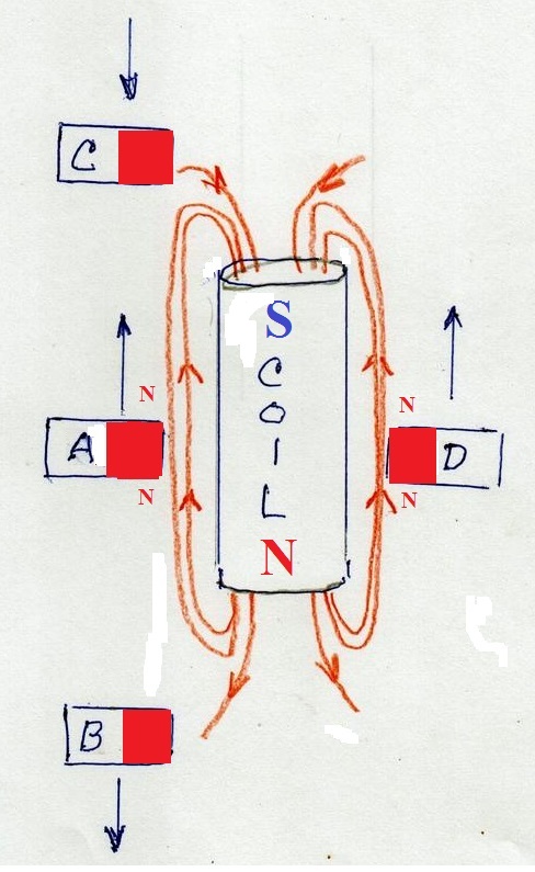

                        I have re-posted the JPG as my good friend Gyula has clarified it with polarities
                        Ron

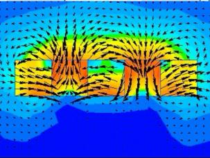

                            Before you move have you considered... The mighty Halbach array? It seems to have many benefits for the zero force motor, especially with the way your coil is pictured in the quote above.
                            Here is what I am talking about... It seems to mesh perfectly with your coil... So many good things to try so little time!
