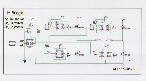

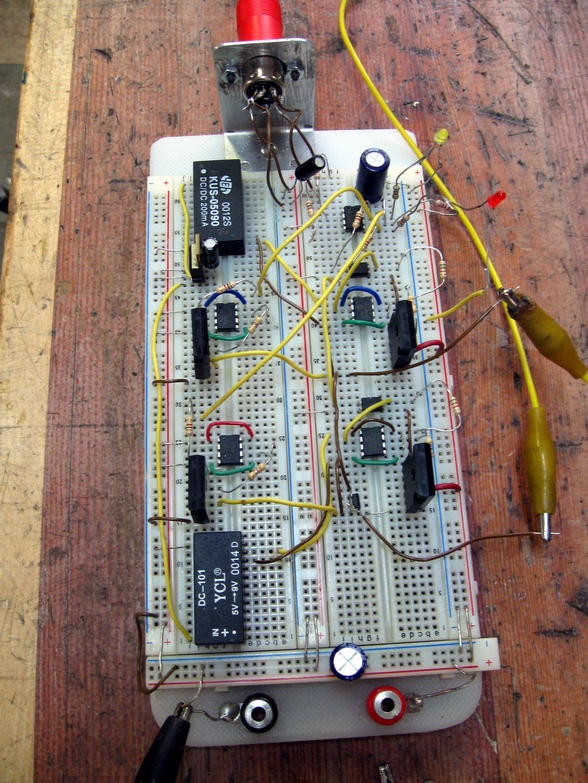

            • Originally posted by Ed_Morbus View Post
              Ron can you post your circuit?
              It is a mosfet circuit, much more efficient than a transistor circuit. As you may know charge pump highside drivers don't do 100% duty cycle. So I have used dc dc converters here but shown in the schematic, labelled as VCC2 and VCC3 These are DC101's and put out 10 volts but anything in that range will work
              Ron

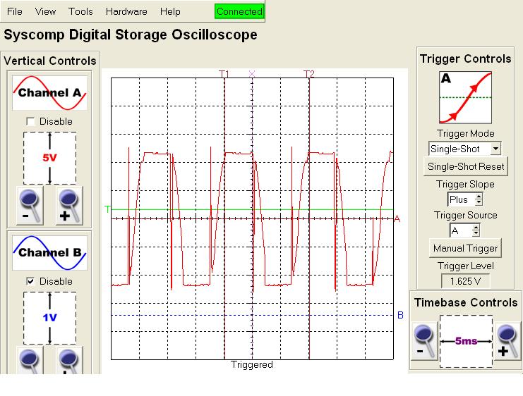

              • Originally posted by Yaro1776 View Post
                Hey Ron,
                Very nice work in putting together the pancake ZFM design. Looking forward to the progress and performance as you go forward with the coil firing modification/position.
                Love the opto couplers integrated into the firing circuit - a step up from the reed switches from a precision perspective.
                Thanks for sharing your replication efforts and Happy St. Nicholas' Day,
                Yaro
                Thanks! yes they do a good job.
                With a wee bit of tweaking it is now running 740 RPM using all of 5 watts
                here is what the pulses looks like...
                Ron

                • Thanks Ron only the schematic is to small and Attachment not working
                  • I will try again
                    but it keeps putting up a thumbnail?
                    R
                    https://s17.postimg.org/o4tmo2snj/Hbridge2.png
