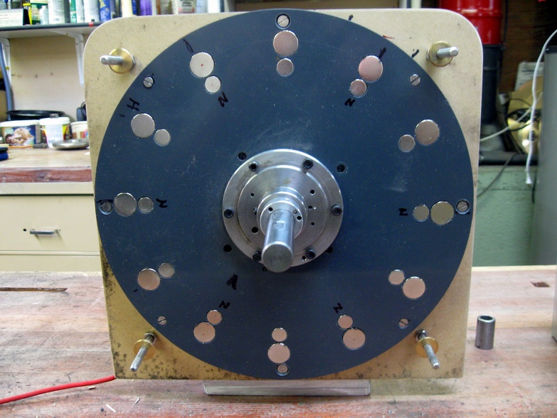

          • Here is my version two. I have gone to 12 magnet stations, N S N S.
            I am only pulsing on the north pole over the coil. When I pulse with the north pole entering the face of the coil the south pole is just entering the gap. So I get the two reactions for one pulse.
            Not that much difference really between version one. Now I get 730 RPM on 12 volts but only 250 mA.
            But this one allows me to run at 24 volts in which case I get 1300 rpm at 500 mA, a real improvement.
            Ron

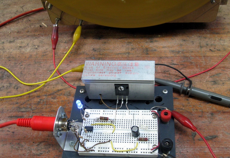

            • It really simplifies the electronics without an H bridge. Just an opto driving the TC4427 driving the mosfet.
              I am using a TVS across the coils, which are now in series parallel.
              Ron
