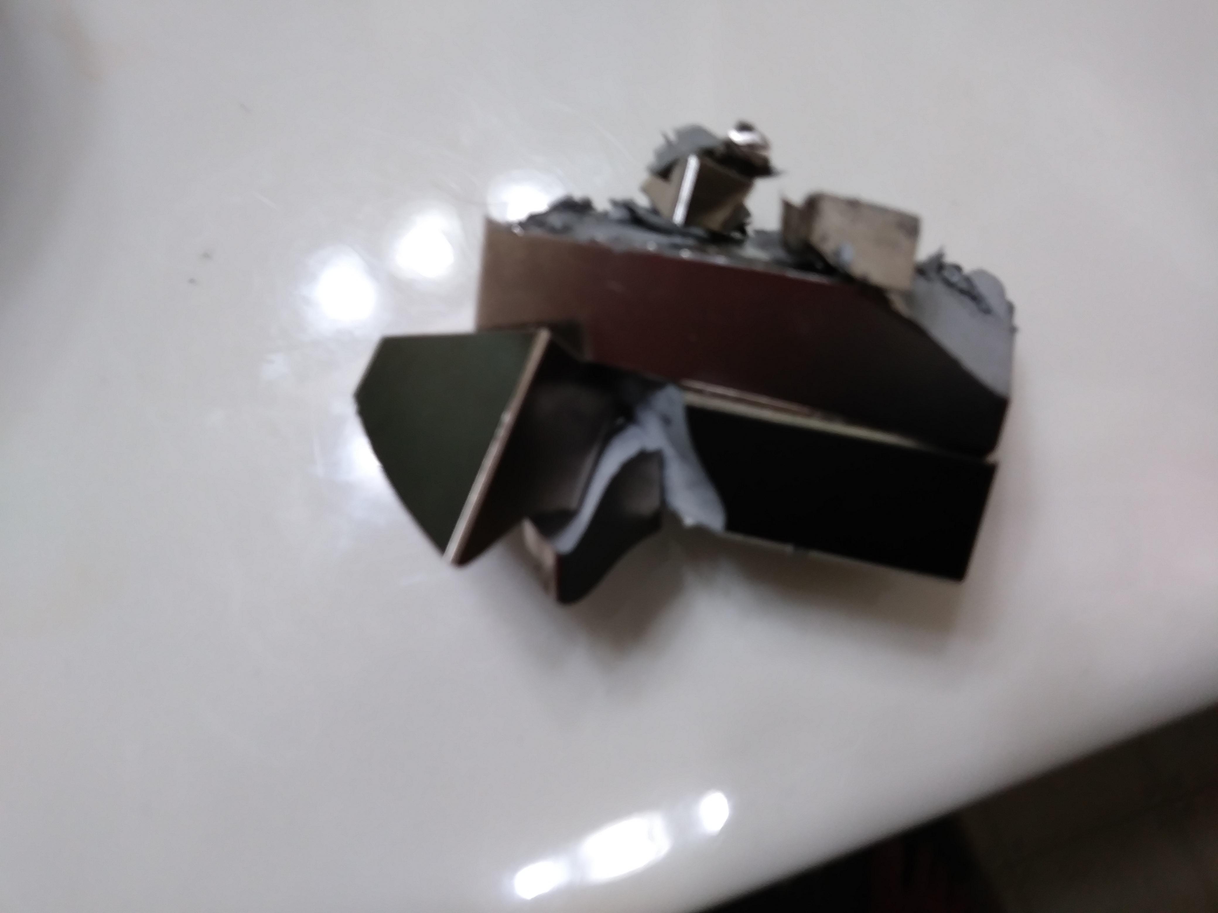

                        • Originally posted by John_Koorn View Post
                          Great results there James! Looking forward to a video of the improved setup, if you have time.
                          Just a word of warning when working with neo magnets. If they break, be very careful not to cut yourself with the shards or broken bits. I did this once and felt sick for a week, some sort of poisoning.
                          Hi John --
                          The attached picture is the damage caused when one magnet flip up off the rotor and crashed into two other magnets before
                          the rotor abruptly stopped with the magnets all mashed between the rotor and the coil.
                          -- James
                          • Yoiks!
