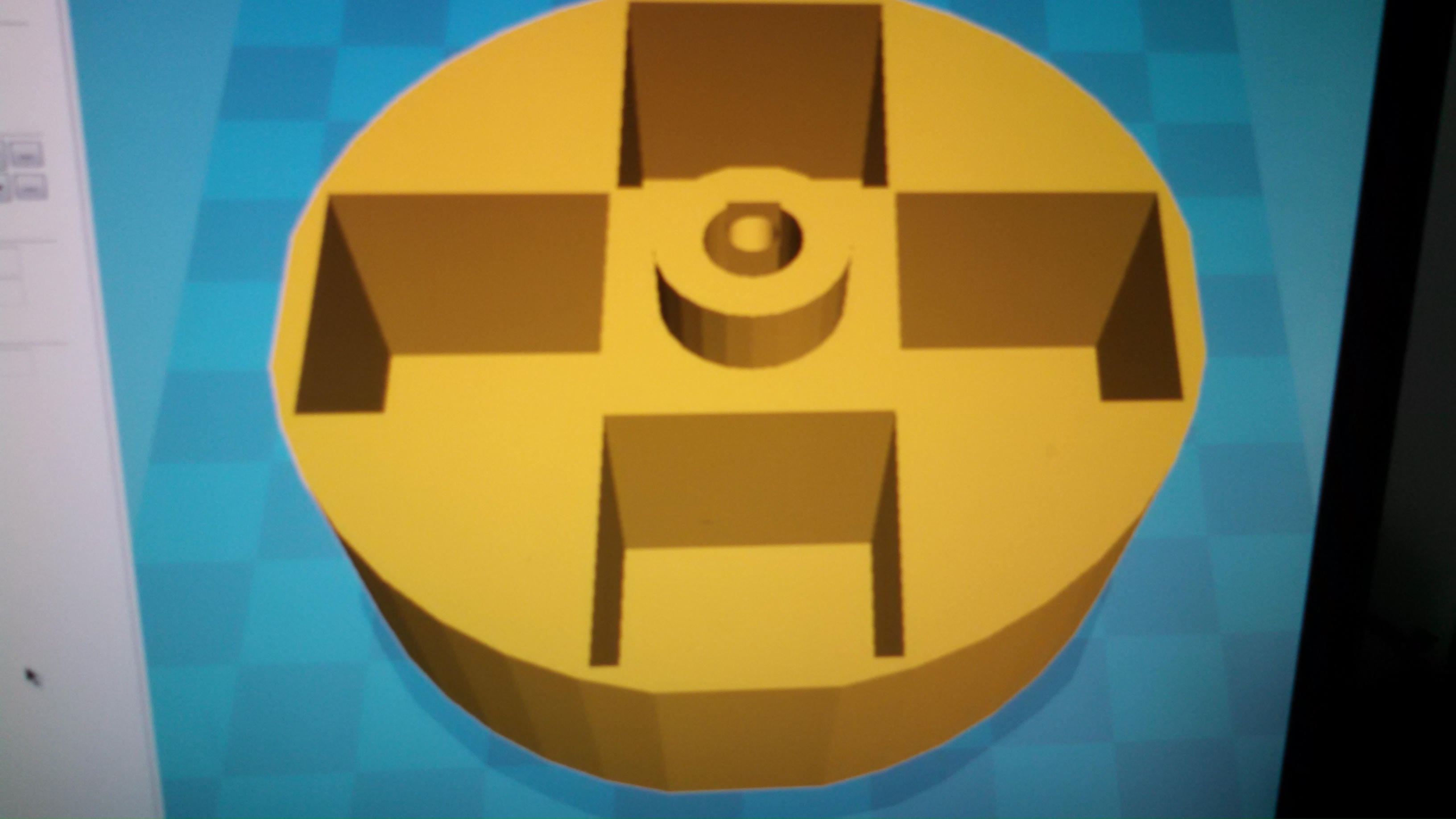

        The new rotor is listed with 3/4" X 3/4" slots. Click image for larger version
        I had to add some meat on the bottom to hold it together good. You can see in the pic that the 3/4" squared slot left only a little room for plastic in spots.
        Mann

          Dmann and others,
          I do not know the specific material specifications for the 3D plastic, however I will caution you on the the forces developed by the Neo's weight at high RPM's. The AL rotor was initially designed to retain the the Neo's easily up to 15,000 RPM and more. The 3/4"Dx3/8"T Neo's will produce a radial force of ~320 lbs each at that RPM - if the Neo's are increased in size to the 3/4" square/cube configuration for the given motor rotor of 2.5"D, well you better figure that each Neo is waiting to be launched with about 700 lbs. of force.
          So a word of caution is expressed here in that the RPM should be limited by starting out at a low input voltage of 12v and slowly working your way up. It is a given fact that increasing the power of the Neo's will increase the RPM for a given input voltage. This was observed when the AL rotor Neo's were increased from 1/4"T to 3/8"T and the grade from N40 to N52.
          It would not be surprising to see the ZFM accelerate at maximum voltage to well over 15000 RPM and much more with the larger Neo's. Be aware that the centrifugal force here is a function of the square of the velocity (RPM).
          Tread carefully and test responsibly - we still be in no man's land,

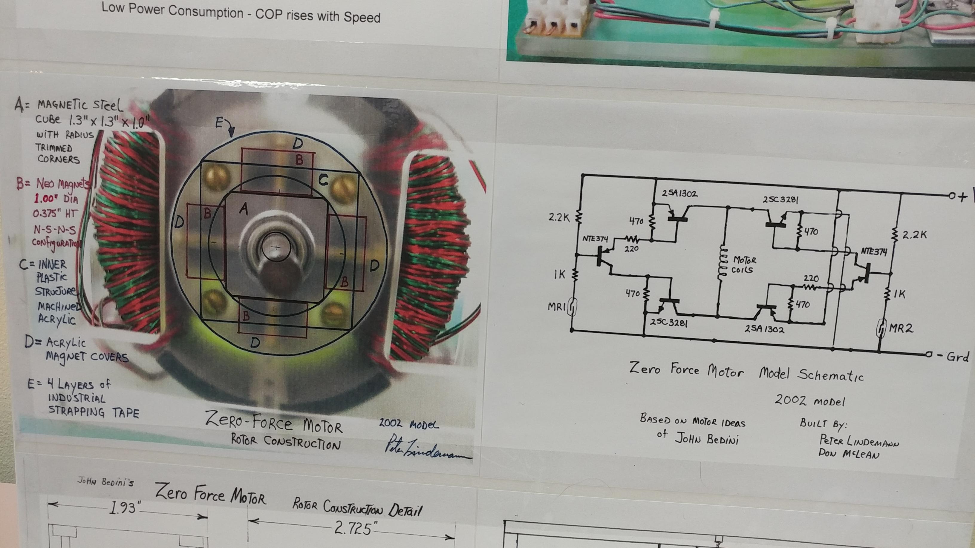

                      Peter had an important update on the physical spec's for the iron rotor and motor Neo's. The motor Neo's are increased to 1"D x 3/8"T and the square iron rotor to 1.3" per side with a 1" length. Check out the attached photo. This update is very useful and I have already sent one my rotors to the machine shop and ordered the 1" Neo's. Expect to have some initial test runs and data in August. The torque of the PL ZFM is significantly greater than the McD and Yaro ZFM's that use a 1.2" square rotor and 3/4"D x 3/8"T Neo's (YZFM) with 3/4"D x 1/2"T (McDZFM). Also attached is a pic of the ZFM Builders at the conference - left to right James, Peter and Yaro.
                      Also presented were o-scope screen shots of the ZFM coil voltage cycle that show a small Lenz effect - I anticipate that James McD will post and elaborate in more detail on this in the near future.

                        The PL ZFM from 2002 was demonstrated by Peter using his variable DC voltage power supply. Very slick setup that removes the batteries from the equation, yet allows enough amperage to drive the ZFM up to about 60v. The PL ZFM draws a relatively constant 0.4 amps when it is running at speed. As the speed increases with greater voltage the amp draw remains relatively constant, however the old two finger torque test will increase the amp draw as the RPM drops off. Very impressed with this model's torque, bearing in mind that the shaft diameter is 3/8" in comparison to the 1/2" shaft on the other two ZFM's. I believe that the machine was pushed to over 12,000 RPM before an internal clamping bolt came loose, it was later repaired by Peter. Peter stated that he has had the motor up to 14,500 RPM.
                        The basic arrangement for this motor is about an 18 degree advance and 60 degree firing dwell or duration as I recall, different from the original 10-15 degree advance and 45-50 degree duration. The Bipolar switch circuit board stayed cool during his demonstration. Peter also modified the timing wheel adjustment to allow fine tuning tweaks to the advance.
                        The McD ZFM was operated at various DC voltages up to the high 50's. His new Bipolar Switch board held up to the voltages and ran cool, no issues. I believe that the maximum RPM was close to 9,000 - no amp data since the clamp-on meter was left in the shipping box in the Conference room. Aaron provided some three AGM 35Ah deep cycle batteries that worked very well when connected in the 36v series loop. The prolonged run times during the conference did not impact the original standing voltage of 13+v very much.
                        The Y ZFM operated, after tweaking, at about 11,400 RPM with an amp draw of 08-1.0 at 36v. About a 65 degree firing duration and 40 degree advance. When the later acid test of max voltage of 60v was applied the machine cranked up to ~13,400 RPM, no issues here, missed the amp draw read. As mentioned in the previous post there appears to be a performance wall as the voltage is increased with the RPM not increasing as much as anticipated. The reed switches are being stressed at this RPM where they are firing at well over 400Hz, way over the recommended maximum operating spec for these particular reed switches.
                        So the take aways here are as follows: The magnet size should be 1"D x 3/8"T for maximum torque development and speed, the reed switches or some other factors are limiting further speed gains and the variable voltage power supply removes the need for multiple batteries for higher voltage testing. All is good!
