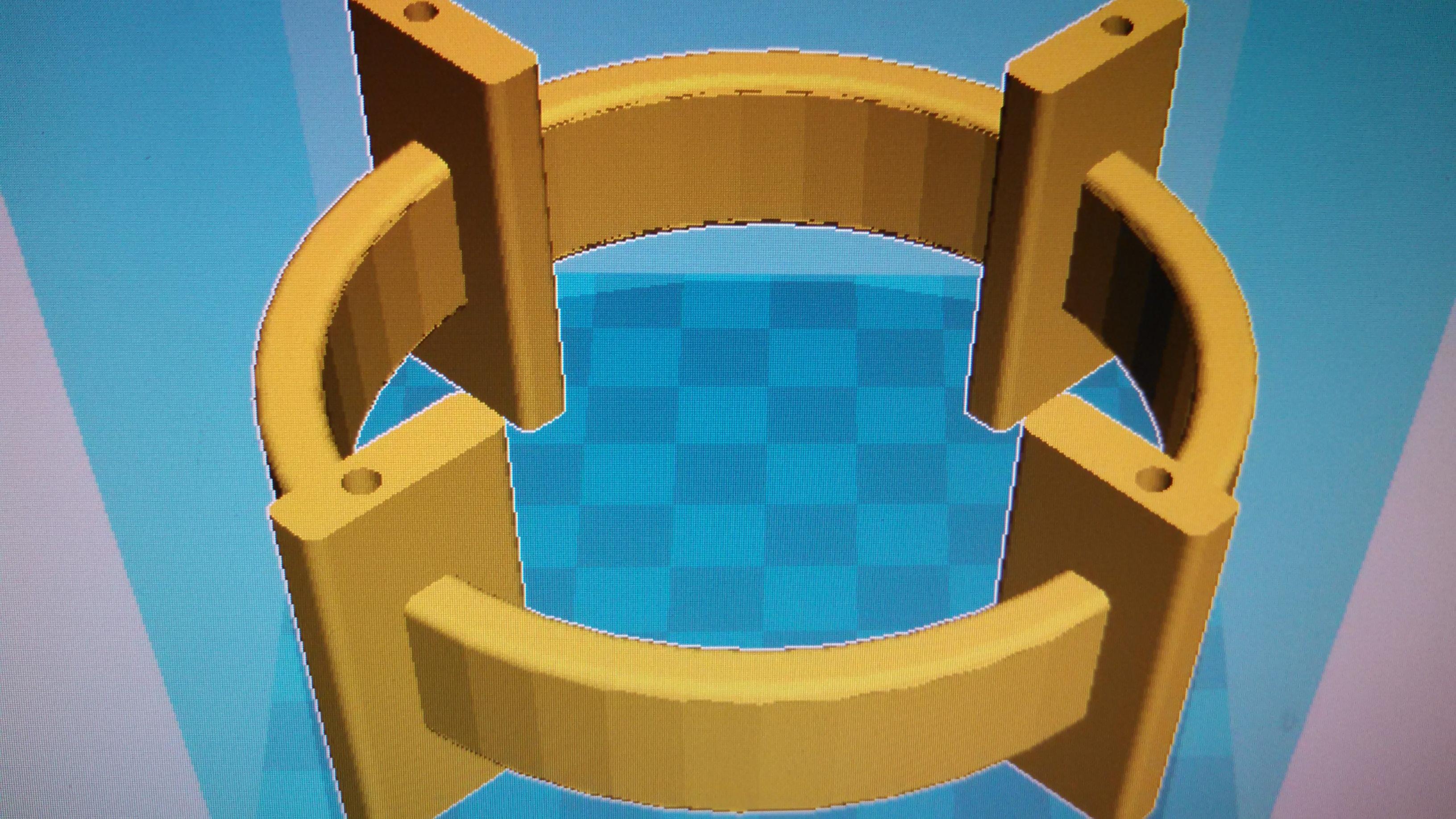

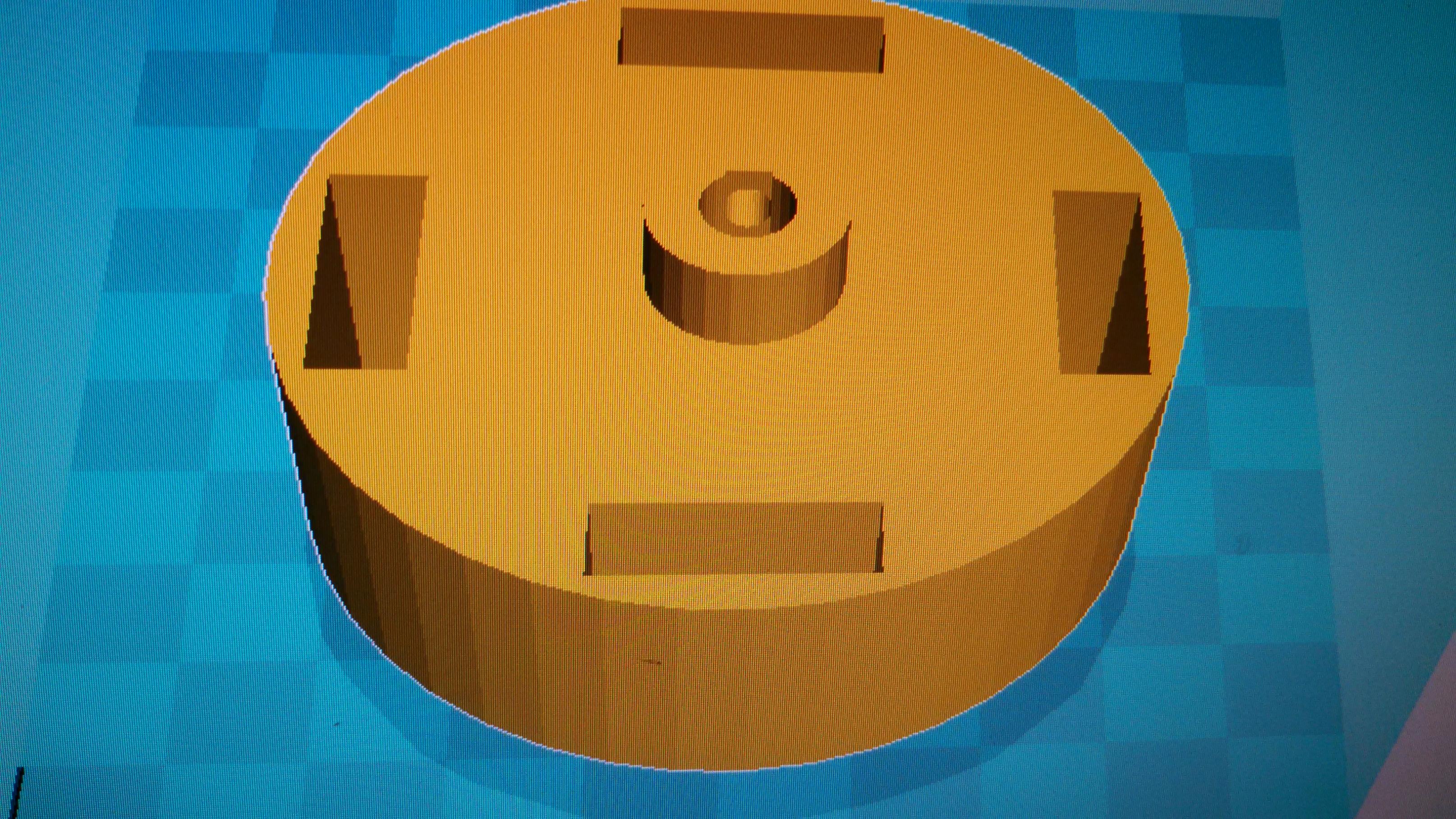

        • The Zero Force Motor Attachment was added to Thingiverse: http://www.thingiverse.com/thing:2149756 This part should replace the window motor parts in the middle of :http://www.thingiverse.com/thing:2149044 The rotor is 2.5". It is made for 3/4" X 1/4" disc magnets.
ID:	49367Click image for larger version
          Enjoy
          DMann

            DMann - good looking design that should work well. What are you recommending for retaining the Neo's in position in the rotor?
            Thanks to you for the 3D effort,
            Yaro
            Yaro
            • Hey Yaro. A light amount of high expansion glue such as original gorrila glue should work just fine. I don't use anything though. It is a tight fit with my print settings.

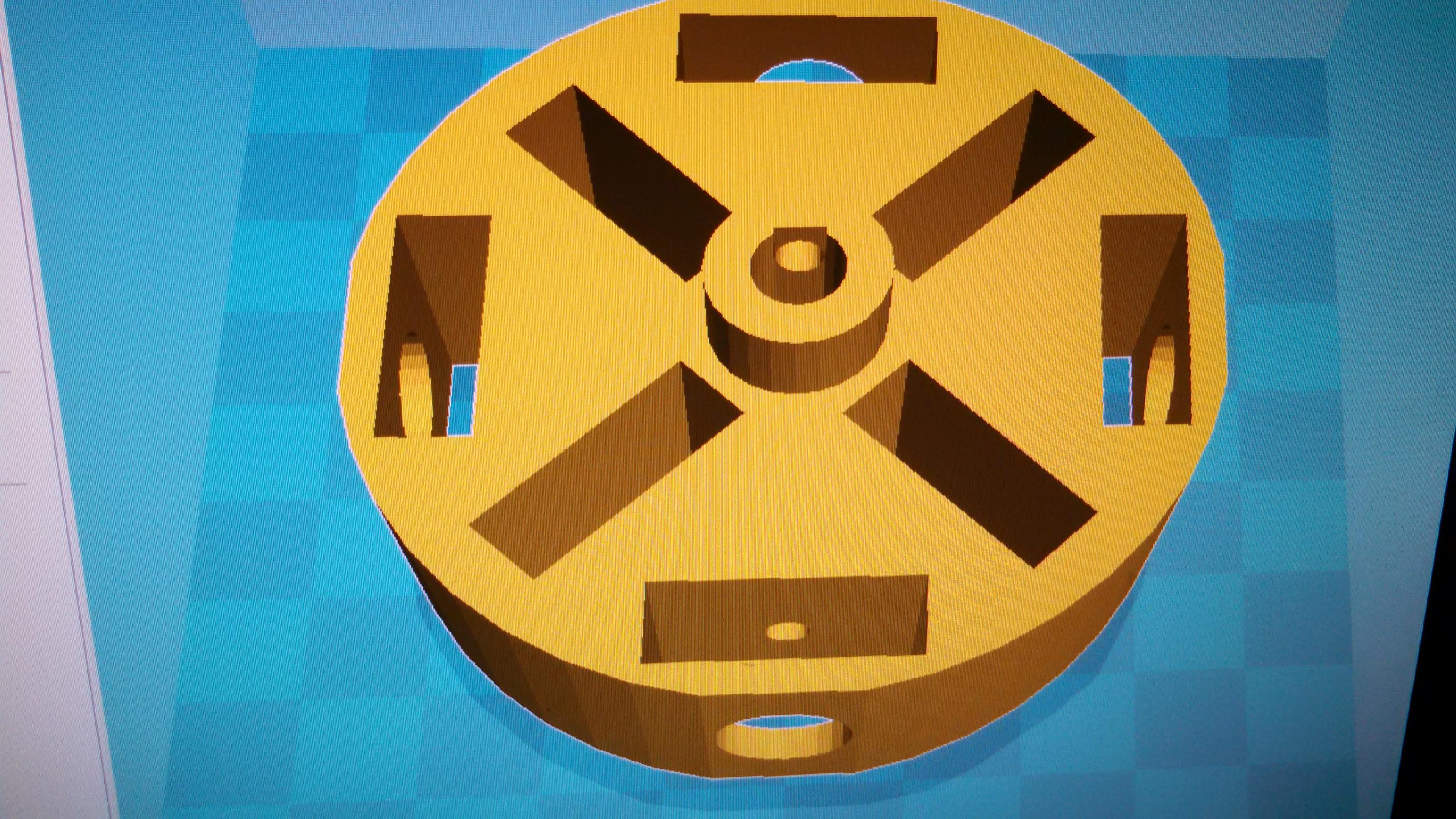

                Those are great - what about some cutouts in the rotor to insert iron slugs? The way you have the slot of the magnet, if you made a T where the perpendicular cutout goes from the magnet towards the shaft, it would perform as an iron keeper, which is what John always used. It would also add a bit more weight to the rotor for some flywheel effect.

                  • I added this revised ZFM rotor to the file. It is a bit more complex. But I think it will give you what you are looking for. Thanks for the suggestions. Click image for larger version
                    or
                    Both will take a #6 bolt. I made the hole toward the shaft .6" so a .5" long bolt should work.
                    Added the slots for balancing. They will fit the .75" X .25" mags as well if you want to experiment with that.
                    Enjoy
                    Mann

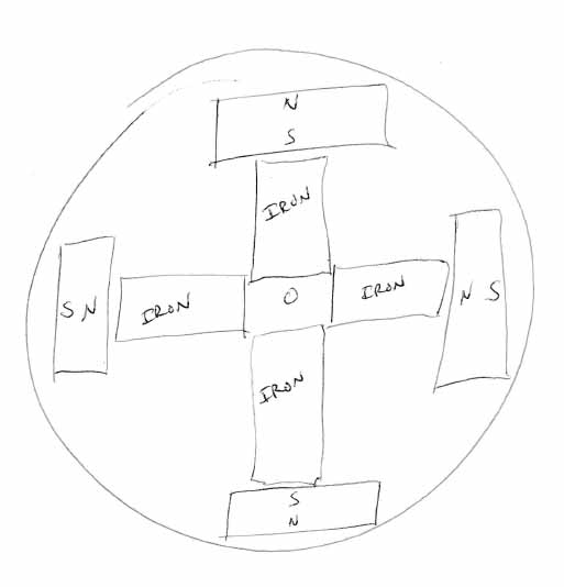

                        That's almost it - if you lave the magnet holes like that, but rotate the keeper holes 45 degrees so they actually make a T with the magnets, then the iron pieces will literally hold the magnet field from the magnet face on the axle side. I don't know if there are simple iron pieces of standard sizes that can be put in but this is the idea anyway. The model Peter built had the square iron with magnets on each of the 4 sides and Bedini's original ZFM's all had an iron keeper with 2 magnets 180 degrees from each other, but in all cases, the magnets were intended to have an iron keeper. Although in the 3D print idea, the axle end of the magnet keepers won't physically touch, they're still providing a path for the magnetic flux.

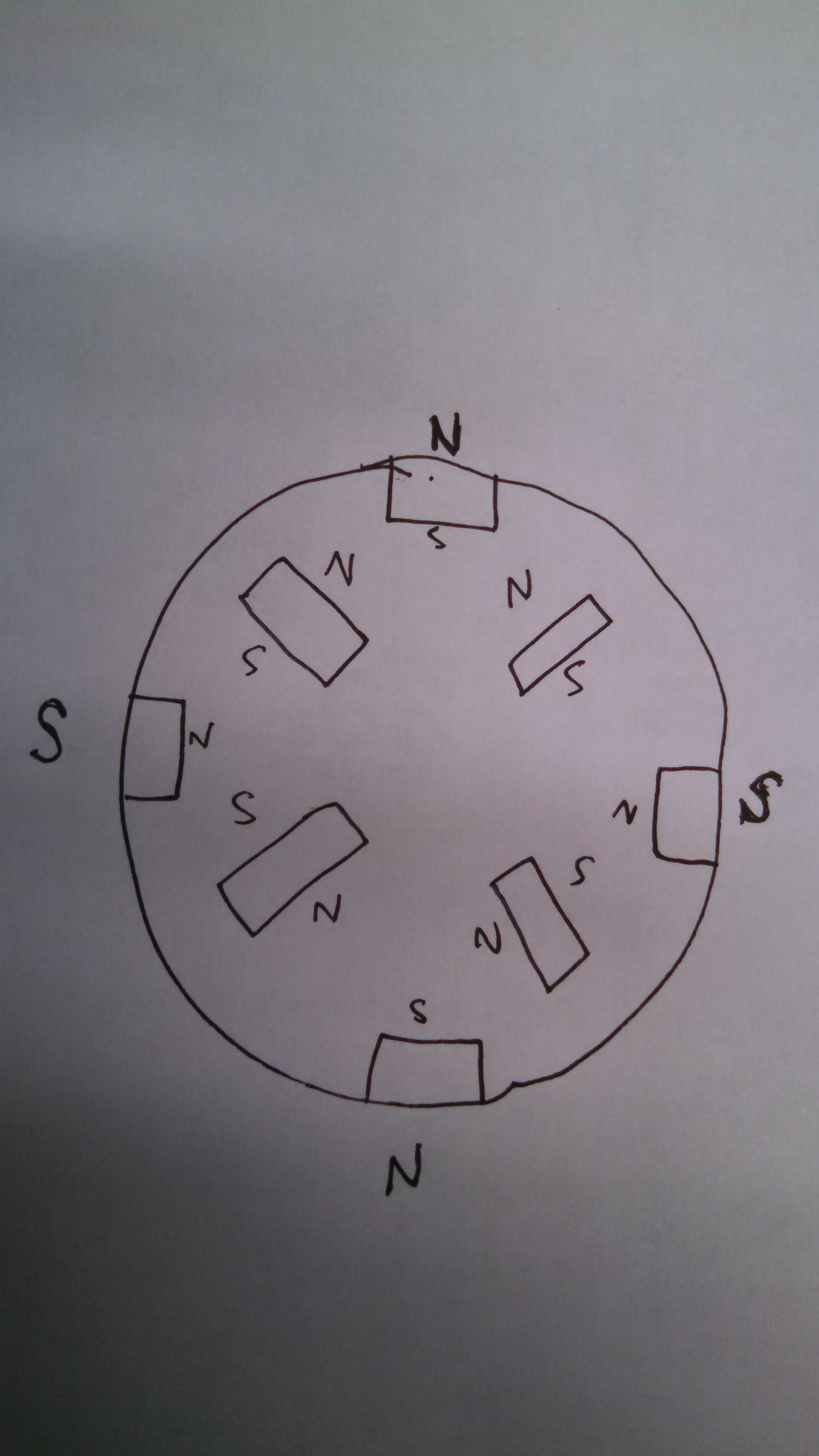

                          Can you illustrate what you are describing? This is what I was thinking and what I did on the Window Motor rotor. Click image for larger version
                            What you just drew there is interesting - those inside magnets might actually retain the flux like an iron keeper since it pulls in the bottom facing field of the outside magnets, which is part of the point to the keeper. But not sure of how some of the coil flux will be diverted through the rotor.
                            Here is what I was meaning:
                            Of course like I mentioned, not sure if there are standard size little iron stock pieces that can be inserted into some standard sized slot. Maybe stacks of washers or something as long as they're magnetic.

                                I'm thinking 5/8" round stock. I can expand the magnet set screw hole up to 5/8" to be used for the iron piece. Another option would be just to make a slot for a bigger magnet. A 3/4" X 3/4" cylinder magnet would fit. I can design whatever just let me know. It will be Monday night before I will be able to do anything. If you draw a design on paper and post a pic, I can see what you are describing. If everyone agrees on the "T" I will do that, but understand that you will only be able to fit about a 3/4" X 1/2" piece of iron in that spot.
