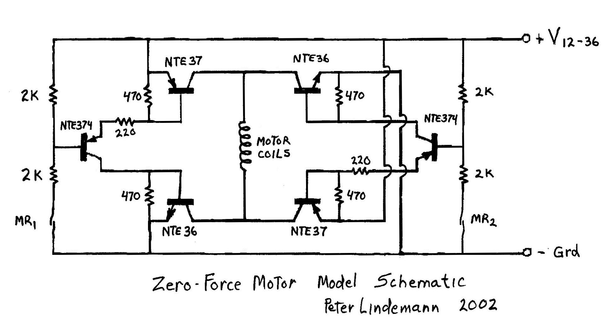

Hi Patrick,
Great suggestion from you to use half of the circuit for tuning purposes. Posting the two circuit schematics is helpful to everyone that has an interest in the ZFM.
By the way, the motor will self start when power is applied.
