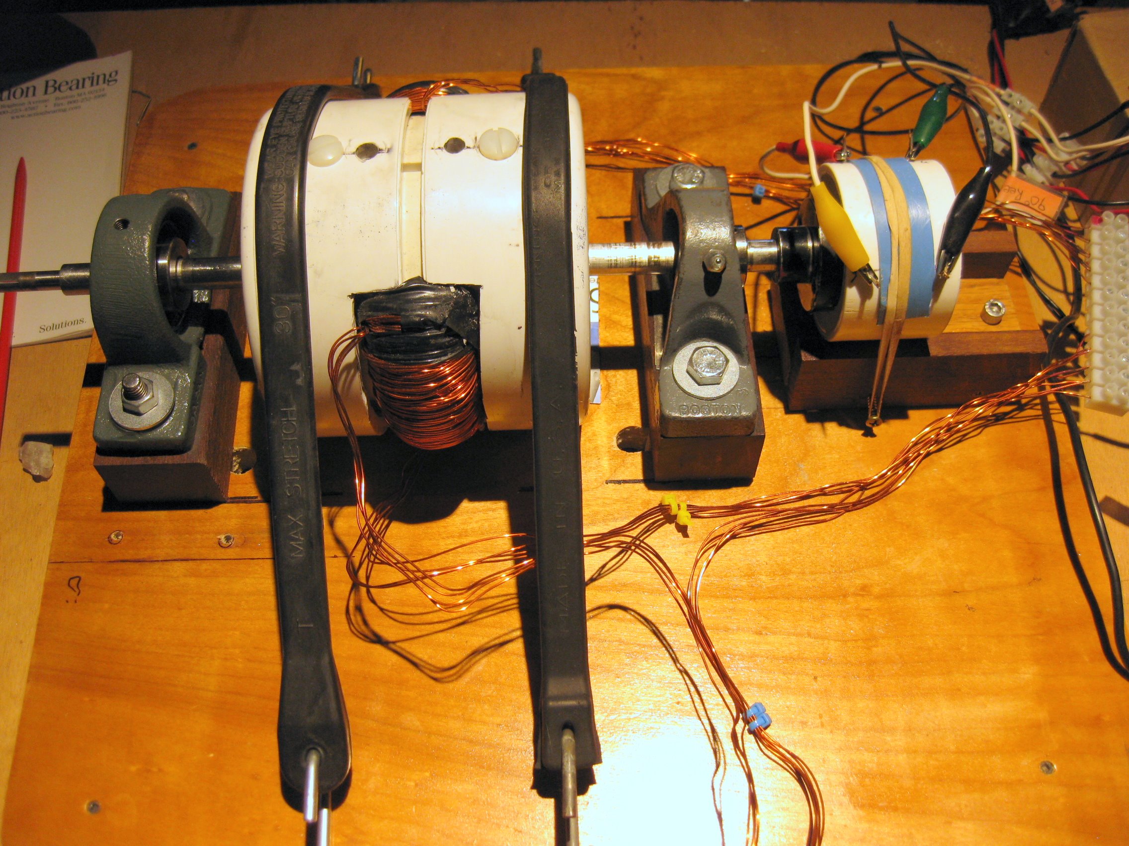

    The first step taken was to modify the motor by removing all the stainless steel fasteners (Cap screws) and retaining straps, and replacing with nylon bolts and using EPDM bungee cords for motor positioning and retention. The pillow block bearings were remounted further away from the motor body as suggested by others. The major modification involved replacing the earlier 3/4"Dx3/8"T Neo's with 1"Dx3/8"T Neo's. The timing rotor Neo's were reconfigured to a NS arrangement from the initial NN arrangement. These several simple modifications stabilized the performance of the motor and produced a consistent behavior that yields well over 10,000 RPM at 0.62Amp and 36v.

    The next post will explore varying the axial position of the Rotor Neo's with respect to the centerline of the coils. As always, questions relevant to the thread will be answered as time permits.

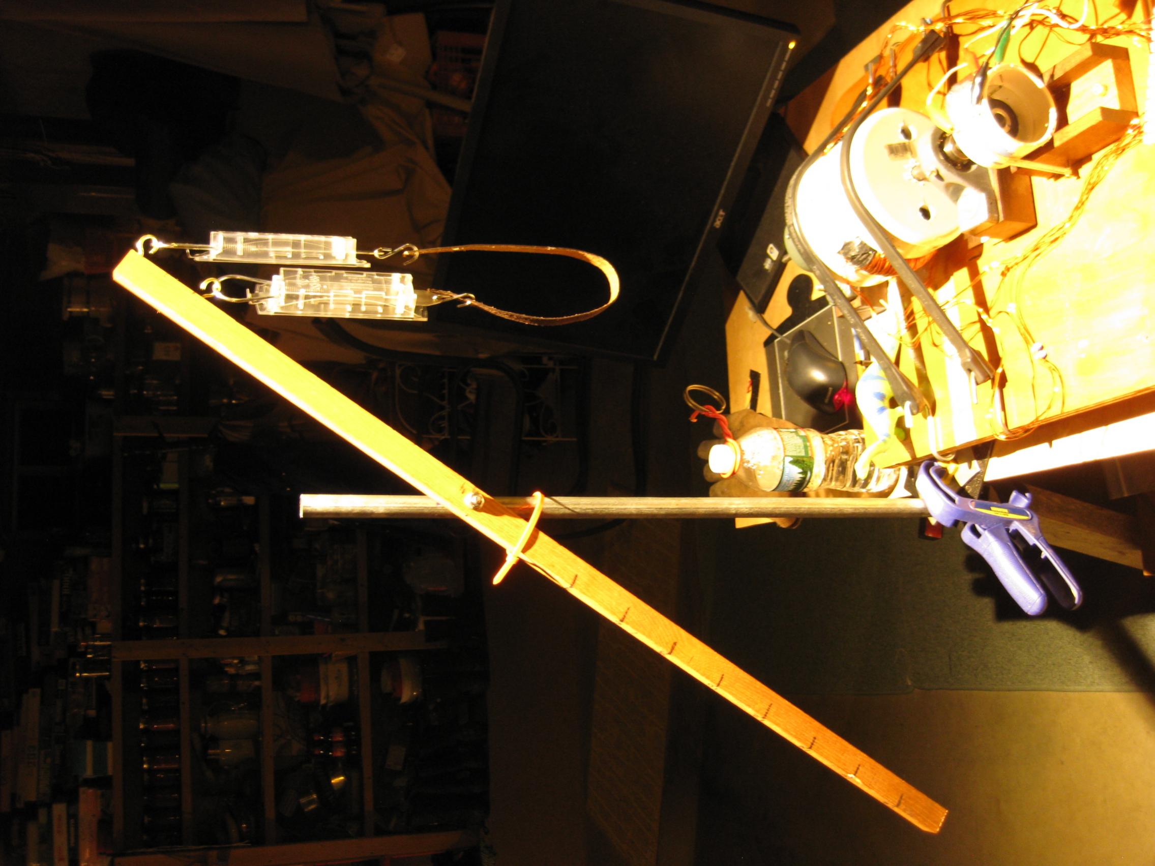

      The Torque testing apparatus (pic below) was built from easily obtainable parts. The vertical support - electrical conduit (0.600"ID) 2 ft. length, (1) Horizontal lever arm - about 3 ft. of 1"x3/4" hardwood or equivalent, (1) 3/8" expandable anchor wedge, 2"Lx3/4" bolt, (1) 4-1/2" steel angle bracket, (2) very small hooks, (2) O'Haus 1000 gram Spring Scales (Davis) and a (1) 1/4-20x 2 1/2"L bolt and nut.One soft leather belt with a rough side. Cut to length desired and punch holes, abrade the area of shaft/pulley contact. Hang weights on lever arm - water bottle works fine.
      Assemble by driving wedge into the conduit flush. Drill a 3/8" hole in the center of the angle bracket. Drill 1/4" hole in conduit about 20'-22" from wedge end. Bolt bracket into wedge and assemble torque apparatus. Clamp to table edge. Go play!

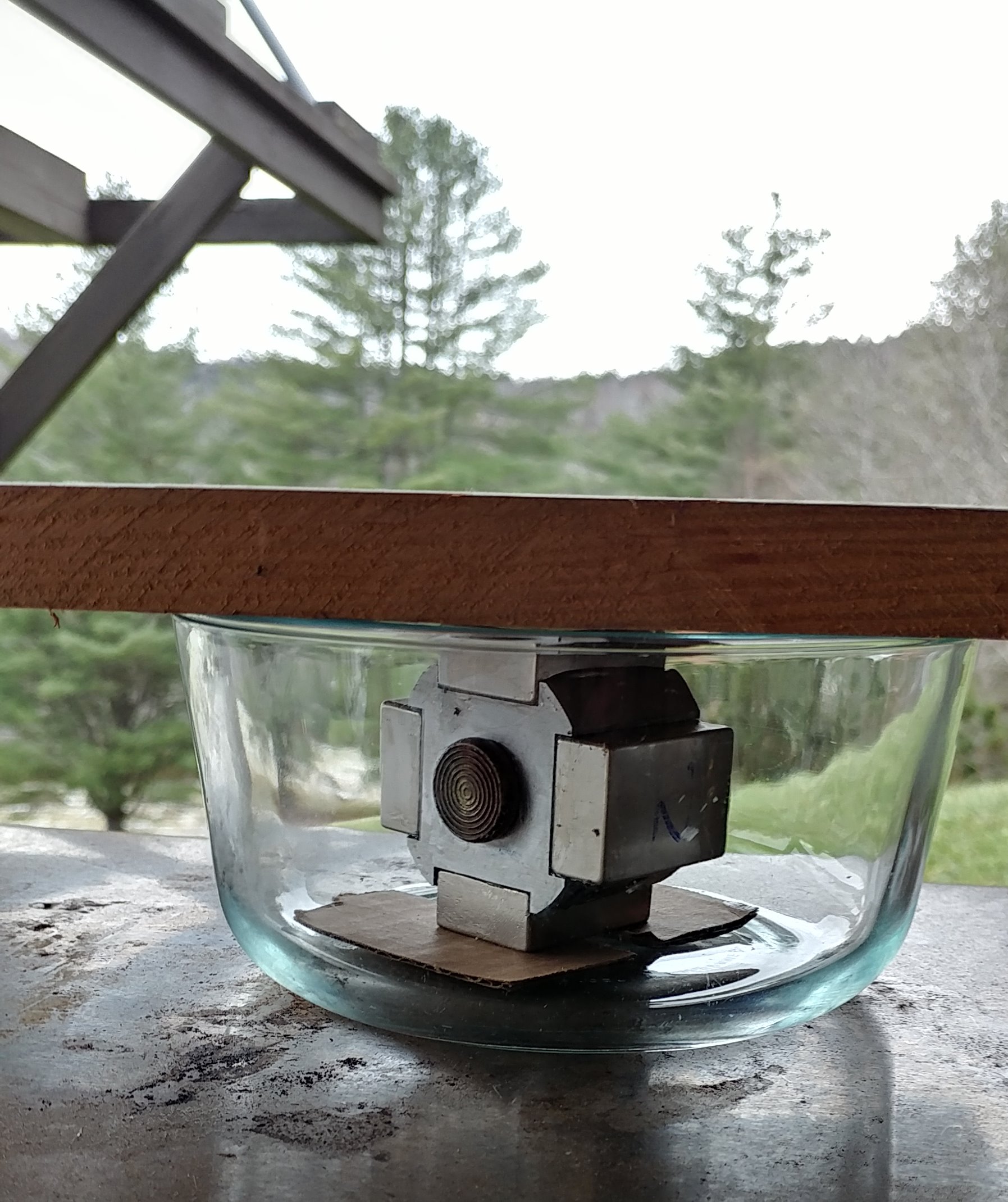

        The next step with the YZFM was to machine an 1-1/2" long Aluminum rotor to be outfitted with a 3/8" thick Neo in keeping with the experimental progression. Not to be, the search for this thickness with a 1-1/2"Lx1"W was unsuccessful and a 1/2"T Neo was substituted. The prior testing and anecdotal testing strongly suggested this would improve the torque of the ZFM.
        The big Neo's are a handful and require focused attention for proper assembly. For ease of assembly the Aluminum rotor had a 1/2"Dia steel pin inserted through the center. The Loctite 332 structural adhesive was used for attaching the Neo's to the Al rotor. The first Neo was simple to position, however the opposing Neo was more challenging - hence the steel pin and this helped. After attaching the first set of Neo's the assembly was clamped is a wooden vice. The next two Neo's were installed very carefully using wooden shims to slide into position. Another wooden clamp was used on these Neo's and the assembly allowed to sit for about an hour before curing - temp in my outside work area was a balmy 29F.

        The rotor assembly was placed into a Pyrex bowl and covered, then wrapped with a towel for insulation. This was set on the Barbeque grill and heated so that the internal temperature was 130F-140F and then cured for about 3 hours. Bear in mind that the maximum recommended temperature for the Neo's is between 170F-180F. Exposure to higher temperatures will degrade the magnetic capability of the Neo. The final step was to wrap the rotor with three layers of fiberglass shipping tape after mounting and positioning on the shaft.
        The motor was proofed progressively at higher speeds and voltages (12v, 24v, 36v and 48v). Immediately obvious that the timing and dwell needed to be modified with the new rotor. The FA (firing angle) was reduced to 50-55 degrees and this helped immensely. The advance adjustment has become much more sensitive over the prior rotor.
        Anyway, the motor definitely has more torque and will still achieve the same speeds as the prior assembly at 36v, albeit with a greater amperage draw. The bottom end torque is impressive, particularly at 48v.
        So for no load 36v; 10,186 RPM at 1.16A, nearly double the prior rotor. Okay let us look at an example of the developed power, but at a more working and useful RPM.
        Small rotor 5,099 RPM at 1.16A; output 9.98 watts with a 300gr load - efficiency 23.84%
        Large rotor 5,111 RPM at 1.60A; output 14.64 watts with a 440gr load - efficiency 25.41%
        The above results demonstrate that the modification of the rotor/Neo length to equal the coil width has great merit. The 48v testing has shown the same type of result. The larger rotor has a very obvious quirk at higher speeds for both of the higher voltages. At about 85-90% of max RPM there is a sudden major acceleration accompanied by about a 10% increase in amperage draw. First time is a bit unsettling, particularly at 48v, when the RPM jumped to 12,700 RPM.
