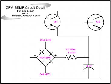

    Hola to all,
    During Ron Cole's association with John Bedini a number of very interesting motors and control circuits were produced. This collaboration yielded the BiPolar Switching circuit (depicted in prior post) and other enhancements. One of the enhancements was the adder circuit to collect the "Counter EMF" as described by Cole. A better description may be that the terms are not that well defined. It appears, at least to this writer, that the circuit may just be collecting the extra potential created by the inductive collapse upon the removal of power from the coil circuit before the polarity reversal - correct me if I am wrong here. So, it may not be a true BEMF recycling circuit, but an inductive spike collection method. The semantics here can be rehashed by others and corrected as need be. Of more consequence is the impact on motor performance.
Name:	R Cole CEMF.jpg
ID:	50089 Click image for larger version
    The additional circuit is essentially a diode bridge, whose sole purpose is to collect this collapse of potential during coil power off and to transform it into a usable form that can be injected back into the ZFM's coil power circuit. All in all, an interesting conjecture. Question is whether this does indeed work and, more importantly, can it be used to jack up the performance of the ZFM??

    It is of interest that in Parallel mode the 2 wire output from the Cole circuit was 2 to 4 volts higher than the combined input voltage from the Bipolar switch - for a 24.5 V power supply voltage, the total coil voltage potential would equal 49.0 volts, but the Cole circuit output would read 52 volts. This split output was fed into the transistors.
    BTW the function of the 4uf capacitor in the circuit is to smooth out the voltage speed bumps, I believe that a higher value would provide a bit more smoothing. Not sure what the function of the balance resistor is at this time.

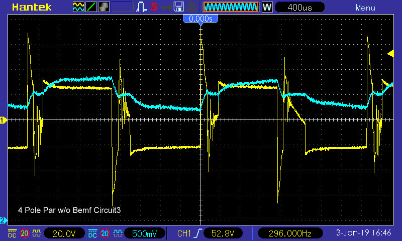

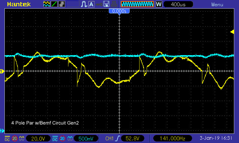

      Greetings to all,
      The last post presented preliminary data and performance of the ZFM utilizing the R Cole CEMF circuit. Inserted below are four pics that depict the oscope graphs for Voltage (yellow trace) and Amperage (blue trace) under a no load condition. The timing here is ~55 degrees advance from the coil end/center of the rotor Neo interface. The ZFM is being powered by 2 LAB's in series for both consecutive test configurations. These tests are in Coil Parallel mode.

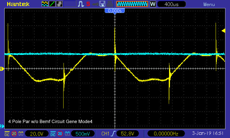

      The first pic is of the Parallel run without the CEMF circuit at 24 volts at 8800 RPM and 1.70A, while the second pic depicts Gen mode when the power is removed from the ZFM circuit. The Gen mode trace is in actuality the motor's BEMF and the maximum voltage is about 20v. The BEMF trace is a relatively regular wave pattern.
      You will note in the first pic that the inductive spikes upon removal of power hit nearly 70 volts.

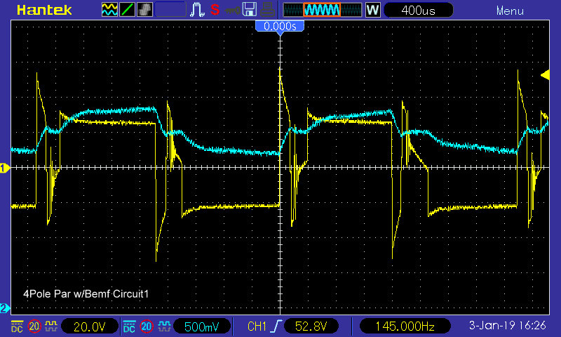

      The third pic displays the Parallel run w/ the Cole circuit at 24 volts at 8800 RPM and 1.67A, while the fourth pic presents the BEMF graph. When the Cole CEMF circuit is activated the major voltage spikes during operation are reduced to a maximum of about 55 volts. The remainder of the graph appears very similar to the w/o CEMF pic. Now the last pic of the BEMF trace is radically different and demonstrates the impact of the rectifier bridge and the 4uF capacitor. Certainly this can be further smoothed by raising the value of the capacitor.
      In conclusion the very tight gap between the rotor and coil along with the stronger Neo's does markedly improve the torque characteristics of the ZFM. The most recent tests in series mode clearly show that the ideal advance for the motor ranges around 45 to 50 degrees. A test run on Feb 7 at 24 volts showed the torque curve to be stable from a no load speed of 4500 RPM at 0.58A down to 2100 RPM at 1.57A with a 615 gram load. Nominal efficiency output/input of 26% without the CEMF circuit (New Bipolar Switch board is on its way).
      Increasing the voltage to 36v will improve the torque and efficiency to 30%. It has been demonstrated that efficiencies of over 40% can be achieved with various timing, rotor and Neo configurations for the Twin coil 4 Neo rotor ZFM. The total impact of the Cole CEMF circuit, from the small test sample, appears to add about a 10% performance improvement.

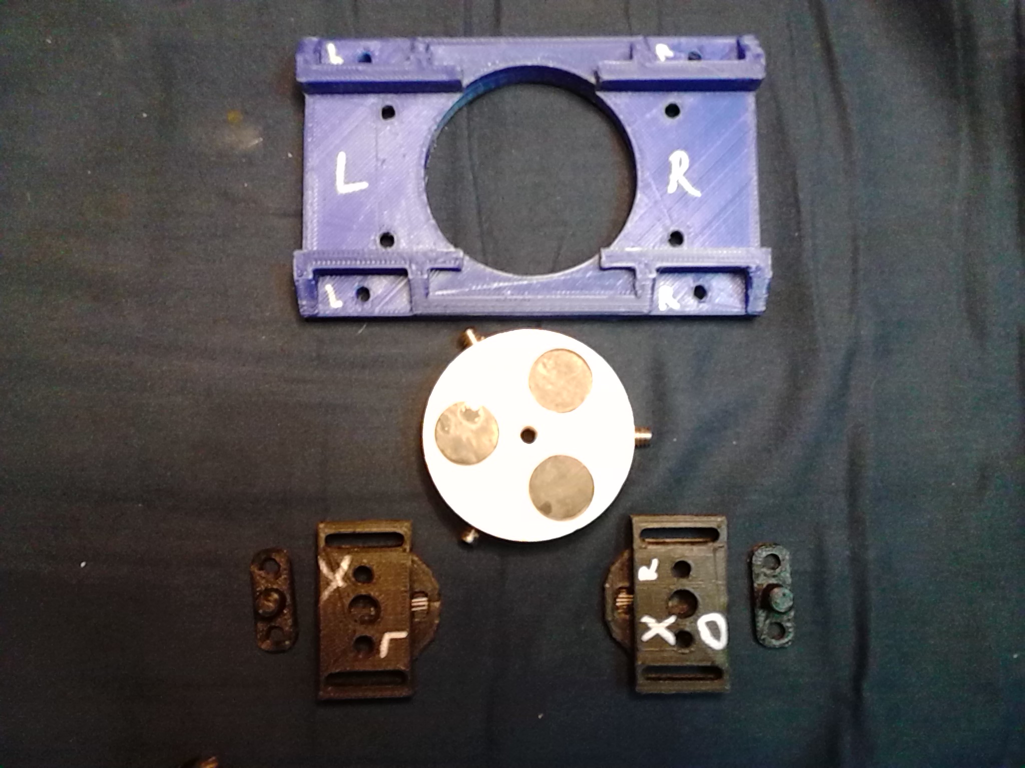

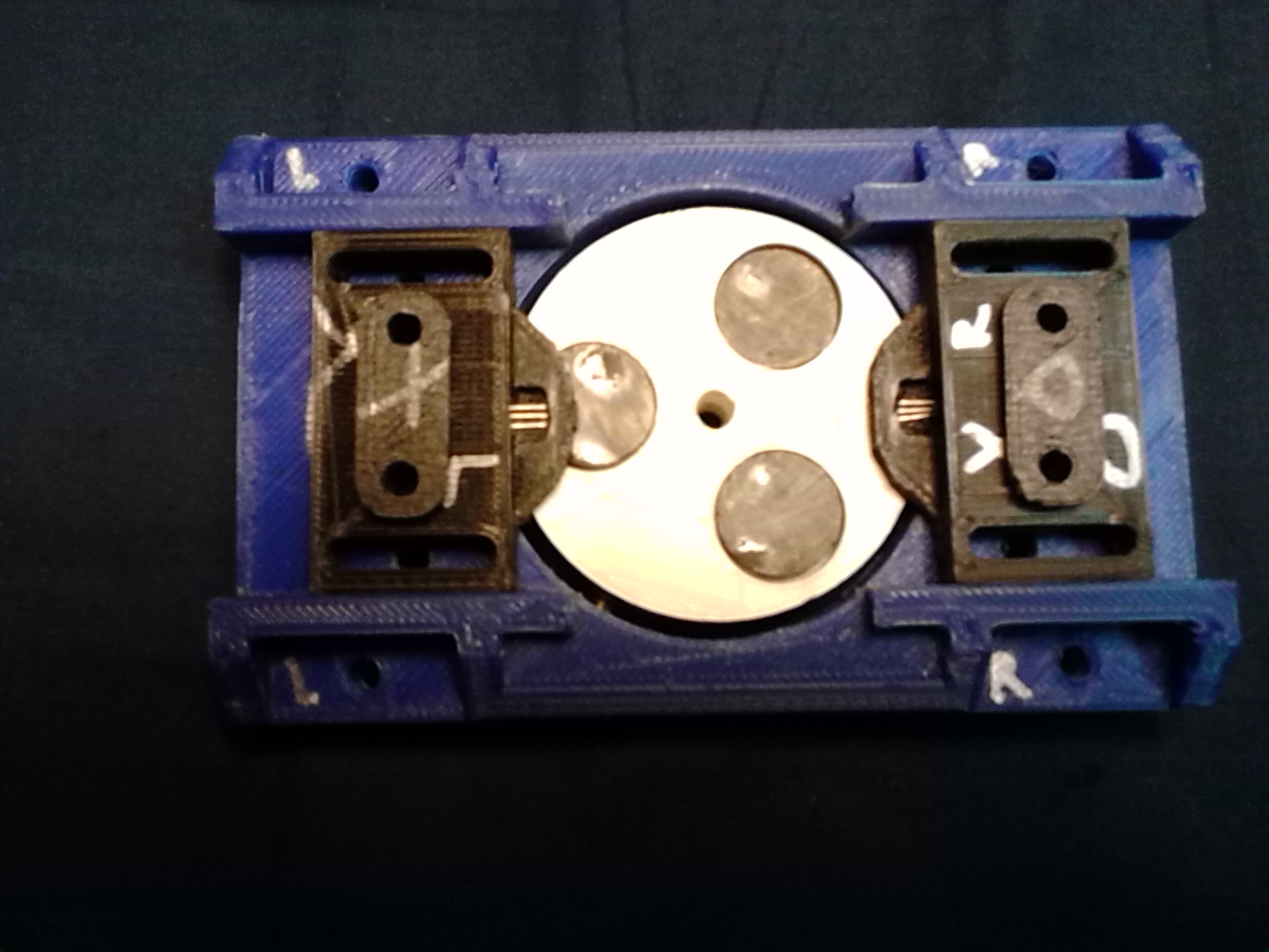

                                Here are Pics of the 3D printed window motor timing wheel and hall holders / mounting bracket
                                I have tryed Optical, but you have to have a timing wheel designed for it, that is adjustable in timing trigger position to the coils and pulse width of the pulse that seams a bit more tricky than the hall sw / magnet timing wheel.... I most likely could design and 3d print a timing wheel for a Opto sensor in a few days.... i did not have this option till a few years ago and would have tried it back then if i would have had it handy....
                                will try to find pics of the 8 pole steel timing wheel rotor, i had a professor buddy with a machine shop make for me way back in the day, that will work with hall or opto....
                                a adjustable voltage regulator can be a speed controller.... Look at the SCH i gave you at the 2015? conference....
                                email me for more info
                                Any one with pics of the 3 pole window motor diagram from JB's notes handy to post....?
