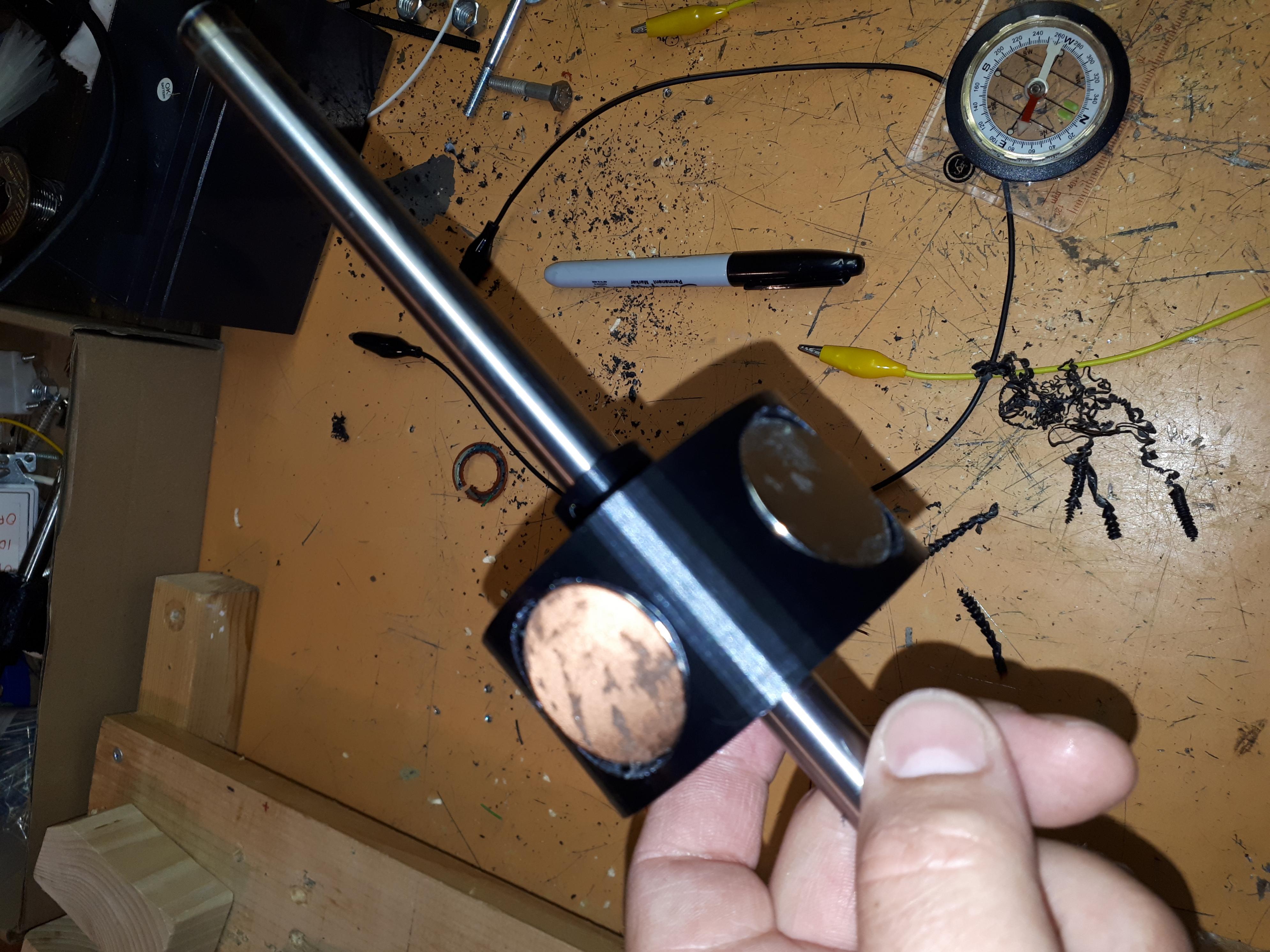

Thanks big time for the 3 coil window motor pics and Hall timing arrangement. It would be of use to know how the 3 coiler stacked up performance wise versus the usual 2 coil window motor.
I assume that the duty cycle of the Hall switch timing method can be altered by the positioning of the Hall switches in and out with the timing dependent on the initial positioning of the timing rotor. True?
My main reservation in using the Hall method with the Neo timing wheel is the impact of the reversing coil fields on the timing rotor fields. The existing ZFM timing and reed switches are definitely impacted by the coil fields.
Anyway, the next ZFM build will probably start coming together late summer - the timing method (Hall or Optical) can wait a bit until things start coming together.
