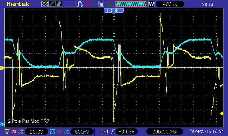

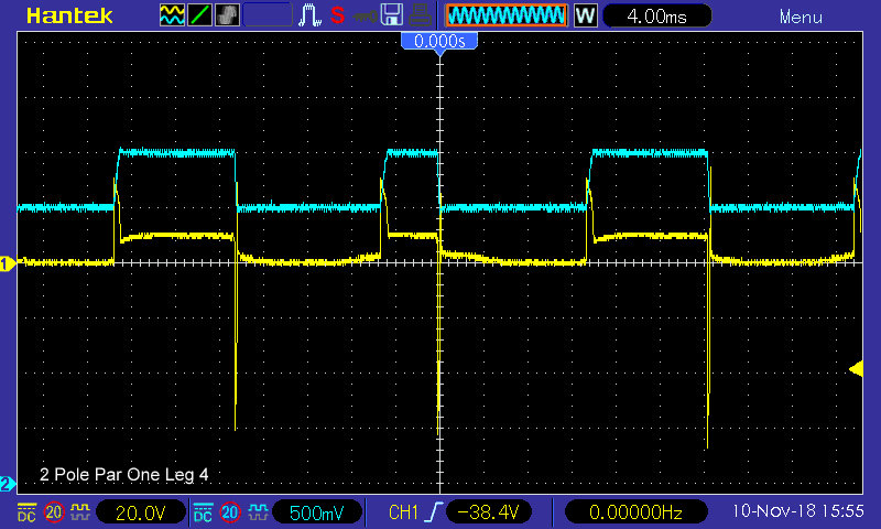

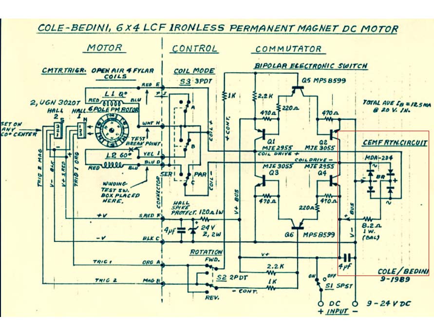

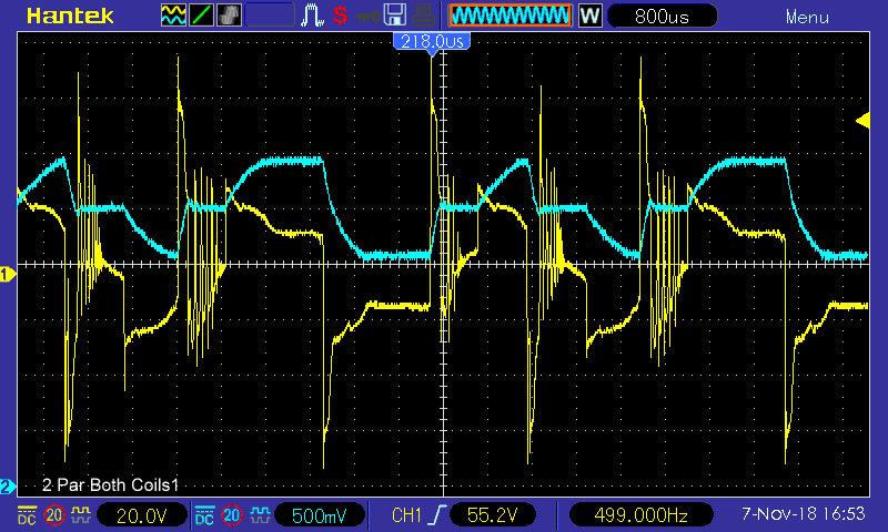

Anyway, decided to flesh this coil question out by running an additional experiment with both coils now in parallel - no Bifilar for the 4 strands. The individual coil resistance is 3 ohms with the parallel configuration yielding 1.7 ohms. This experiment was run at 24v with the same load values as the previous experiment for a valid comparison.
Surprisingly there was no real difference in the values of the results. It was as if the prior experiment was run again. Check out the data and schematic below.

Both parallel configurations do produce very different operational characteristics versus the series coil configuration. There may be individual differences in the two parallel configurations that may be noted with some further load testing. For the time being this will be put aside for future reference. As a note the parallel mode is a bit sensitive to voltage, however the usable voltage range is between 20v and 36v for this particular rotor/Neo arrangement. Higher voltages do not appear to be that useful at this time.
