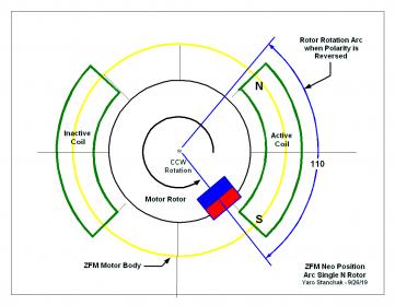

    Yaro

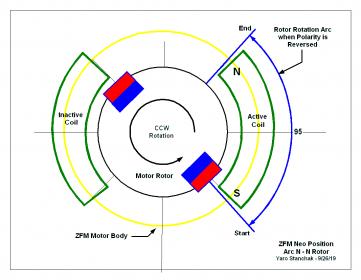

    Experiment B: N-N Rotor Neo Configuration
    The second experiment in this series was a trial with a rotor N-N NeoN-N Neo95 degreesN-S to demonstrate the impact of this arrangement, if any.
Name:	ZFM Timing 2.jpg
    Yaro
      Hi Yaro,
      These are interesting experiments, but I have a couple of questions about them. .............First, what is the "repulsive dead zone"? And second, if you installed a steel shaft for the second experiment, what was the shaft material in the first experiment?
      A slight nudge moved the rotor out of the repulsive dead zone and it turned towards the other coil end pole and locked onto the attractive pole. The total rotation was 95 degrees. A major difference from the previous single pole experiment.
        Hey Gary,
        There is a narrow arc of rotational movement at the coil end pole where the principle magnetic force acting is radial and not tangential. In the attractive case the Neo is locked into position and will not rotate - the same applies for the repulsive case, in that the Neo remains stationary. I describe this as the dead zone and use it as a reference point. There is some very small play here due to other influences, with the major one being static bearing friction.
        My error in not clarifying that the same steel shaft and Aluminum rotor were used in each experiment. Intend to post the last experiment soon.

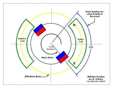

          Experiment C: N-S Neo Configuration
          The third experiment in this series was a trial with a rotor N-S configurationN-S Neo configuration the rotor turned and rested on the first attractive coil end pole. The Degree wheel was then adjusted to the Zero Degree Point. The rotor then was positioned at the coil mid-point (to eliminate rotor over spin) and next the coil polarity was reversed. With the reversal of polarity the rotor turned to the other attractive pole yielding 105 degrees of total rotationClick image for larger version
Name:	ZFM Timing 3.jpg
          Yaro
            Hi Yaro,
            I would also be interested in seeing how a four magnet rotor would behave in this test. Both with all north out and then with alternating N,S,N,S out.
            It would also be interesting to measure where the torque is the greatest in each experiment, i.e. at the coil ends or somewhere else in the arc of rotation between the coil ends.
            I'm enjoying your experiments with the basic setups to better understand the magnetic fields and how they interact. GOOD WORK!!
              Gary,
              Appreciate your encouragement on this experiment and will attempt to partially answer your what if questions as follows:
              1) The two pole arrangements are very similar in the torque produced, at least as measured by the finger test. At 12vdc there is a smooth acceleration from the Repulsive pole towards the Attractive pole when there are two forces (push and pull) acting on the Neo rotor and it appears that the minimum is on the very near approach to the A pole, while the maximum is produced a bit away from the R pole vicinity.
              2) Cannot do this type of test with a N-N-N-N arrangement at this time with the single coil - not enough Neo's on hand. This configuration would be problematic for a 90 degree coil in that as the first N Neo rotor moves from the R pole towards the A pole the second N rotor Neo approaches the R pole. Furthermore the third N Neo leaving the A pole would resist the first Neo leaving the R pole. So the rotor would probably stall. Way too many conflicting forces
              3) The N-S-N-S arrangement, on the other hand, has three Neo poles working together with the coil, thereby amplifying the A and R forces. The first N Neo is being Repulsed while the second incoming S Neo is being Attracted to that pole. The third S Neo is being repelled (outgoing) from the further pole. That in a nutshell is the beauty of the ZFM concept with all the forces acting in unison The YZFM has been operated many times at only one polarity and it will produce torque and speed, albeit at a much lower value.
              Torque measurement may be a bit challenging, however we can speculate that it is greatest when the Vertical force is becoming lower and the Tangential forces are greatest. Much depends on the Neo sizing, coil gap to Neo and the operating voltage - this is where the design issues become way too complex.
              The point here is that a series of simple experiments can become an invaluable tool for maximizing the desired performance from any motor design.
              Thank you for your kind attention!
              Yaro
