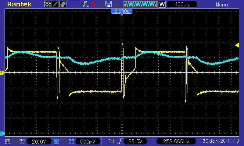

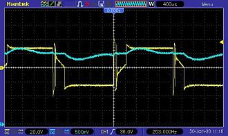

    Below is a sample of the data points for both options. The ZFM has slightly different characteristics between the two types of applied power - the LAB runs required a timing adjustment to compensate. The attached pics were all generated under no Load. Pic 2 demonstrates the oscope wave form for the LAB without the BEMF circuit, while Pic 3 with the BEMF circuit engaged. The Power supply mode with the BEMF circuit engaged is nearly identical to Pic 3 and not included.

    Parallel Mode with LAB and BEMF Circuit (Pic 2 and 3))
    4640 RPM 24.88v 0.65A 0gr Load
    3616 RPM 24.71v 1.52A 800gr Load 50.1% Eff
    2825 RPM 24.64v 2.22A 1400gr Load 47.1% Eff

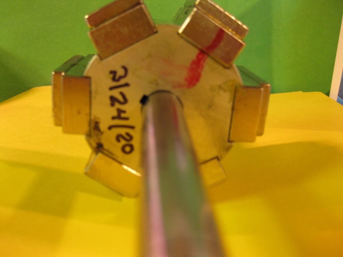

                  The testing program for this season has come to completion with the 6 Pole rotor outfitted with one set of six 2"x0.75"x0.375" Neo's stacked with 1.5"x0.75"x0.188" Neo's using the Loctite AA 326 magnet adhesive. The Neo's were first stacked and cured, then mounted very carefully on the rotor taking into account the nearly 80# pull force. Fortunately the Al rotor is non magnetic, however the adjoining magnets make this a somewhat tricky operation.
                  Click image for larger version  Name:	IMG_1698.JPG Views:	0 Size:	98.7 KB ID:	72786
                  The rotor was installed in the 3 coil ZFM assembly with the coil to Neo gap adjusted to 1/16" - tight. The ZFM was then tuned to the appropriate dwell and advance, then cranked up and tested both in serial and parallel mode. The longer length and greater magnetic pull force along with the tighter gap over the previous configuration did reduce the RPM, but improved the overall efficiency. The most reasonable configuration that yielded both output power and efficiency was in the 30 volt parallel mode. The virtual coil poles for this Neo arrangement were very similar to the prior posts coming in about 55 degrees - not ideal but close to. So lets take a look at the run data:

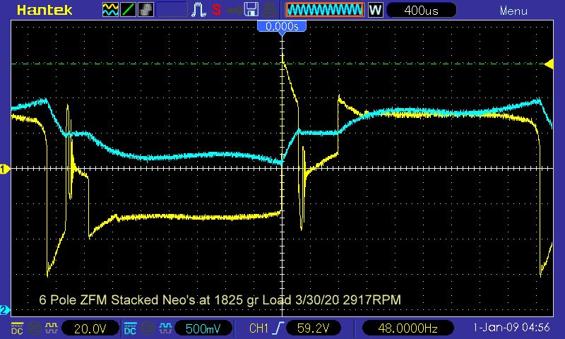

                  A quick expanded look at the oscope shot at high load below
                  Click image for larger version  Name:	pic_228_7.jpg Views:	0 Size:	120.0 KB ID:	72788
                  One will note how quickly the amperage (blue trace) returns to a zero value when the power is cycled off and the how rapidly the voltage rises on power-up - a definite characteristic of the air coil. So at this stage of experimentation all the goals were achieved, with the exception of the virtual coil arc. This particular ZFM configuration should be able to achieve 60% efficiency or more with the proper build techniques and tuning.
