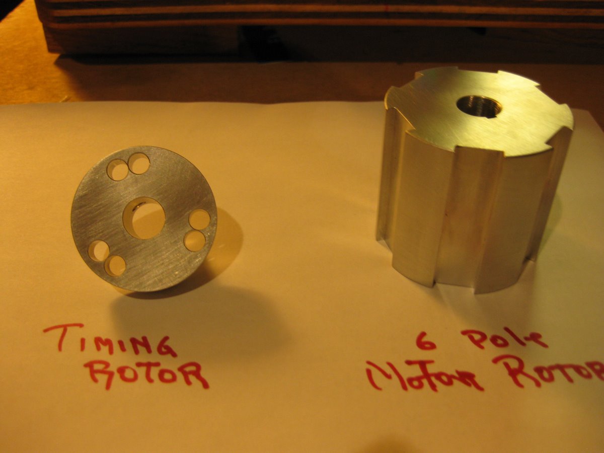

    The machine shop came through with the motor parts today. The parts completed were the Timing rotor and the 6 Pole Neo rotor. Tried a dry assembly of the Neo magnet components along with a steel rod through the center of motor rotor as a magnetic assist. All was good until the placement of the last Neo, then the rotor assembly flew apart damaging two of the Neo's and ending up with two groups of high strength Neo's clustered together. Put this on the Not to Do List, for sure. Separating this mess was tedious.
    For attaching the Neo's to the Aluminum rotor a Loctite AA 332 adhesive will be used. This works well, the Neo skin fails before the adhesive. Game plan is to assemble the rotor step by step and use my Weber grill to cure the rotor adhesive at 200F, fact of life when the outside ambient is less than 20F. Indoors the odor from this adhesive can be toxic, never mind the smell.
    You will note that the Timing rotor has three sets of holes 120 degrees apart for the 1/4"D mini Neo's. In combination with Reed switches spaced 180 degrees apart, the BP switch board will fire every 60 degrees. Of course the appropriate timing Neo's selection must be in place for this to happen. Another obstacle!
    Remains to be seen how all this works out - just an experiment with displaced air core coil poles.

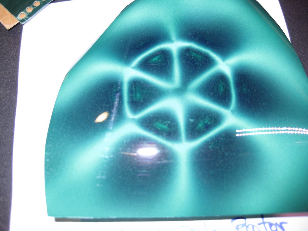

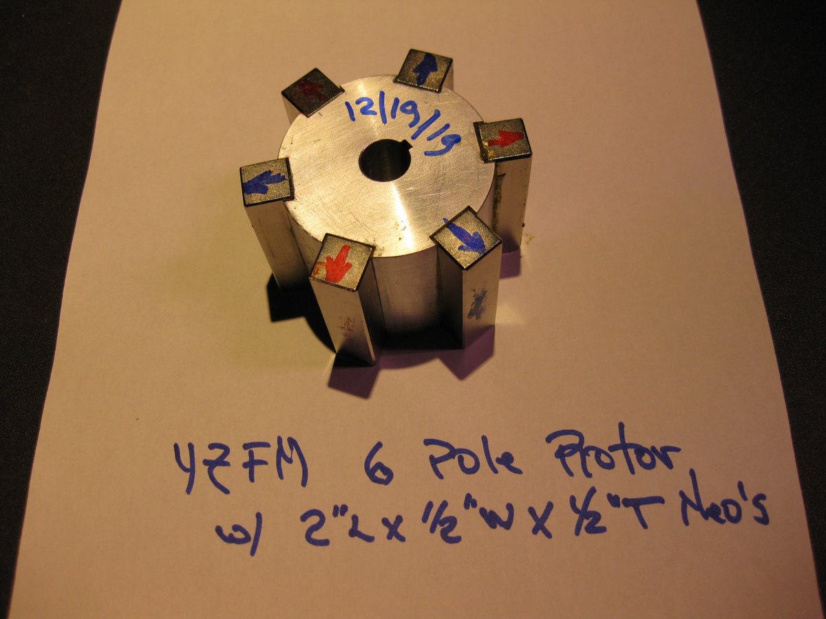

                      Further Experimental Data for Two Neo 6 Pole
                      Well, I could not leave this 2x1/2x1/2 config alone and decided to torque test it just to say it was done.
                      The last torque test for this config demonstrated that for a 2 pole it is pretty gutsy. It is capable of starting under load from a rest position with 550 grams of weight and accelerating to 2410 RPM at 37.01v at 1.69A. It was not pushed! Plenty of low end torque and it gets up to speed rapidly with this load. There still remains the sense that the machine is fighting itself due to the extended firing duration of over 50 degrees. There is a ways to go for an improvement in performance.
                      Ancient history for now that the rotor has been updated to to the full complement of 6 Neo's with the new timing duration of about 42 degrees, though a bit under the target powered duration. Nevertheless, ready to be installed on 12/20/19 after the obligatory fiberglass wrapping tape procedure. Pic of the new fashion Rotor:

                      The assembly procedure used here was to clamp the rotor in a vice and use a pair of wood clamps to handle the Neo's for assembly - a much safer procedure than using the fingers. Used an AA 326 Adhesive (Loctite) with an SF 7649 Primer yielding a rapid cure to full strength. Low odor and readily available versus the AA 332 adhesive, but with about 75% of total strength. Let's see how this works out as the experiment progresses.
                      Pic of rotor with Mag Film:
