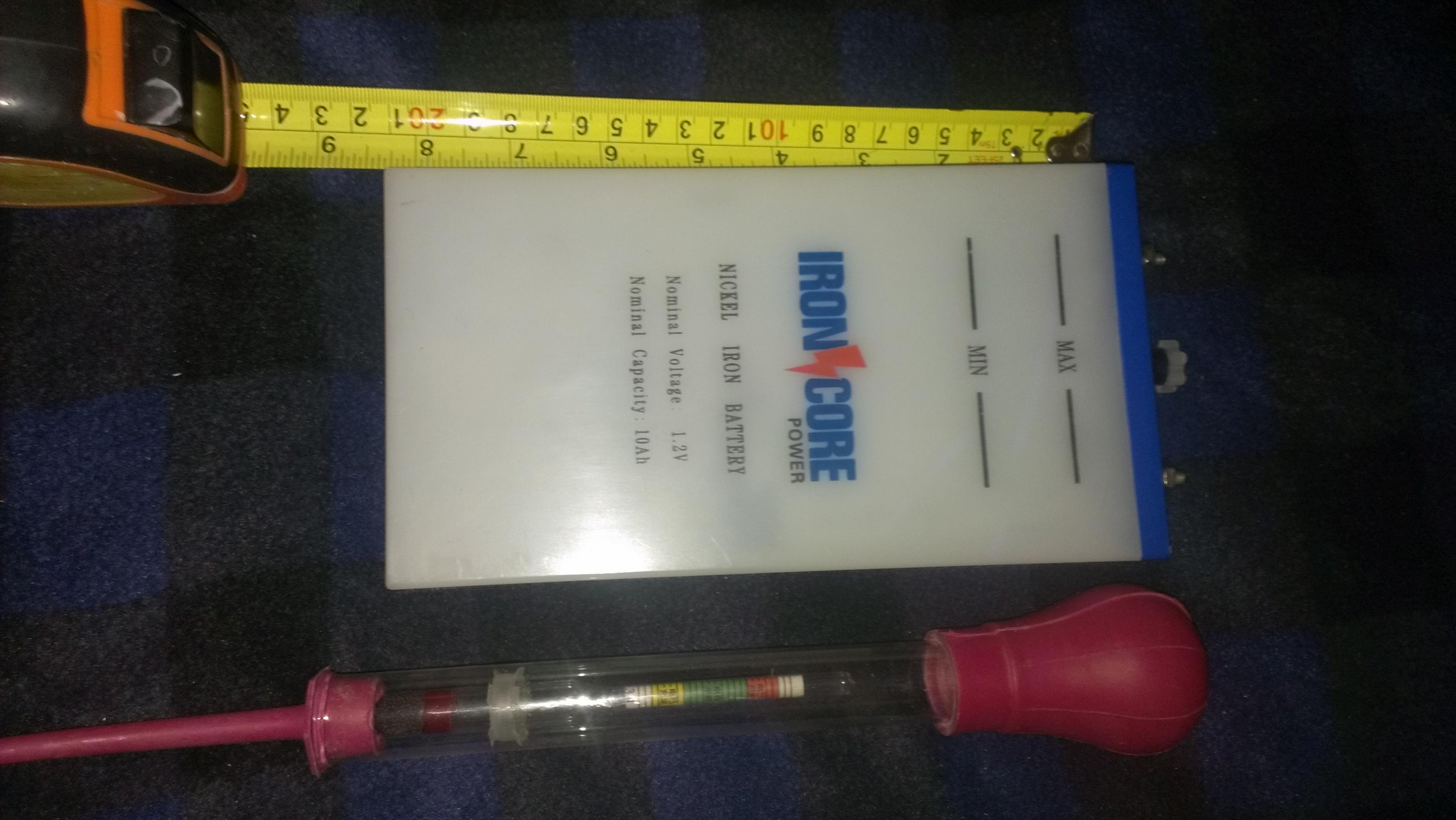

Here is a picture of just one cell and a hydrometer next to it. That is used for measuring the specific gravity of the electrolyte which is KOH. The KOH is basically a dry flakey substance and you mix it into distilled water to a gravity of about 1.2.
