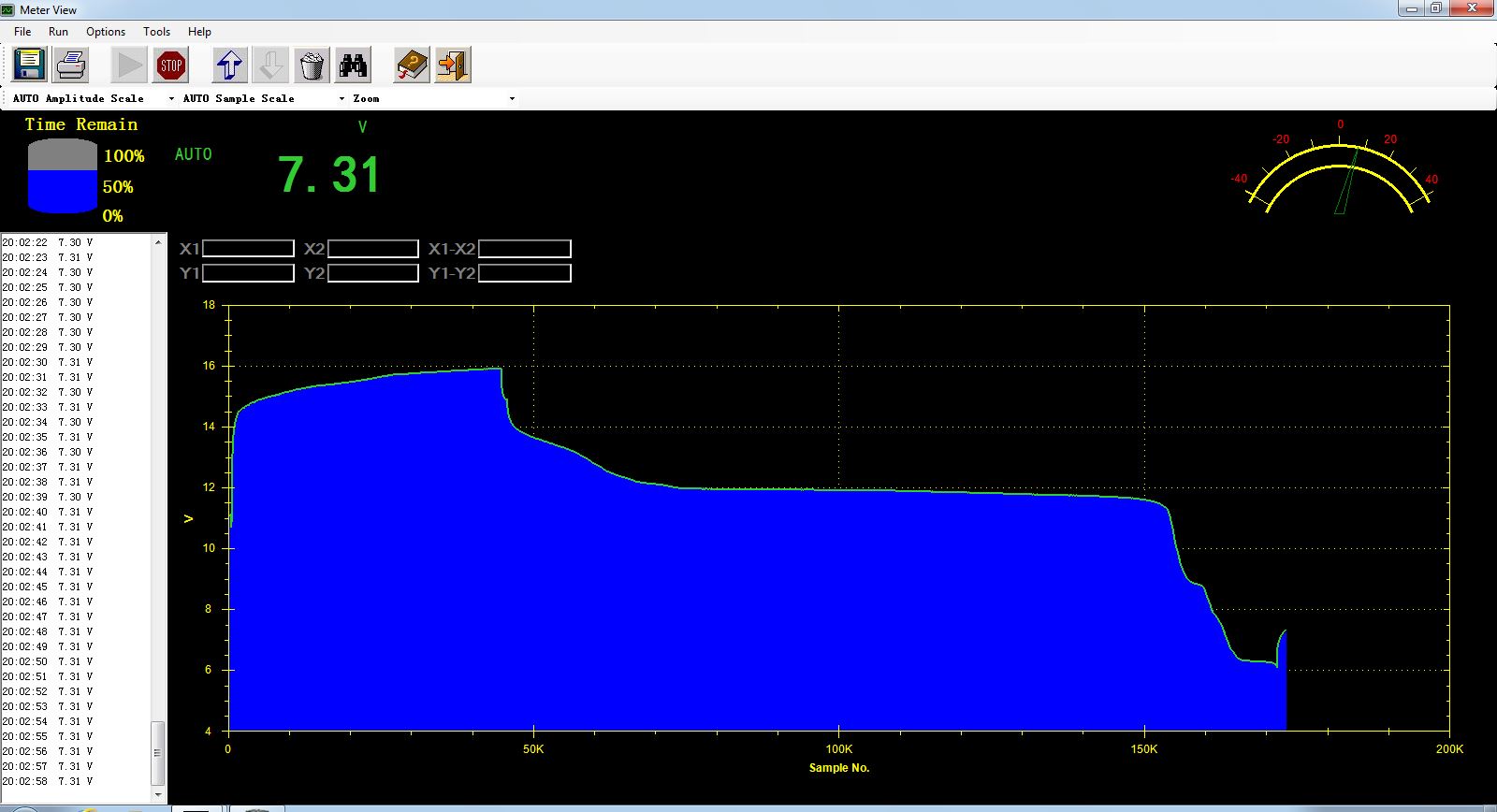

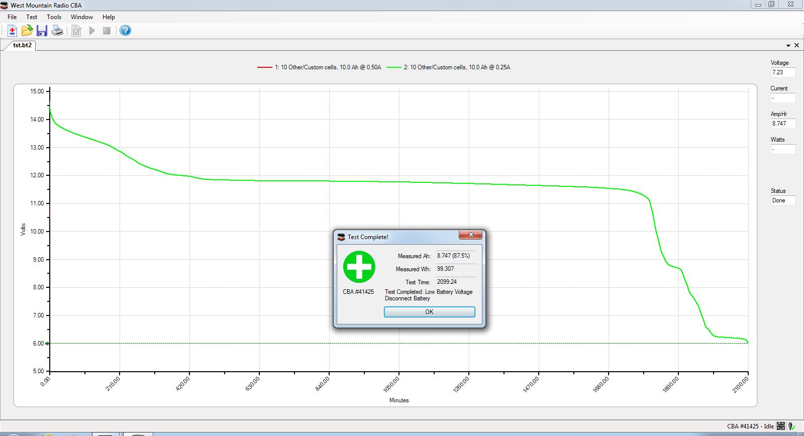

            I did a run on my NiFe cells with my new machine in mode 1.
            I explain in the video but this was also checking the effect of leaving one of these nickle iron packs discharged for a long period of time and then charging it. I didn't keep track of how long but I'm telling you it has been months since I used these cells. They did charge right up and give a decent performance on a discharge at 250ma down to 6v. There are stories of these things sitting for years untouched and working fine when someone charges them which is one reason I have them but I wanted to test that a bit. Months and years are very different but at a minimum you could say that you would not want to do this with any lead acid battery but this one had no issue with it.
            Video:
            https://1drv.ms/v/s!AmzmftzD-V0miG3ygbvSoLhDS_JY
              [ATTACH=CONFIG]6375[/ATTACH]
              [ATTACH=CONFIG]6376[/ATTACH]
              Video:
              I was wondering if you were still working with those nickel batteries, thanks for sharing the video.
