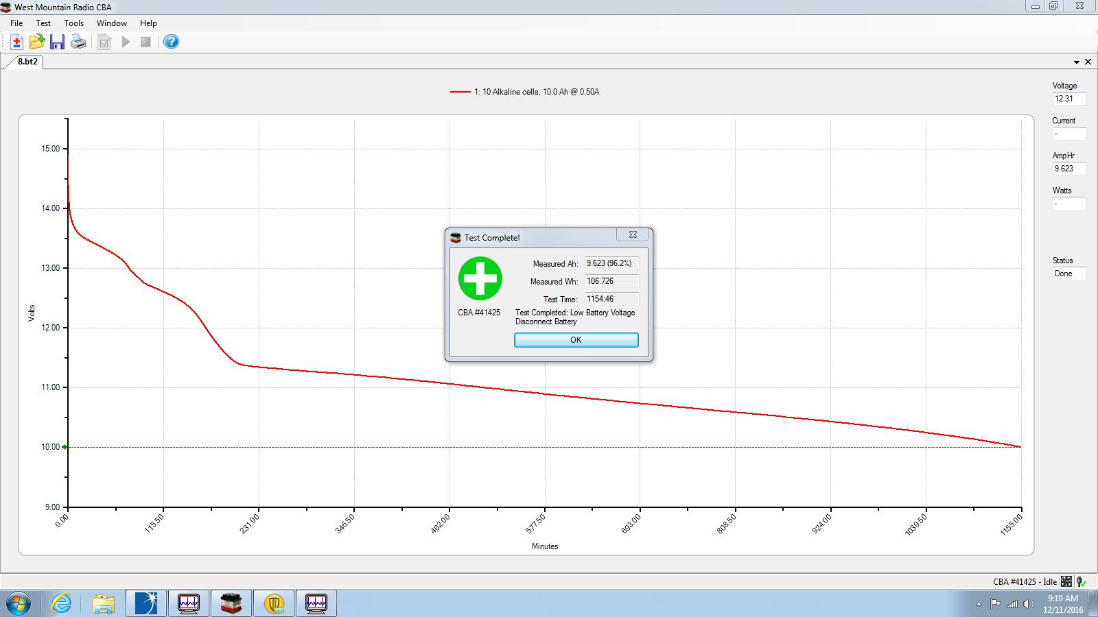

Here is the discharge chart from that run. It did very well in my opinion. I notice that it was still strong when it got to the 10.5v that I set the cut off for. In other words there was no drop off. I think at the half amp rate I could have maybe gone down to 10v or even 9. The other way to look at it could be that I can probably pull .75A or 1A from them,, more testing is needed.

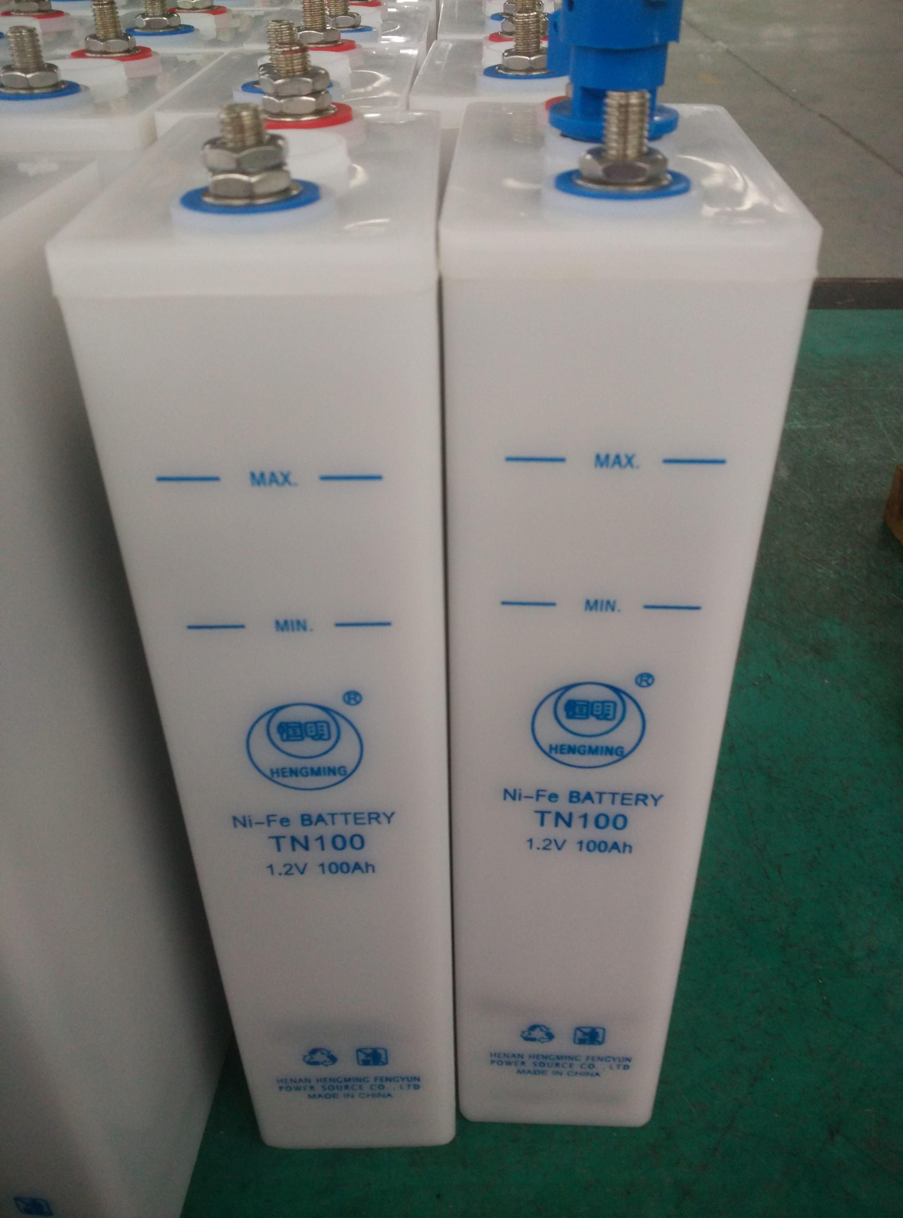

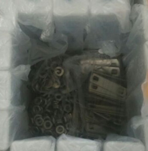

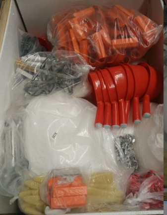

Wow, that was a high price but at least the batteries will last you a life time if you keep fluid in them. I just got some pictures from the Chinese battery company. I was making sure the batteries came with the connectors, caps, bolts, and fluid additive. See the pictures they sent to me. They even offered to help me get the Import information once I told them I was researching that. They really want to sell the batteries.
-- James
That's looking good James. I will be curious how the whole thing goes for you when you actually order them. I didn't think it was really possible to get them that way because everywhere I looked it said min order 100 or some such numbers. I also thought perhaps you needed a business license or to at least show that you are a business. Anyway so I paid too much I guess but at least I have them. I have been looking for these things for years, not the large ones but I specifically wanted the small ones which seemed very hard to find.Last edited by BobZilla; 12-11-2016, 07:20 AM.

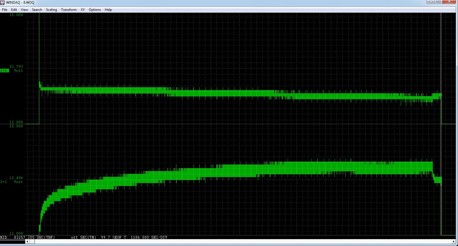

So Group I am back with a charge run to share. This one is done in mode 1 and it was drawing roughly half an amp. I do make some commts in the video saying that perhaps I was running too weak and that 1A may be better suited and I may be right about that but once I started the discharge it looks better than I was expecting. It is nowhere near finished yet so I don't know how we are going to do in the end but it's looking decent so far.
Once the discharge finishes I will post the chart for that.
Here is the charge chart and the video:
https://1drv.ms/v/s!AmzmftzD-V0mhwNTMNkRBeE0w4f5

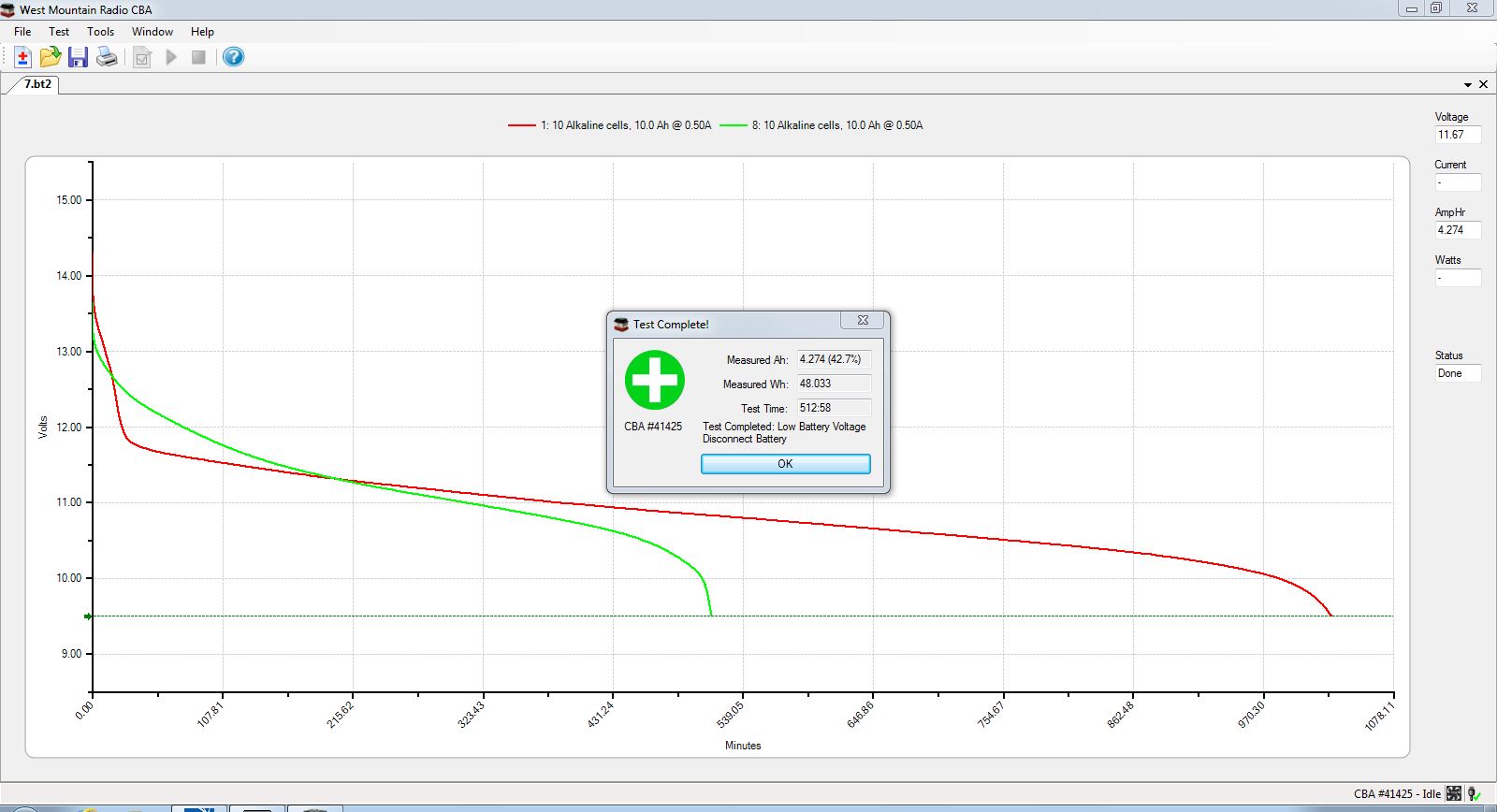

Adding the discharge chart here, the green line is this one. The red is from a a previous test.
So obviously this was not such a great run on these batteries. I don't think it was all that bad but I should have been pulling a bit more into those coils. I will do another mode one later on, I'm sure we can get better results.
Yea they also are not broken in yet. I was probably a little to eager in posting, people like to see perfection. They are doing a lot better now but it gets old fast trying to record and post all the time. I still have a boatload more to work on. Don't let that last run fool you though , these are great batteries.Originally posted by ZPDM View PostMany thx for answering all my questions, sounds like you didn't have enough oompf on the last charge cycle.
