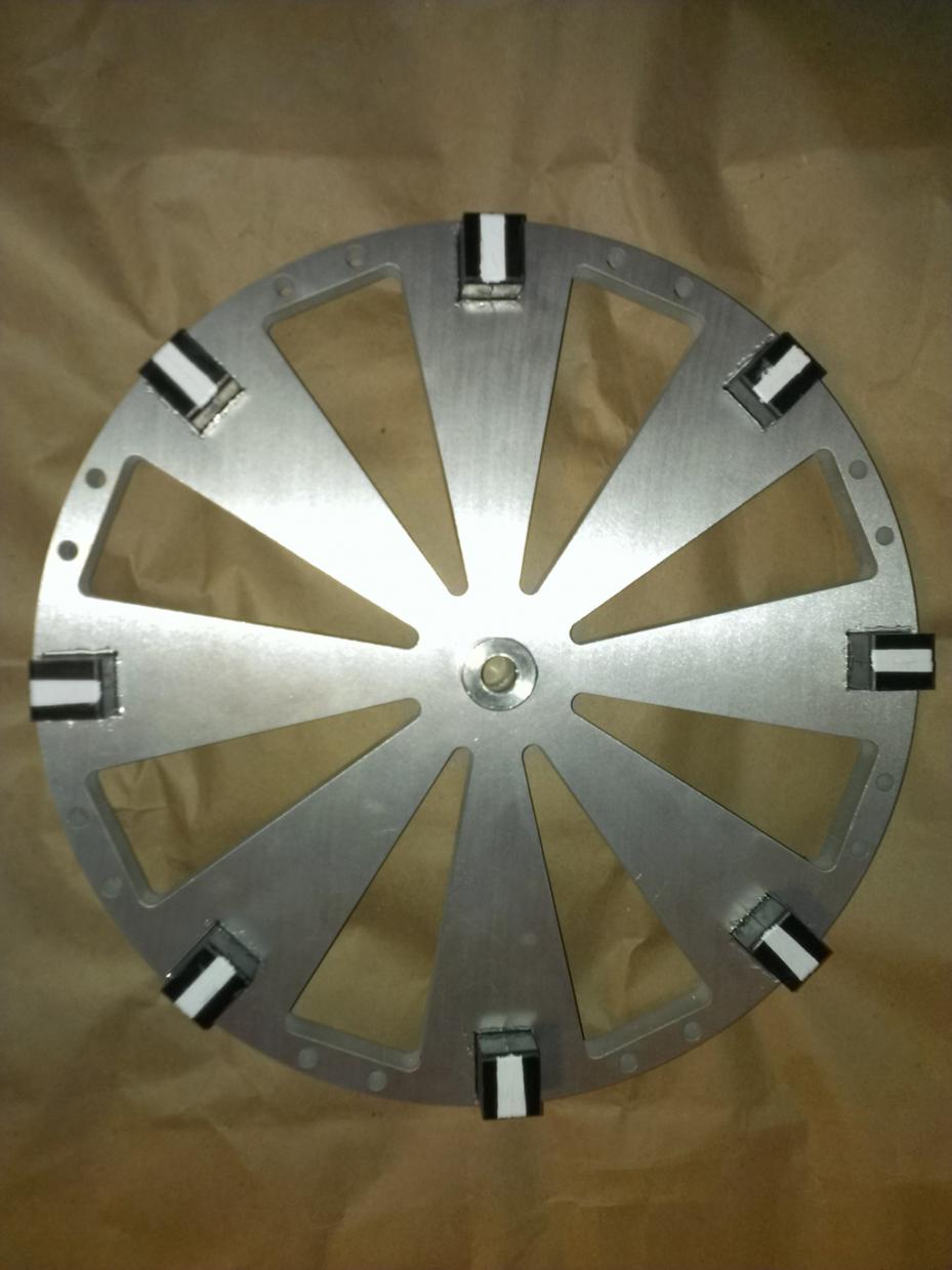

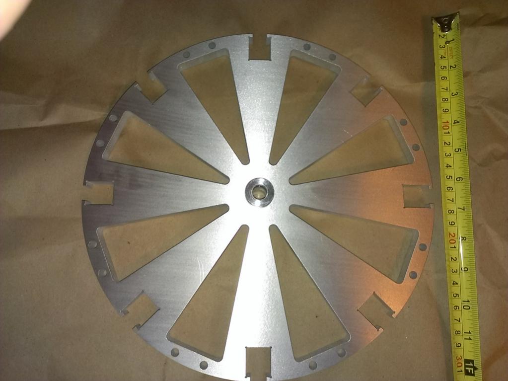

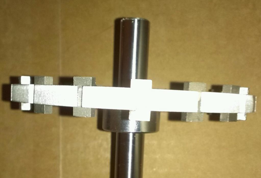

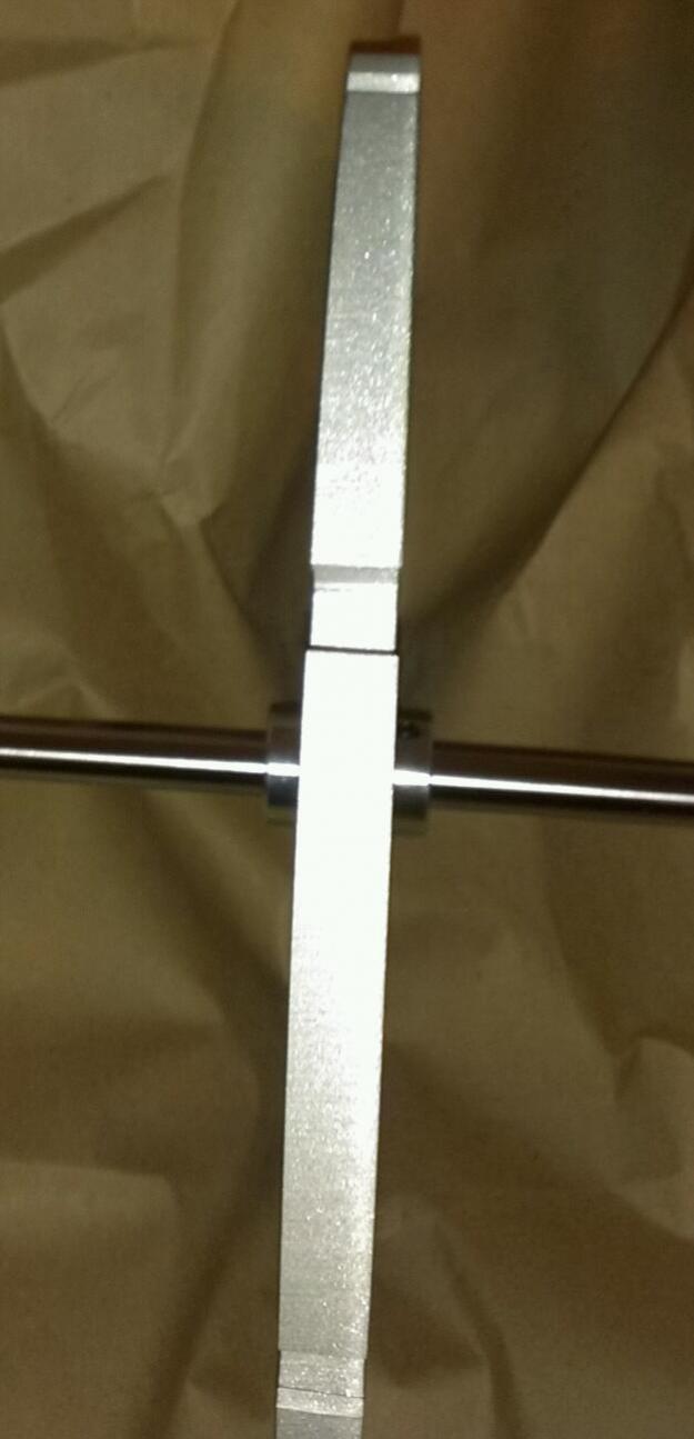

It has a 12 inch aluminum wheel half inch thick. I have had it machined professionally so that the balance and spacing will be very even. Through the middle it will be riding on a half inch chrome plated steel shaft with bearings that are mounted at the outer edge of the frame, in other words it has a fixed axle. The magnet holes have an eighth inch claw to hold the magnets; they will be glued with epoxy as well. It is going to be a super pole configuration made with the standard ceramic C8 grade.

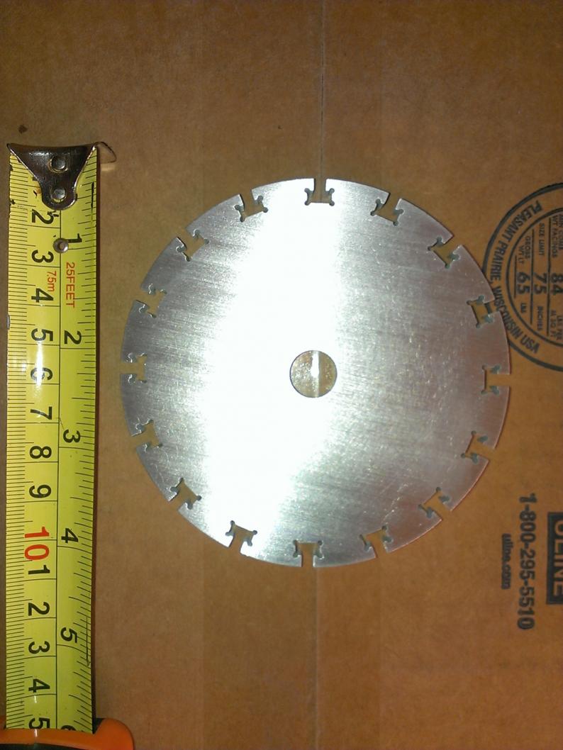

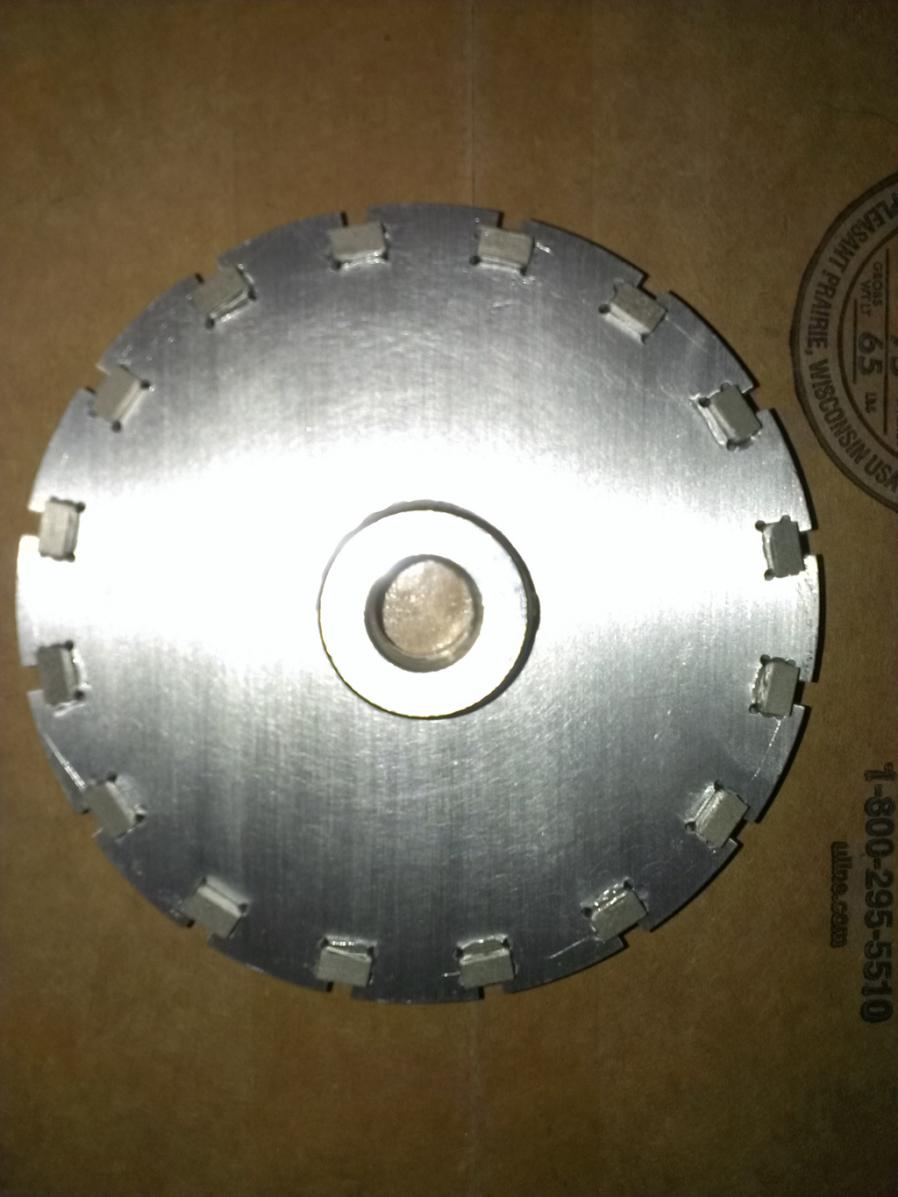

I have an additional wheel which is going to be a generator. This one is 4 inches wide and has magnet holes to accommodate sixteen small samarium cobalt’s. This wheel will ride in front of the main wheel and have generator coils collecting from it.

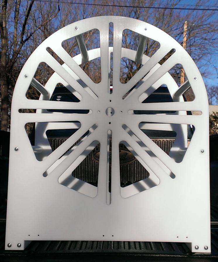

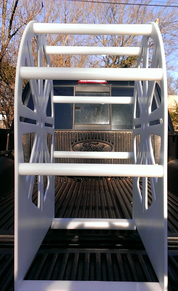

The frame is quarter inch white polyurethane like they make cutting boards from. Again this is being machined for precision. The depth of the machine will be one foot and connected by 1 inch rods and 1 x 2 x 12 inch bars for feet.

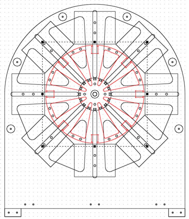

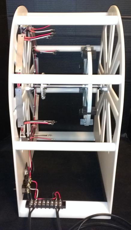

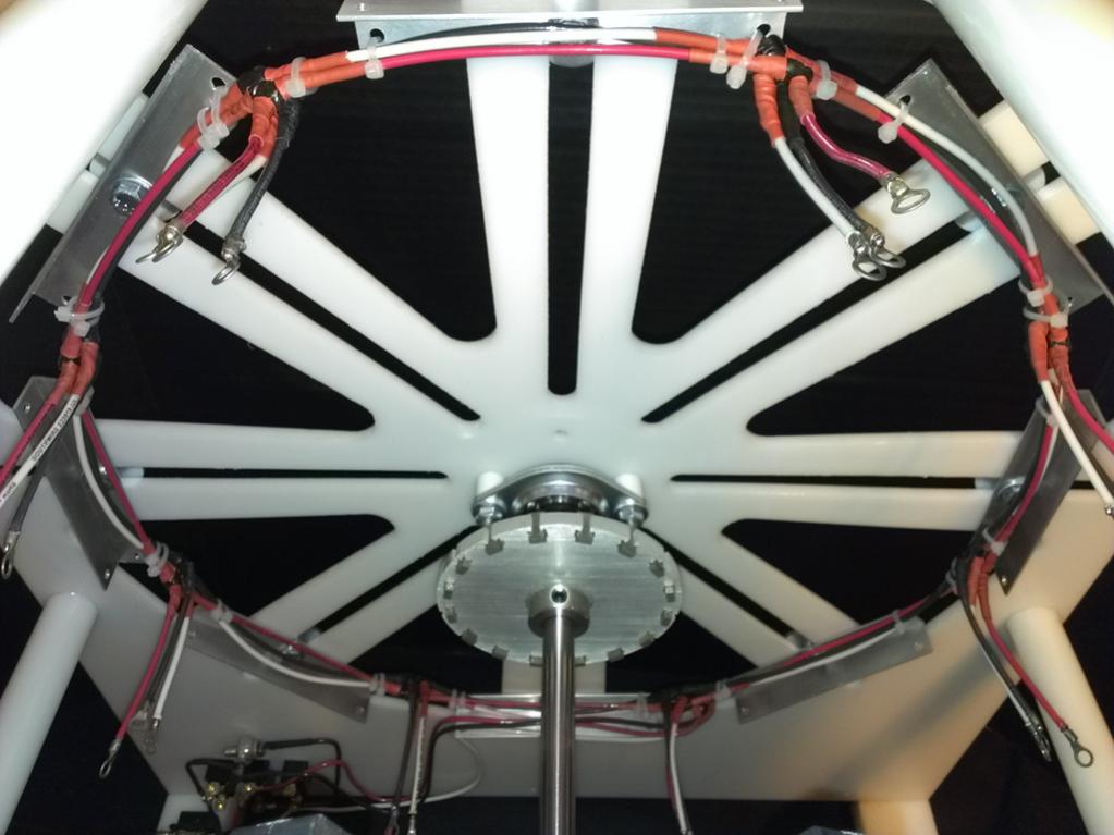

I am attaching a mock up profile picture of how this will look from the side. It may be a little confusing but if you look closely you can see the frame, coil holders, and the wheels. The main wheel is in red in this picture.
Also attached are real pictures of the flywheel. I am still waiting for parts to come in to build this thing but I wanted to show off this flywheel ,,, I am so excited about this project! -----Bob
