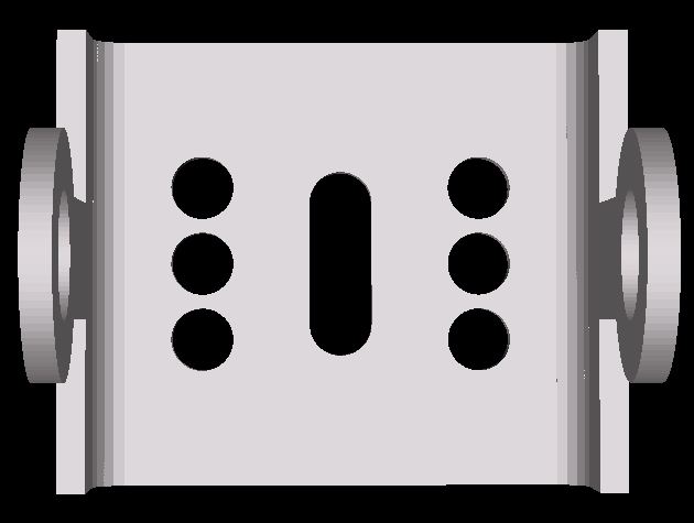

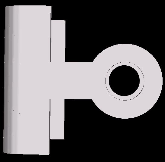

      plastic please, aluminum can get eddy currents in it, if the aluminum is not spinning it will affect your build. let mew know about the coils, if you have a design I can print it for you, and can make the bobbins any size you want.
      Thanks for the advice Tom. I am really on the fence about the material, it did cross my mind that the aluminum would cause problems. The other big machine I build is starting to show slight warpage on the frame now which is why I thought I should use tougher material. That thing has the weight of 8 coils on it plus the circuits and flywheel. It still runs good at this point but the warp concerns me. I may have to make it back into a 4 coiler to reduce the weight.
      I designed some simple coil holders which I was thinking about aluminum as the material because the plastic cannot be used unless I make it really thick, that is according to the software I use.
      The intent with this machine is very far from the normal mono pole. I am trying to make a transistor less model that will use clap contacts for switching mounted on the wheel. That is what the cut-outs on the frame are for, too mount the clapper. If it does not work out I can always go traditional with it. I understand that true contact switching is MUCH better than transistors because of the little bit of capacitance held in the p junction, it makes for a fluffy off rather than immediate. If anyone has ever played with just shorting a coil on a battery you may know what I mean about that.

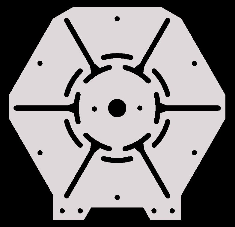

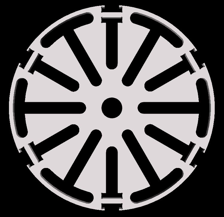

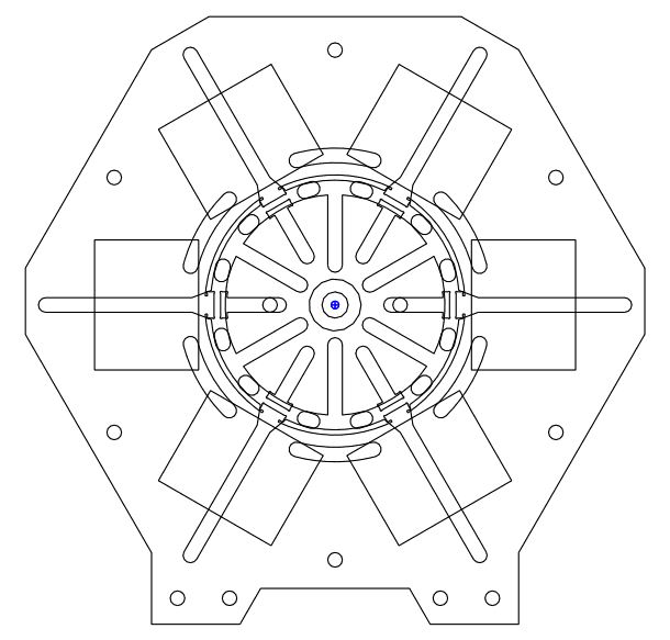

      • Another set of plans. I think this might be what I go with.
        The frame is about 1ft tall, 2 inch coils, 5 inch rotor.

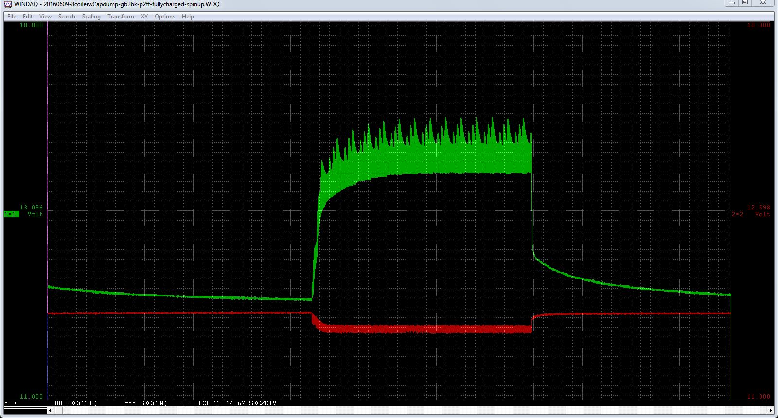

          So I have not played with this machine is awhile because the smaller one in my last post was built and has it's own thread in the other section.
          I have put this one (8 coiler) back on my bench so that I can work on the smaller one awhile. I had forgotten how much fun this one is ;-)
          This chart and the video is showing a spin up with a cap dumper attached. The charge battery was already finished so this is only bringing it back up to peak. The cap dump is set to half a second loop with 66kuf. This is not a full run, it's just a look at how the machine settles in on a charge.
          Video:
          https://onedrive.live.com/redir?resi...nt=video%2cmp4
