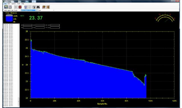

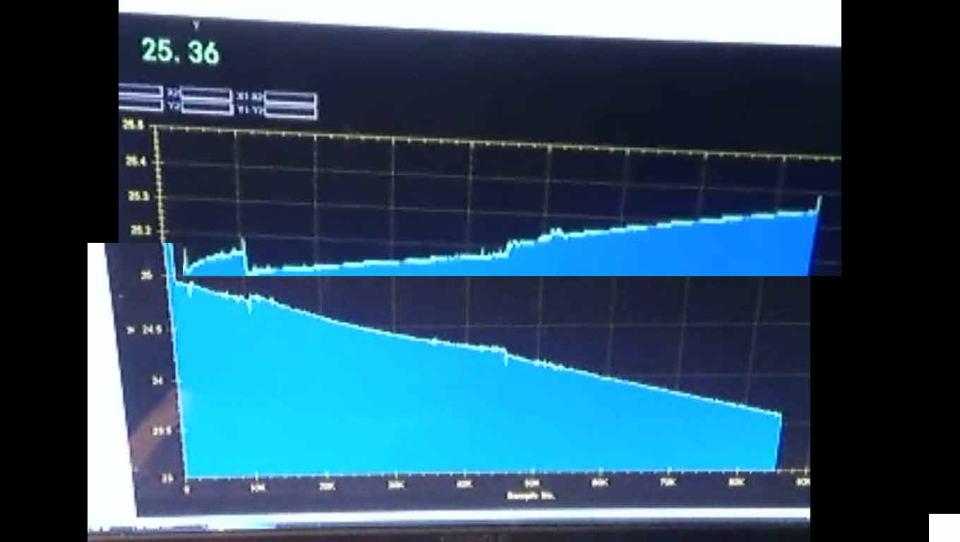

      Hi Bob,
      that is pretty cool:
      I like it! I didn't appreciate the "curve" as much until I clicked back and forth and overlapped them.
      KR - Patrick A
      PS - I like the long videos... either way - thanks for sharing

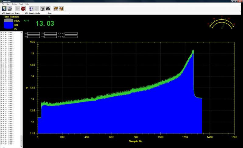

          Gary that was mode 1. What I am finding out is that these multi-coil setups like to be setup for one mode or another and one voltage or another. I have got the machine to run in every kind of configuration but it takes tinkering with the gap or the advance etc.. I thought when I built it that I would be able to just switch around because on my smaller machines I could quite easily but I think with this one I will have to decide how it should run and then stick with it. Then again I do have 4 more coils on the way so that might change everything.
          Patrick I appreciate your mirroring that chart, it doesn't look half bad does it,, I hardly noticed myself. I am going to try and get a run in tonight, a full run so we can really see a good chart. It may not work out because i have to go to work in the morning and if it is sort of close I will not be able to leave it running al day like I did with that last one. Because of the timing involved here I will probably do a fairly hot run like 3A or so against just two on the back. If I can't get a good run to post I will do one on the weekend when I have time to fool with it.

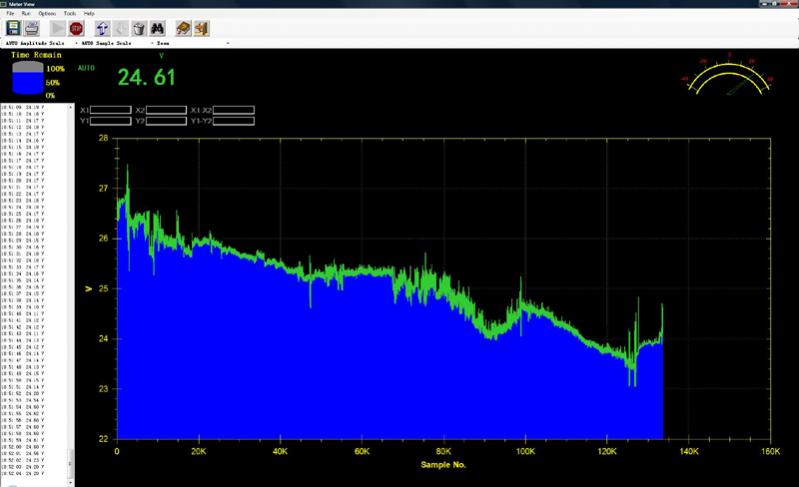

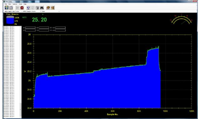

                              Hello everyone,
                              Today I am posting a cap-dump run I did. This was 24v on the front and 12v on the back. The charge target was one of my 75AH AGM's. I state in the video that those 75AH batteries are normally charged in mode 1 so I expect there is a bit of an internal fight going on in the battery switching back to POS current. The run is not all that efficient when you consider it had 24v on the front however I know I can improve on it. I had not done any cap-dumps with the new system until this video, only a few short tests to calibrate my dump time and input.
                              I could change things up quite a bit if I want too. The input was at 1 and a half amps from the primary. The cap was set to be off for 600ms and on for 150ms which made the complete cycle three quarters of a second. This produced about a 30 volt dump which discharges to about 20v before cycling again. All of this info is in the video below but I am typing it in here for those who cannot download the video or don't care too.

                                Hi Bob - Good mornin' to you.
                                what a radical line on the primaries... what is the combined amp hours on them. I imagine you mention in the vid I'm downloading now... :-)
