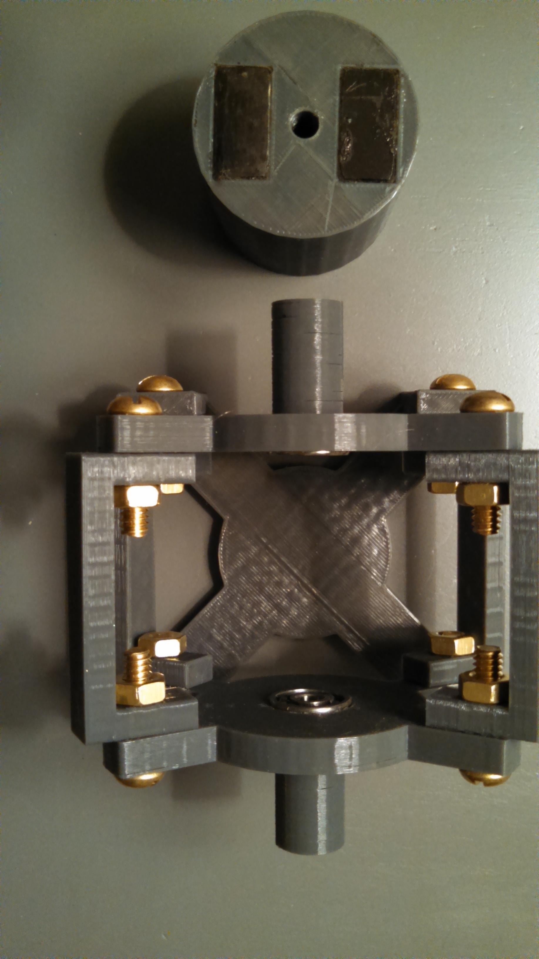

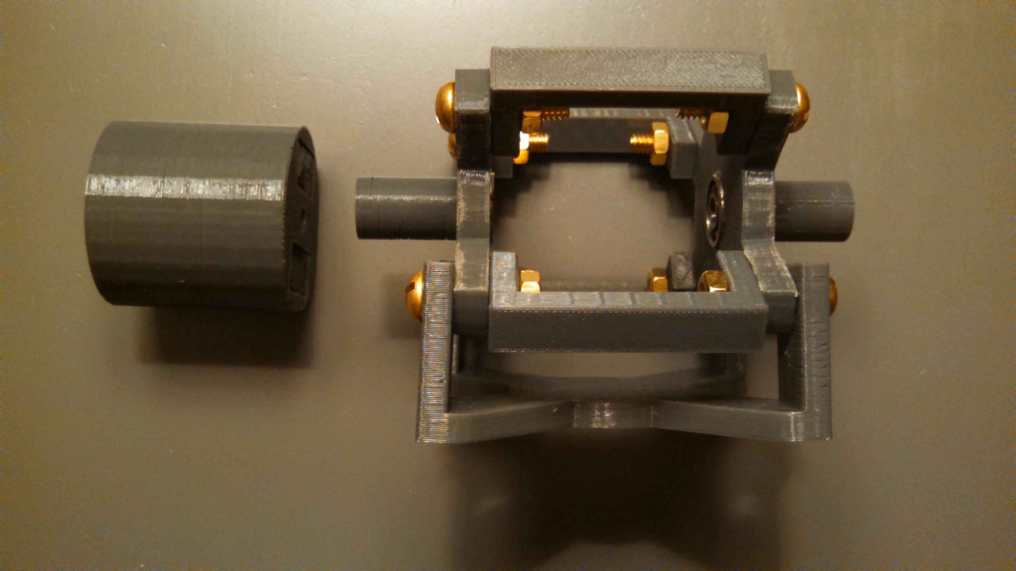

            So I have reconfigured the design to better reflect the Bedini/ Cole Window Motor. Here is a picture.Click image for larger version
ID:	48939 I have the wire on hand. I am going to use small diameter wire on this one with a larger number of turns versus my first wooden window motor. https://www.youtube.com/watch?v=_ynwMFoq2no There will also be solid state switching instead of a commutator. I should have my shaft material by the end of the week. The Neo magnets for this one are 2" X 1" X .5". They will be in the ns arrangement.

              Here is the Window Motor wired up to a one battery SSG circuit. The big neo's were too much for this set up. It caused severe magnetic lock when I powered it up to the bedini/ cole half circuit. I ended up taking the rotor off of the Rick F model and using it for this model. I am going to put both models up on Thingiverse Sunday night. The files can be downloaded for free there. There will be a parts list included there as well. You will be on your own for the circuit and wire choice. https://www.youtube.com/watch?v=1r3-KltRWEU
                Scalability: I did this video to show a progression of the time I took to come up with a simple printable design. While others ideas and designs laid the foundation, it took some time to put it in AutoCad and then print and figure the exact sizes to fit the magnets, shaft, bearings,...etc. You will see a few models that were printed during the consideration process. While the final designs have room for improvement they present parts that can be printed on a small 3D printer, scalable to fit the needs of the experimenter, and at least somewhat visually appealing. The functionality depends on a few factors. The dimensional capabilities of the 3D printer being used and the materials used. You may also need to balance the rotor. I have not done any balancing on my rotor. The bearings are crome plated steel and the shaft is hardened smooth steel rod. Despite these limitation on mine it still shows some desirable affects. It will run down to between 10-20ma (Window Motor). That being said, if you are going to run it at high rpms please do not take any short cuts. You operate this device at your own risk. https://www.youtube.com/watch?v=ZYheabS5WBU
