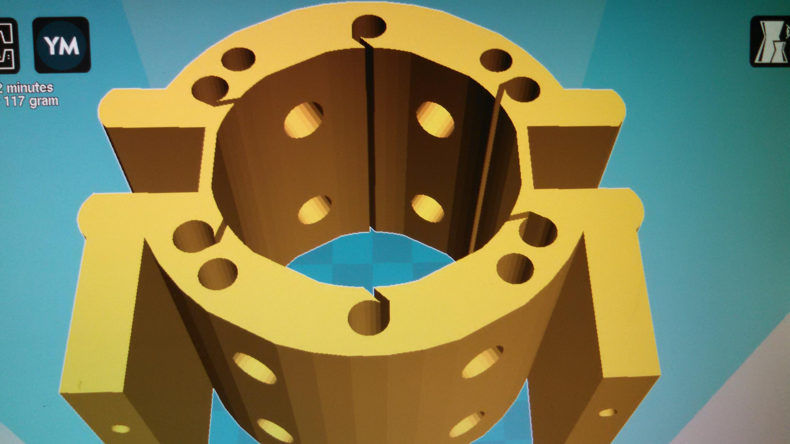

        Please be patient with me. It should not take me long to get it done. If you would like to go ahead and get some parts sourced I am using 1/8" brass rods from Lowe's. Get enough to cut 18-4.75" lengths. The bearings will be the same size as the Window Motor. The bolt sizes for this will be 1/4". I may use nylon bolts on this module. I plan on making this open source on Thingiverse. Teslagenex may also be available to print the 3D parts if you like. Please post any questions or comments.Click image for larger version

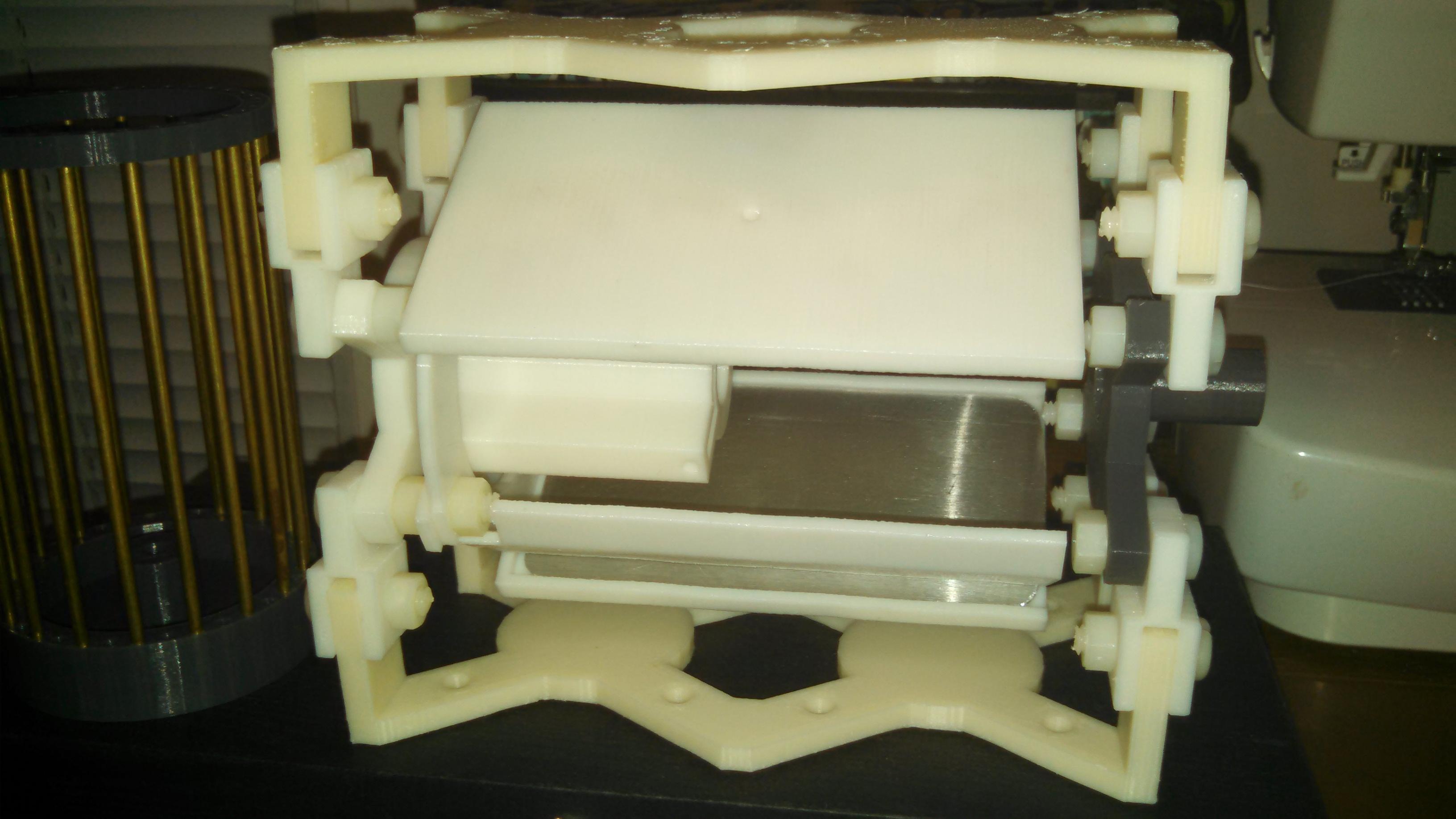

            I'm getting closer. Maybe about another week or so on the dirod. Here is an update picture. Click image for larger version

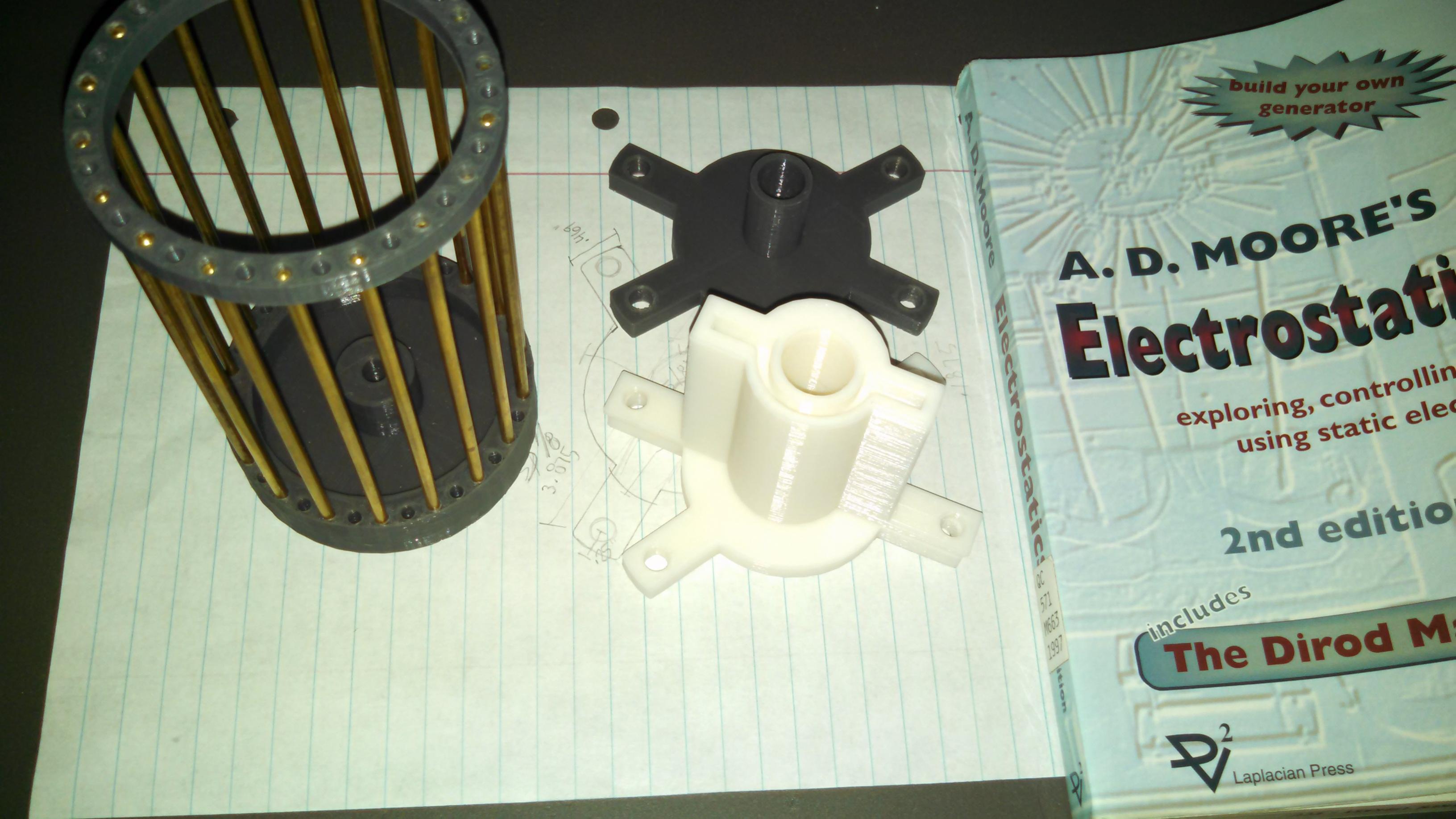

              Hey all. I am pleased to announce that the Dirod is complete. I just got done putting the final parts together. I need to do some preliminary test to ensure that it produces before I list it to Thingiverse. Meanwhile, here is a picture. Click image for larger version

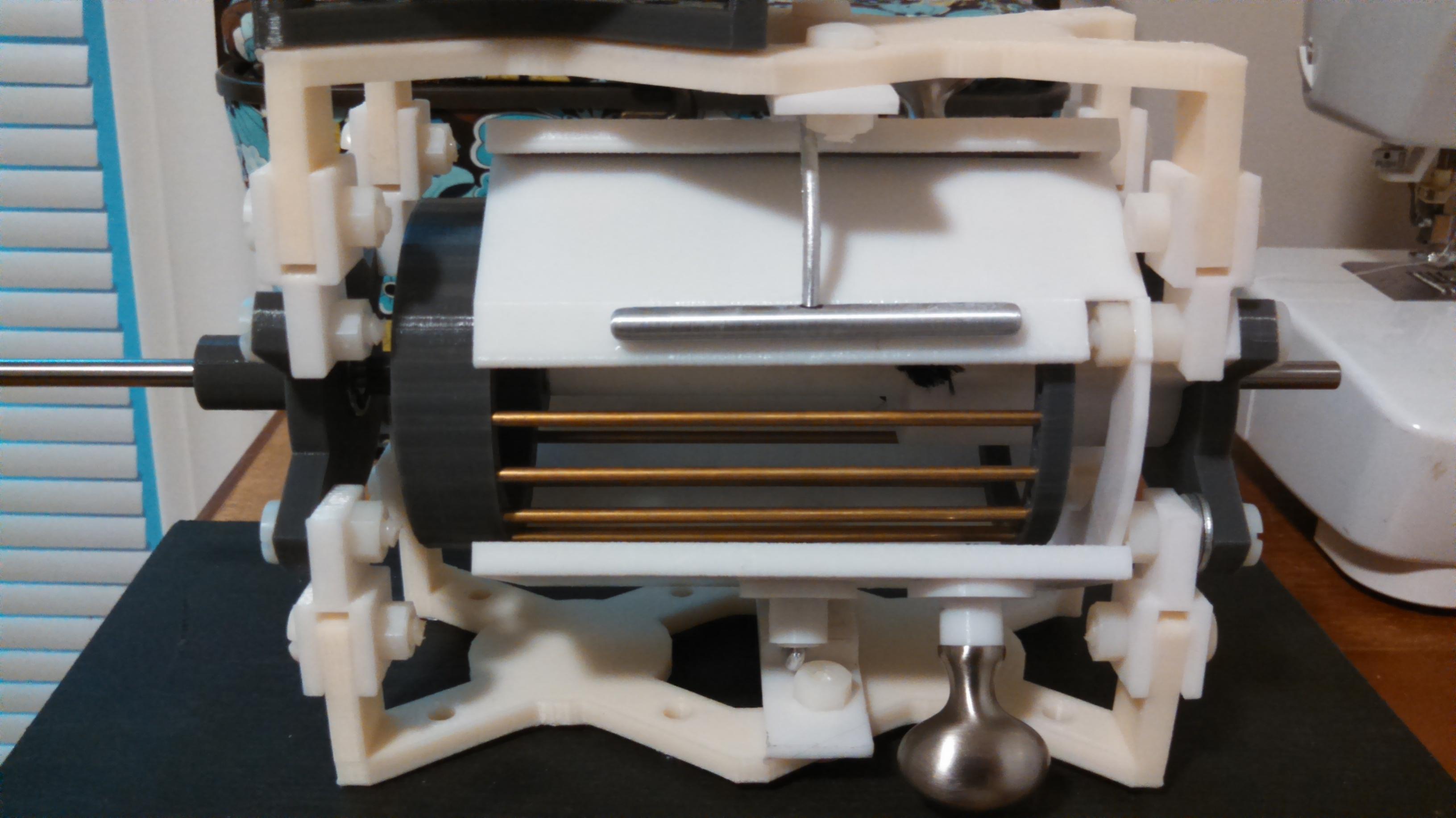

                          Here is the Bedini/Cole window motor with a Jefimenko Electrostatic Motor twist. I don't know where this is going but have fun. I have not put this one together yet but by all means have at it. Click image for larger version
