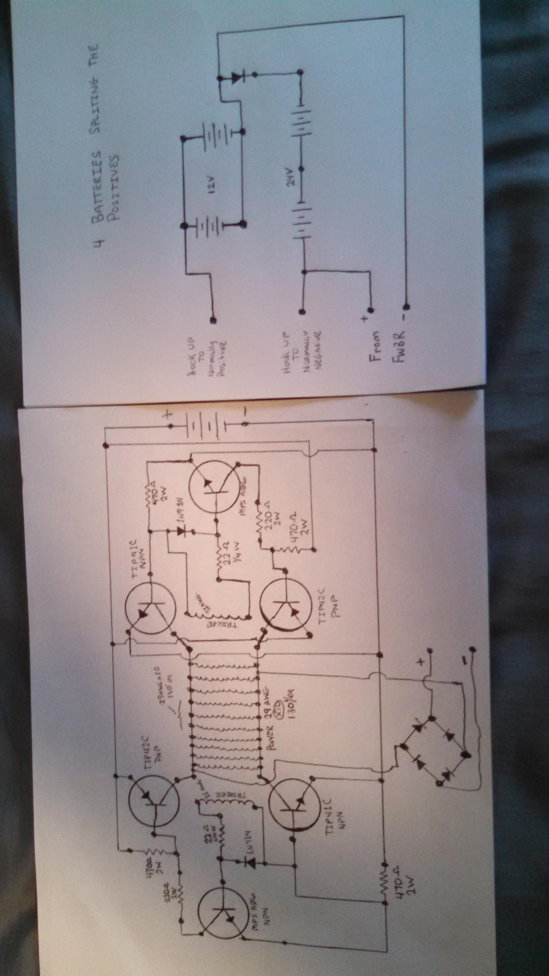

              So, I tried a four battery setup splitting the positives on the Bedini/ Cole Full Sequential Bipolar Circuit. I used four EverStart 230 CCA batteries ($20/ea). I had some interesting results on a twelve hour run. Here is the schematic. Click image for larger version
              At 10:30 PM on 08/17/2016 I began the observation period. The series batteries measured 24.8 Volts and the parallel batteries measured 12.59.
              At 10:30 AM on 08/18/2016 the observation period ended. The series batteries measured 24.5 Volts and the parallel batteries measured 12.73.
              The rpm's did increase from the beginning to the end from 4080 to 4110. The resting voltages on the batteries went from 24.9 V to 24.8 V on the series batteries and from 12.47 V to 12.55 V on the parallel batteries. The beginning voltages were taken before the run. The resting voltages were taken after a 30 minute rest period.
              There is no flywheel on this motor. The other thing to note is the 4.7k ohm resistors are replacing the 22 ohm resistors in the schematic.

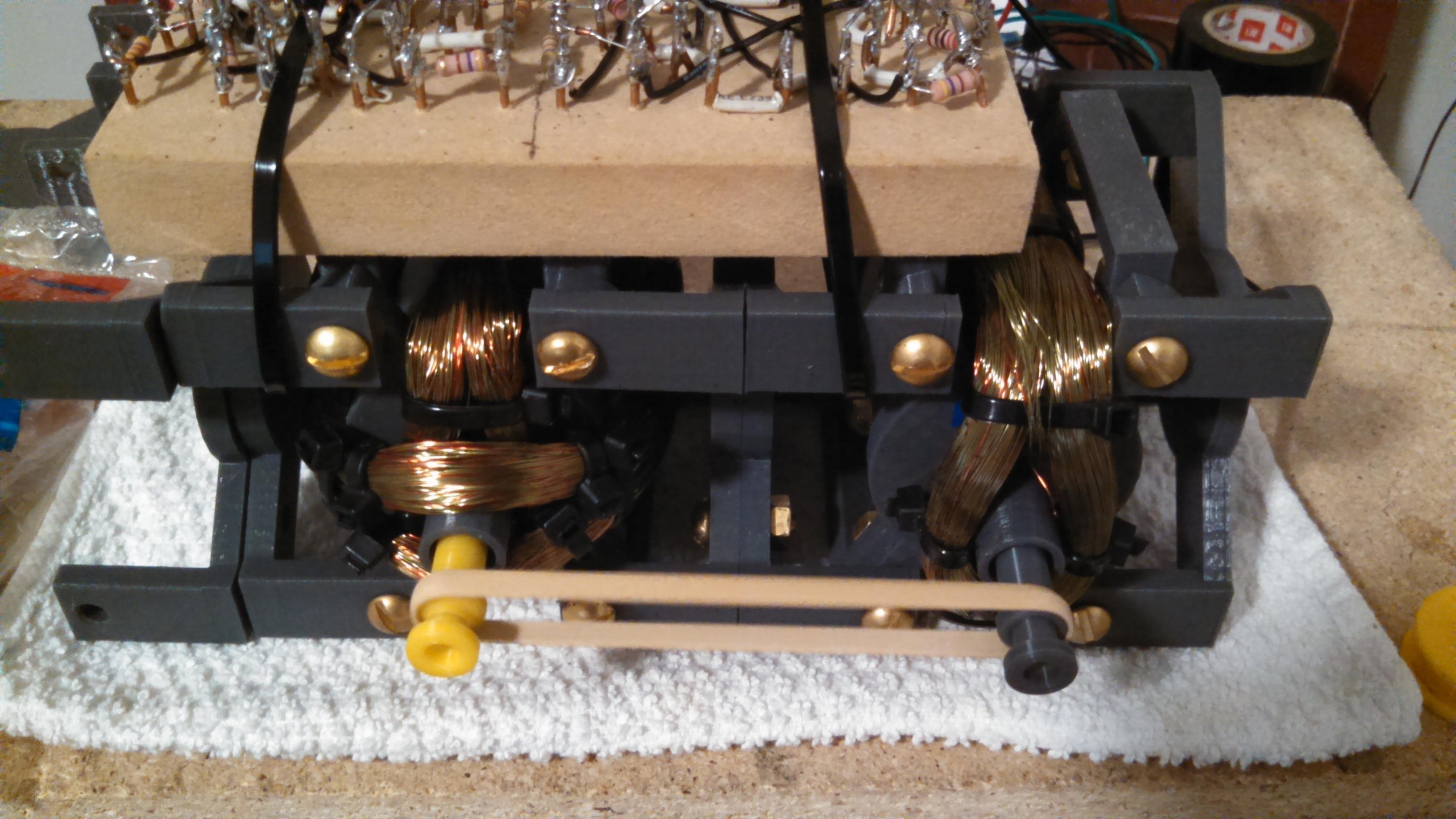

                    Hey all. I am in the process of engineering a mechanical capacitor pulse system, on a third module, to attach to these two modules. Here is a picture of the two Window motor modules attached together. Click image for larger version
                    With the rubber band pulley system on a 1 - 1 ratio the rotors spin at 3660 rpm's. At that speed each of the two Bedini Cole Full Sequential Bipolar circuits have a voltage output at the fwbr of 11.3 volts. Would it be feasible to use a Full Wave Cockcroft Walton Voltage Multiplier to get my voltages up above the battery voltages, collect in a capacitor, and pulse to the batteries?

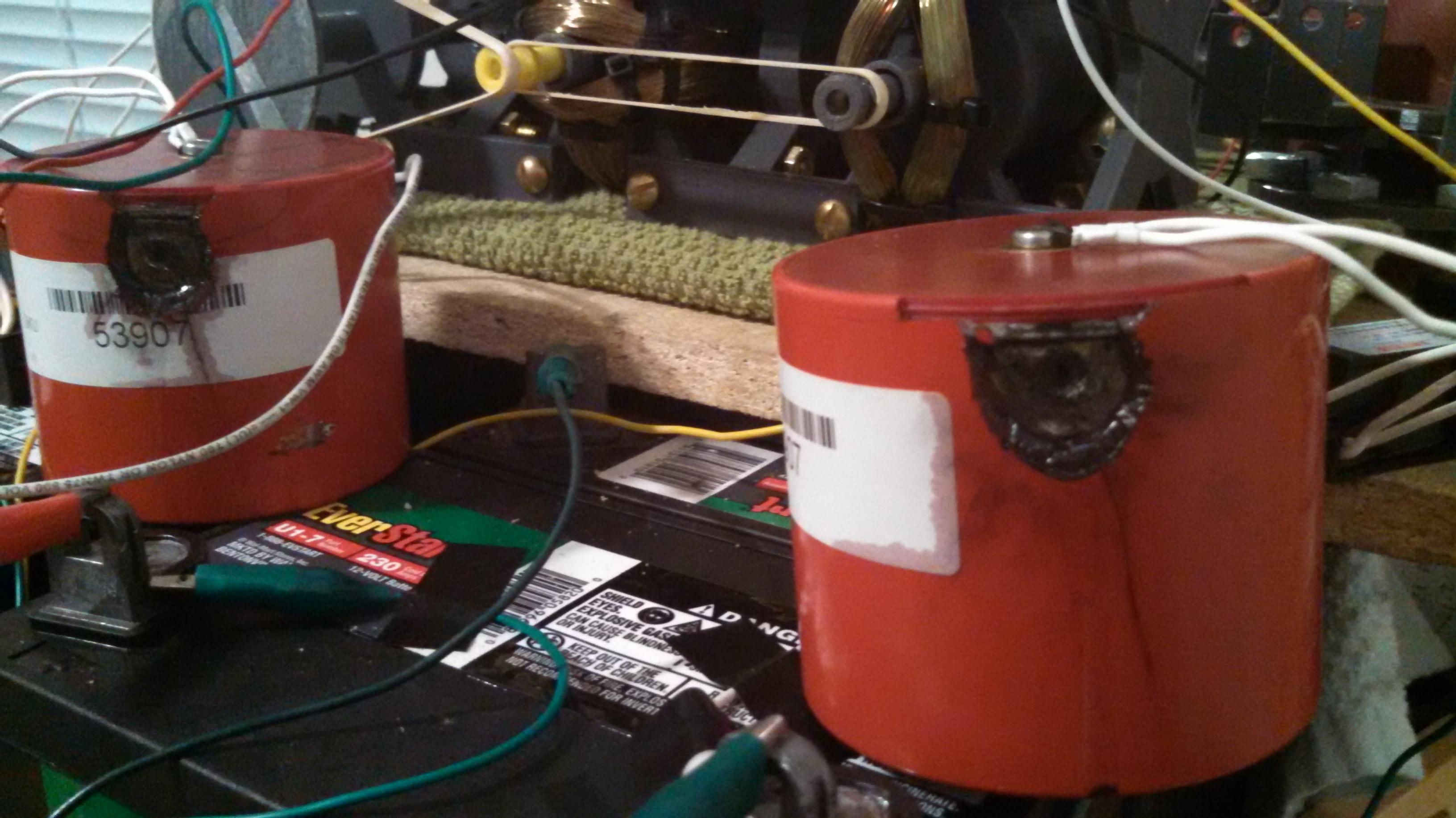

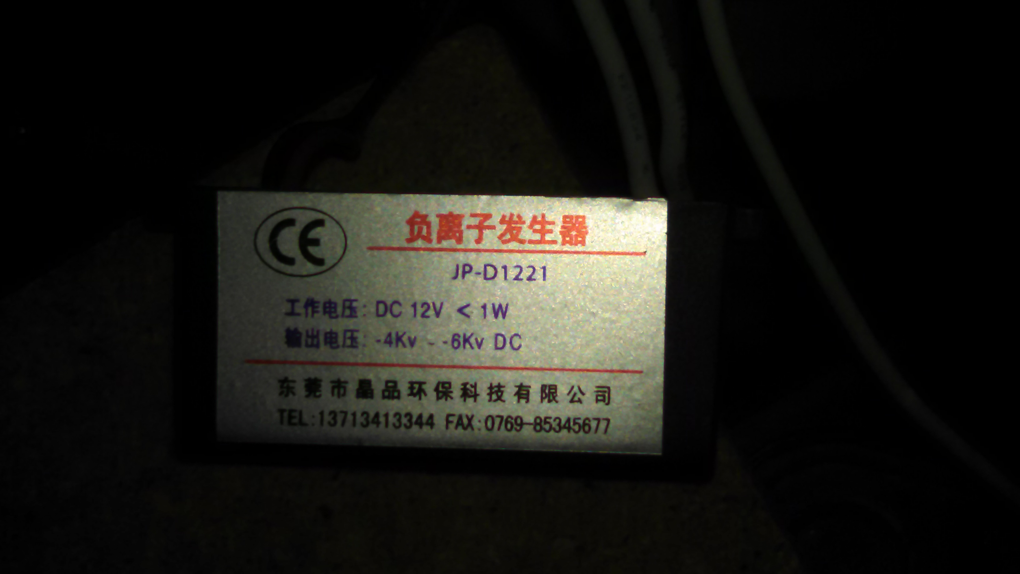

                          I got in a couple of surplus ceramic capacitors (2KV @10MF) and decided to push them with some negative ion modules that I got from china. I fed them from the fwbr's coming from the two circuits to the positive end of the run batteries on the four battery system for the Bedini Cole Full Sequential Bipolar circuits.
                          Pictures of the result: Click image for larger version

                          The negative Ionizer: Click image for larger version

                          • #28
                            Wow Doug! kablooey!
                            did it frighten the pants off you when they blew?
                            • #29
                              Wow Doug! kablooey!
                              No John K, it just hurt my feelings at $10 each. I shorted them a few times earlier just to see the spark before I looped it back to the system. They give off a strong spark at about 20 seconds with the voltage multiplier (neg ion module) feeding them. I ordered a couple more to hook up to my pulley pulse system when I get that done. They may be too large for my system. They did not blow at the same time. One took about an hour and the other was closer to two hours. I learned a couple of things during the experiment though and one was the anatomy of a doorknob capacitor.
